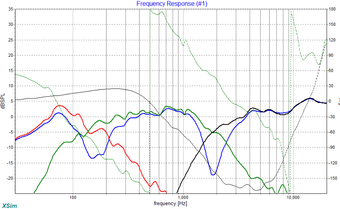

Any issues with implementing the mid/tweet phase as shown?
The phase behavior of the midrange puzzles me a bit. Otherwise: no, it seems fine to me.

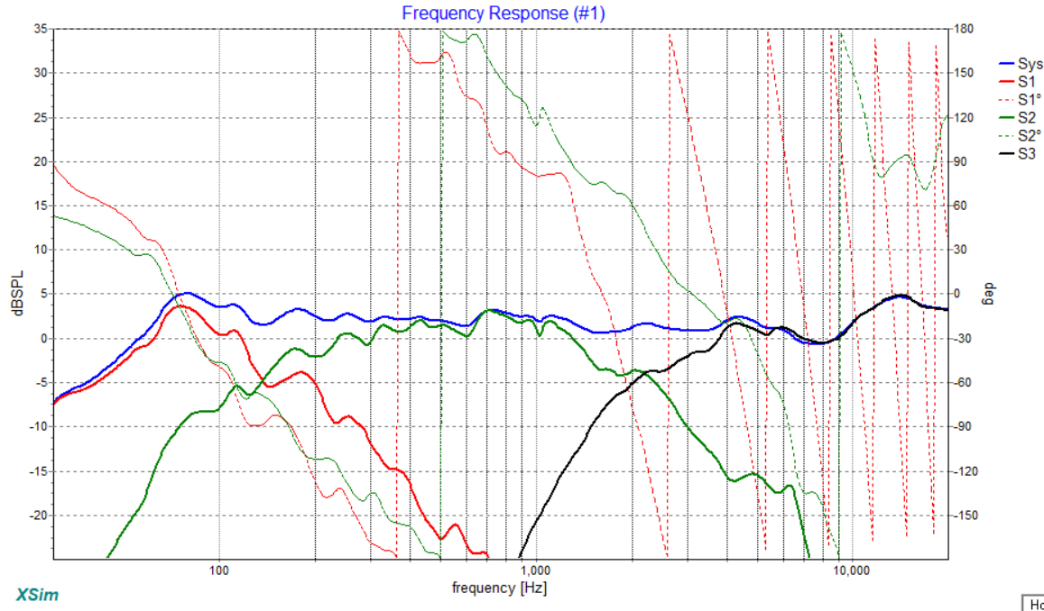

what I have is woofer flipped and mid and tweeter not flipped so woofer is neg polarity, mid and tweeter is pos polarity with sum and null shown by flipping woofer in att A and A1 with phase lines

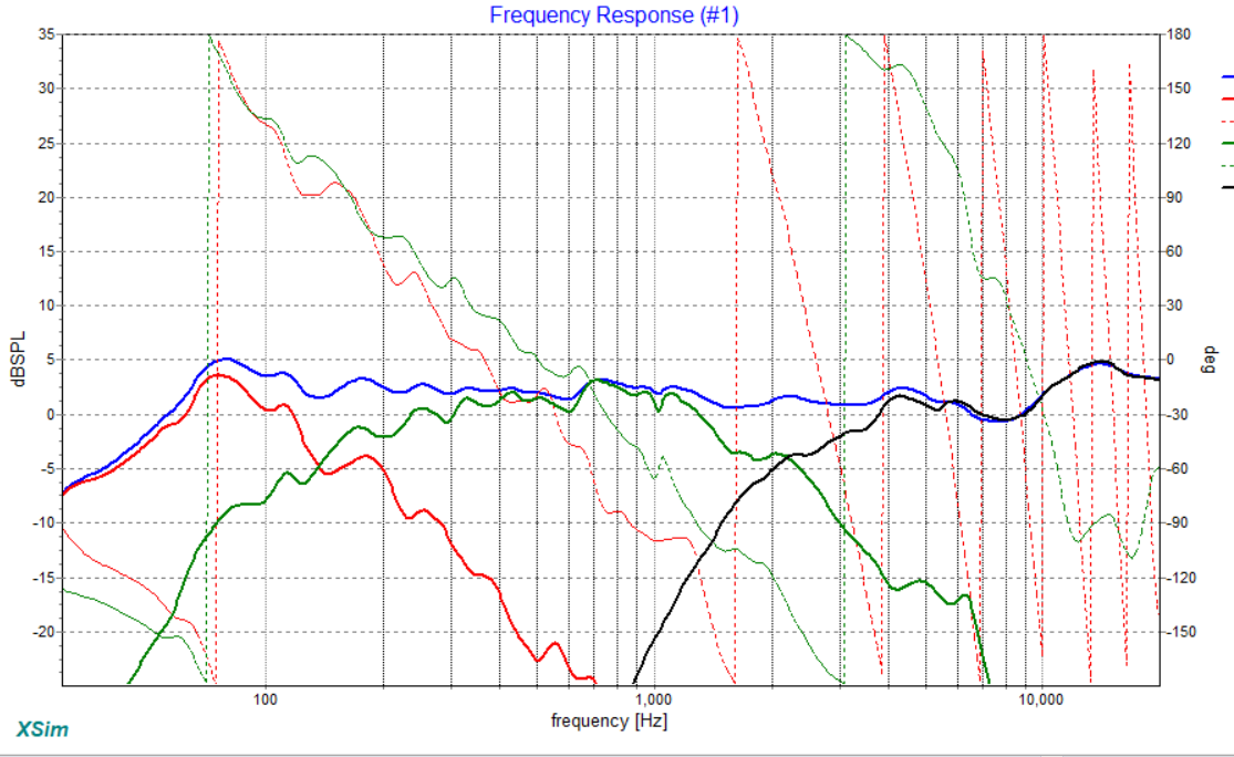

I changed it to Woofer pos polarity and both mid and tweeter to neg polarity as shown in B and B1 - this is all 3 drivers flipped.

to note: 1)The raw measurements are outdoor. The measurements match xover sims - got to love interferometry and XSim
2) I'm running the crossover in room and all checks out with sims..

Woofer needs to be normal polarity regardless. If the M and T were normal when woofer was flipped to get a flat summation, then both M and T should be reversed and the woofer normal for best results. This is perfectly fine even though it sounds funny.

I don’t have phase tracking above 3k per se, but I must have phase combining otherwise I wouldn’t have a “proper” notch with one driver flipped. Summed flat without this would produce bumps, dips and even flat through crossover region with one driver flipped.

- Good reverse null with Midrange +180 deg and Tweeter -180 deg
