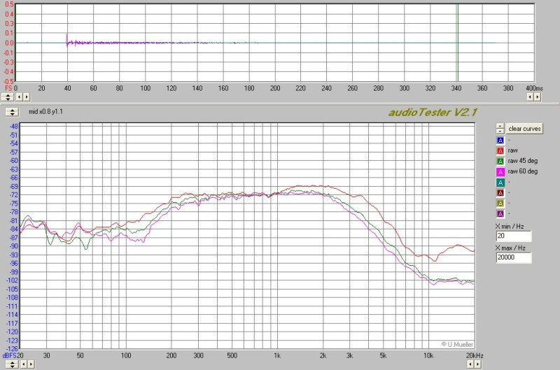

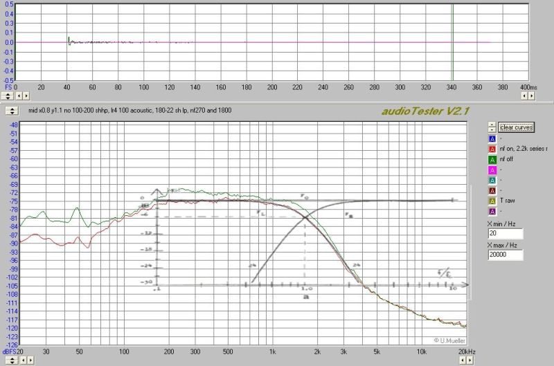

I use the 8543 in an open baffle, HP anywhere from 100 to 200 (have tried this range and not found much subjective differences, if x-o implemented well), up to 1700 Hz.
Likes: extremely clean sound, as evidenced by a simple sweep - no buzz, singsang etc, remember in Mark K's test there was virtually no high order HD. To my taste there is also plenty enough detail, definition of instruments in orchestras and their position etc. Since I do not use it in lower bass, I can't comment on that. A low HD might sound to some people as "anemic", these qualificatives are always problematic: how can bass be anemic if the FR plot is adjusted to be just like some other driver? etc. Note low Qts, if using a box and passive X-O definitely one would have to design it properly 😉 . AFAIK this driver was used in one of the Proac implementations.
Dislikes: none really, the breakup is not obviously audible (though I do use a notch filter around 1.8k to compensate for the rising response). The data sheet shows irregular off axis response >2k which was not too evident in my units. All things equal though I surely would like a flat response from 1-2k and not this resonant peak, however, 1- many other drivers have this "feature" as well, and 2- notching it out still gets me a textbook acoustic LR4 on axis. There is some off axis loss though at 1-2k, in open baffle ca. -3 dB.
Nearfield measurements attached,forget anything beyond 8", these are just room and baffle effects.
I have not bothered measuring t/s since I am using it far from resonance as a mid in a 3 way. The calculated 1st pole from data sheet should be ca. 135 Hz but appears to be at 100 Hz, that is after months of use, but then again this is mounted in a U-frame open baffle.
