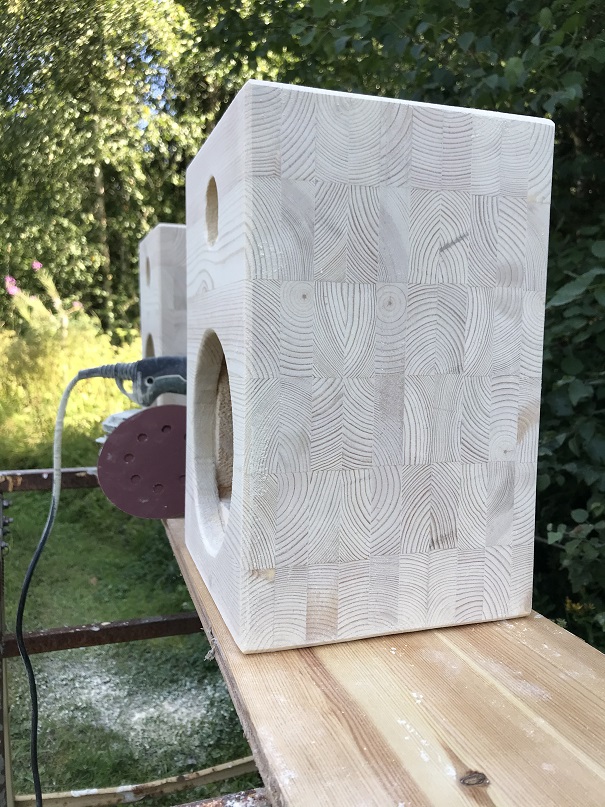

Since the arrival of Corona Ive been bored and since planning my next DIY project for summer vacation, but due to uncertain financial future I scrapped my original plans for something cheaper: a small bookshelf based on some simple car-audio kits. It was fun to assemble this simple design and now I have something for the winter fireplace (as expected it sounds horrible). All jokes aside I will probably buy better drivers as I'm very happy with the wood work and definitely learned a lot in the process as preparation for next bigger projects.
Size outer: 30*20*18 cm

That looks like a solid enclosure construction - well done for that.

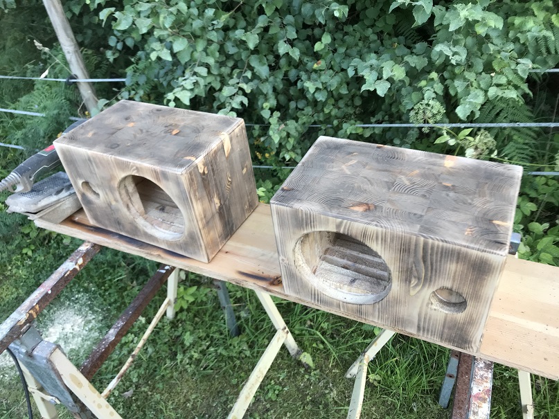

How would you describe the finish - distressed pine?

The end grain sides look interesting, the front baffle not so much. Personally, I hate the way pine stains, better to give it lots of natural light (UV) and time to let it colour to that rich orange/brown.

About pine stain I agree I have struggled to find a good looking solution but I feel this is as close as I can get with the methods I’ve tried: sanding torching sanding stain sand stain. I was hoping for more grayish look but maybe next project I’ll try oak instead and less black/brown tar oil maybe silver/gray instead.
