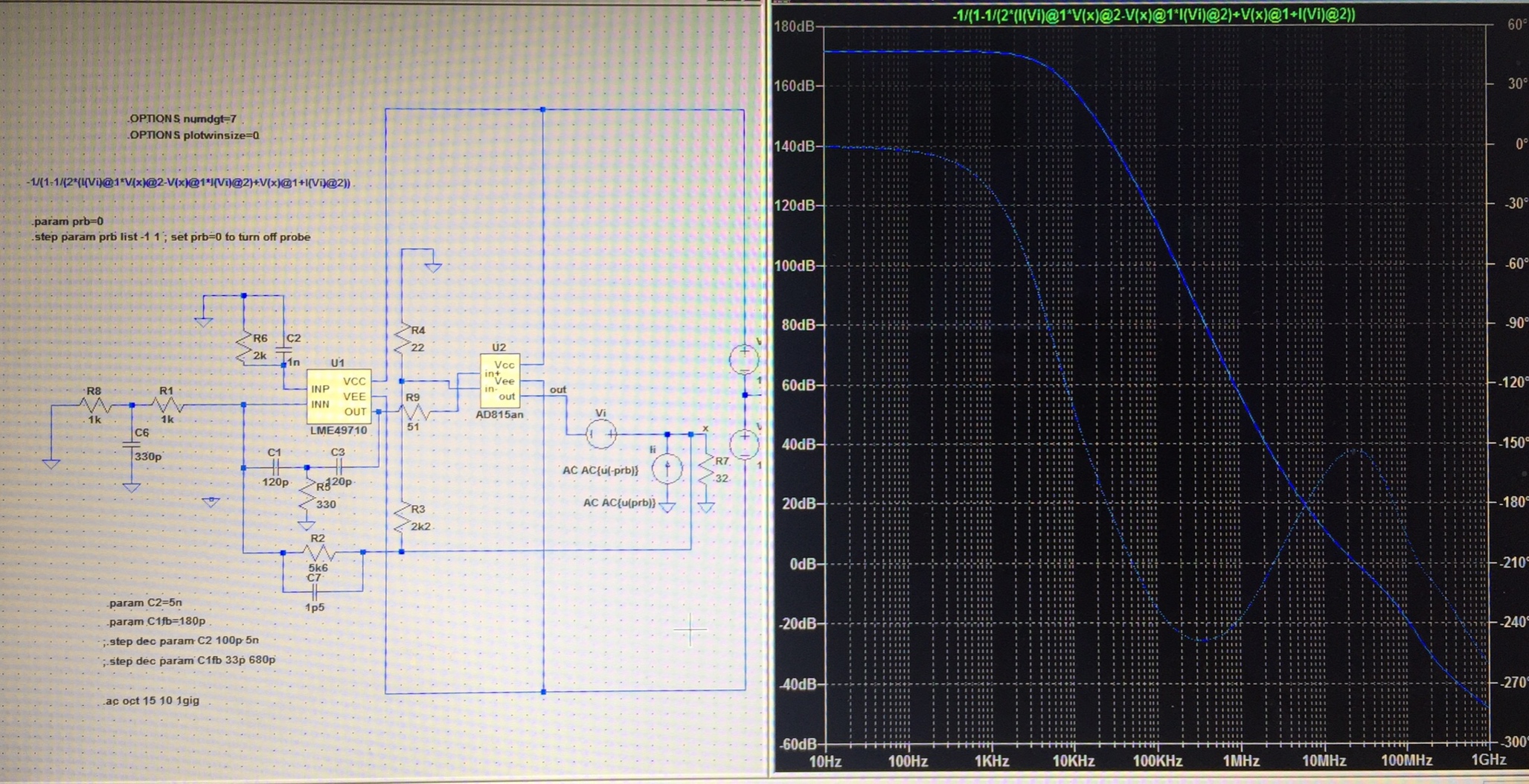

The lower current deviation in the any output stage - the lower distortion. Or you need to provide excessive OLG around OPS.
I have a project going to make a good line preamplifier.
Or just force high-GBW opamp output with simple EF having appropriate current source at the load.

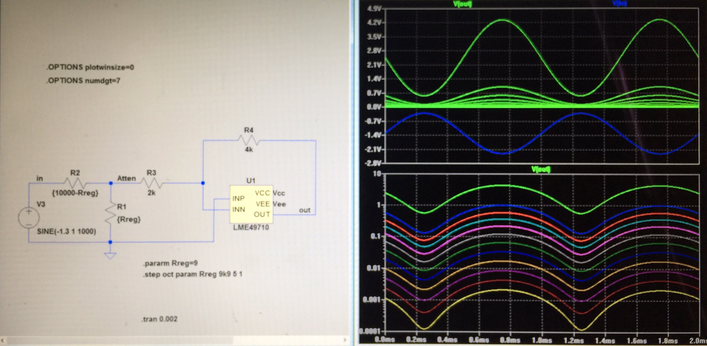

Having 2k input resistanse it’s easy to provide at least ~80 dB regulation with 10k linear potz in front of it:
