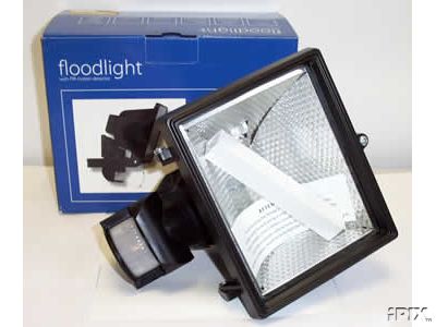

What you reckon for a 500w security light as a light source, would the reflector be good enough? Bulbs are very cheap.

well we cant know without the info now can we 😉 a picture can mean a thousand words but not in this case lol. please supply some info on it and where it could be bought and so on.
500watt
Halogen,
Took the pic from ebay but these security flooodlights are available evrywhere for very little.
I hear the light is a little yellow but is this serious or is there any way round it?

They use halogen bulbs,
can get at 240v, cost less then £10 for bulb and holder / reflector, sounding like a good deal to me.

i think this will work ...if you build it right. i have a 600 watt halogen bulb, but its an OHP bulb, maybe this 500 watt one will last longer but be a lil less bright...but what are you retrofiting? since you said "good for retrofit"

I was just thinking of retrofitting an ohp with one allowing for brighter pics and cheaper running.
halogon lamps for those flood lights last forever... we have not changed ours for about 10 years.
"I hear the light is a little yellow but is this serious or is there any way round it?" yes halogens are a bit yellow im using a halogen bulb and i dont see any problems but it would PROBABLY be better with a MH setup.

These lights can be bought very cheaply in the US. The halogen ones go for about $5 USD (not the kind pictured with the sensor on it).
The fluorescent ones run about $30 USD.
The problem with these lights has always been the degree to which they tend to scatter the light, and deliver it to the LCD as non-parallel rays. Most of the light never makes it out of your projector, but simply bounces around until it is absorbed and converted to heat.
A much better reflector could totally handle this, but there is much disagreement that a good reflector can even be possible for such a large source of light (non-point-source).
Of the "worklight" types, the fluorescent types tend to have a better color temp, and will yield much less IR and UV. They are also MUCH cooler thermally.
If it is possible to build a line-source (as opposed to a point-source) of light by using several of these lamps, you could build a VERY good reflector as a two-dimensional parabolic reclector. It would be "U" shaped, instead of bowl-shaped, but would do for a line-source the exact same thing that a three-dimensional paraboloid does for a point source.

I had need for one of these lights anyhow...so I bought one a while ago. Before I mounted it outside the house I played around with it inside my old Elmo OHP. Failure! Allmost no useable light escaped the OHP. I only tried the lamp "as supplied" by the manufacturer, but the results were less than exciting. 🙁

Now if some bright person out there could build an anti-diffuser...
Imagine some sort of material that is flat on one side, with a million tiny lenses on the other side (or prisms or whatever.
You construct the thing so that any light that hits it from any angle on one side emerges from the other side as only parallel light.
"Messy" (randomly oriented) light IN becomes controlled light OUT.
Then all of these cheap sources would become viable.
It's not impossible in theory.
