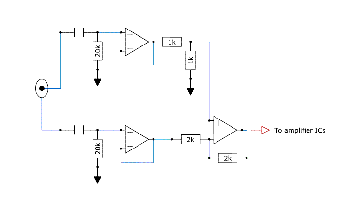

The rockford circuit uses the shields as a reference for the op-amp power supply which I would prefer to avoid.
The circuit below works. An RC network would probably be useful at the input of both buffers to shunt high frequency noise to ground. It's quiet when using good op-amps. You don't have to use anything expensive. NE5532s will work well. 1% components should be used between the buffers and the next stage of the circuit.

Thank you very much, sir.
Would you mind noting the following, please?:
1. "which I would prefer to avoid" - Why do you say that? What is preferrable?
2. I assume the ground connection shown will go the op-amp power supply source, which is in my case the output of my SMPS-correct? (I use voltage regulators of course)

1. because it passes DC current into the shields.
2. The secondary center tap of the power transformer and the ground on the schematic will be connected to chassis ground.

Thanks Perry-unfortunately that circuit did not work. I tried it after going home from work last night. Still had ground loop noise. Aye....
I know the circuit works. I've used it many times. Did you ground the sec. CT to the chassis ground?
You can test the circuit by driving the signal into both the center conductor AND to the shield. If the circuit is working properly, there will be no output from it.
Hi, yes I did reconnect the CT of the SMPS output to chassis ground, which only reintroduced more noise into it.

So using one 4.7k resistor from the rca shield at the input jack goint to the common center rail of the power supply wouldn't work? (for all channels) Sorry if its already been mentioned.

Why not just connect the shield direct to the inverting leg of the diff amp, and the signal to the non-inverting leg? i.e. ditch the two front end buffers.
I did this when I had a bad alt whine many years ago and it worked perfect.
Or does your way have better CMRR or something Perry?

Balanced inputs are not a solution to solving ground loop problems.
I know of many situations where commercial amps are used, that have balanced inputs, and they still have ground loop hum.
Balanced lines are simply designed to eliminate (reduce) common mode noise that is picked up by (usually long) cables that feed an amplifier or mixing device.
If you are experiencing hum or earth loop issues, then it's time to look at the design of your power supply, input stages, grounding, isolation and decoupling.

In mobile amplifiers, you have to provide some way to ensure that the reference for the audio is the shield of the head unit (or whatever signal source is driving the inputs of the amplifier).
The most common method (used for virtually all budget amplifiers) is to float the secondary of the power supply. This works well as long as all inputs are being driven from the same signal source.
The input circuit that Rockford uses floats the ground for the 15v regulators. This works well but can produce noise unless all signals are from the same source.
Other amps use balanced inputs (or some form of active input circuit). These work best when the inputs of the amp come from different sources (i.e. sub output from head unit directly to the amp, high end signals passed through an EQ or other signal processor before going to the amplifier). For these systems, a fully balanced input (or isolation transformers) on all channels is the most likely to be able to prevent ground loop noise. In this case, they are used to ensure that each input uses only the shield ground from the signal source as a reference. With other input circuits, the common shield grounds can cause noise from ground loops.
