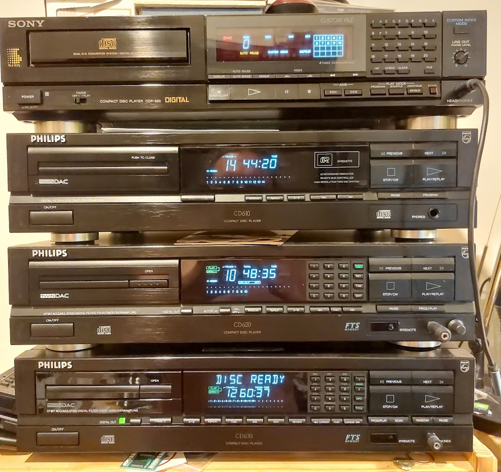

Well, especially with the older Philips players I'd be cautious, the 4 digit displays are known to fail. The series previously recommended by me imho have the best of the best of all displays ever available in CD players.
Reliable, informative and easy to read.
If TDA1543 is allowed, you can include CD600, CD604, CD610 as well.
