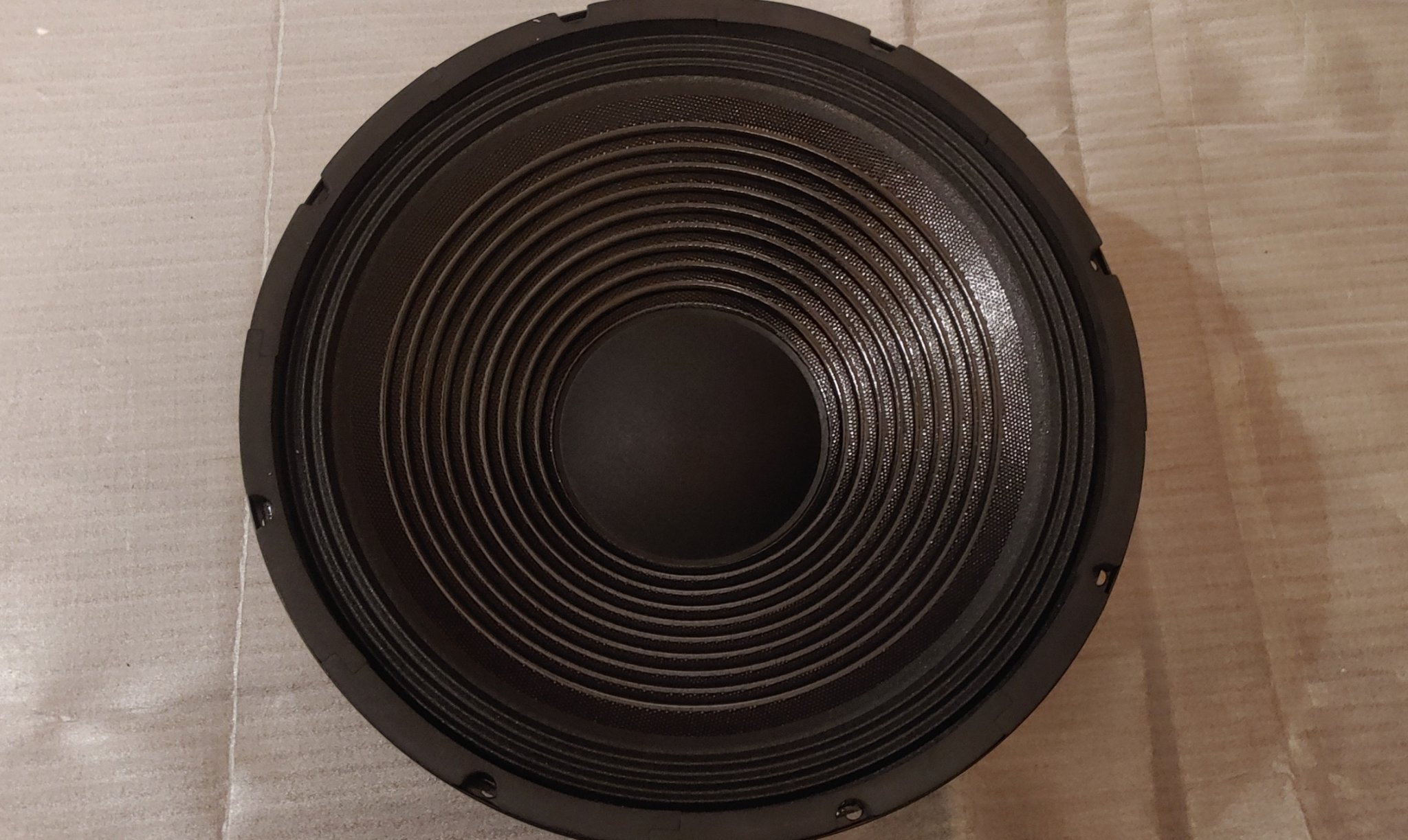

Just received a pair of Goldwood GW-1558 15" woofers and decided not to add the bass driver to the same baffle as treble/mid driver for my open baffle project.
95.6dB/ 8 Ohms, QTs 0.63, Fs 31Hz, Vas 14.12

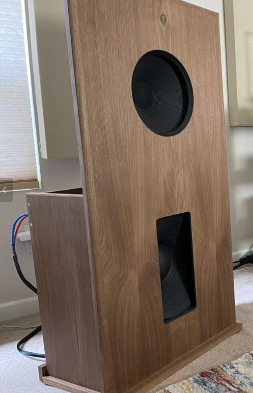

So I will likely have a separate open baffle for the Goldwood, rear-mounted, and I seem to recall slot loading with opening about 1/3 of driver area may improve the bass performance. I've seen people use rectangular slot for other woofers rear-mounted on open baffle, so I'll try that first.
Anyone ever try slot-loading Goldwood woofers with success?
