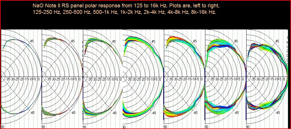

The leaders in dipole design have received very good reviews for 4-way speakers that provide a controlled polar response over a very wide frequency range, which a 2-way dipole can never deliver. Perhaps with your 2-way dipole you are hearing abrupt changes in polar response(energy vs. frequency at the listener), some cone break-up just above 1.2Khz, and substantial beaming with comb lobing above 1.8Khz (13550 in/sec) / 7.2" diameter.
A 2-way dipole often has a 1-person sweet spot width, and requires careful toe-in to aim a lobe at the listener.
