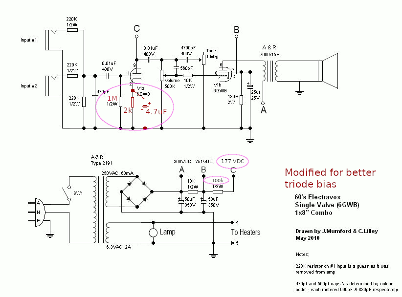

I’m just troubleshooting what I initially thought was a bad connection in my single valve (6gw8) Goldentone guitar amp ( Aussie practice amp from the 60’s). Attached is a link to a schematic (with thanks to J Mumford and C Lilly) that is pretty much identical to my amp except for one or two resistor values.
https://www.ozvalveamps.org/electravox/60s electravox single valve amp-p-jm.jpg
I think a good chance I’m dealing with a bad tube but I have swapped out another tube and both show identical symptoms. Before I go searching for another 6gw8 I was wondering if it could be a different problem eg.bias /voltage/ ac ripple?
Symptoms as follows….
Initially signal faded and disappeared after a certain amount of playing but was an intermittent thing..
Was able to bring it back temporarily and intermittently by addressing contact/ solder at tube pins but now the output is consistently weak have tensioned socket etc to no avail.
The triode stage appears to be amplifying as it should and a good signal goes in to the grid post volume and tone pot at the pentode stage but comes out weak and distorted at the anode (which makes me think either something wrong internally with the tube or some issue with voltage /current/ bias?)
Attached are some photos on my old oscilloscope showing a 440hz sine wave coming in and at the final stage before it hits the output transformer.
I took some voltage measurements at key points in reference to the schematic as well….
Voltage at triode plate (C) is 147vdc (schematic indicates 82vdc ) stock resistor from point B to C on my amp is 100k (not the recommended 220k)
Screen Voltage at Point (B ) is 260vdc (recommended is 250vdc)
Plate voltage at pentode (A) is 320vdc (as opposed to recommended 309vdc )
Heater voltage is 7.02 v ac (measured from pin 4 to 5) recommended is 6.2 vac

...single valve (6gw8) Goldentone guitar amp...
Nifty! I've never seen a production single-valve guitar amp before. I'm assuming gain was fairly marginal when new? Clean tones only, no overdrive?
Anyway - the thing that stands out to me like a searchlight beacon is the way the input stage (triode) is biased. That enormous 10 Meg grid resistor, and no cathode resistor at all - that is grid leak biasing. It is ancient, unreliable, trouble-prone, unstable as the valve ages, and, most likely, causing the problems you've been experiencing.
I would say your instincts were very good!
The fix is pretty easy. A few small changes will get rid of the troublesome grid-leak biasing, and replace it with self-biasing, which is the bee's knees for simple triode gain stages.

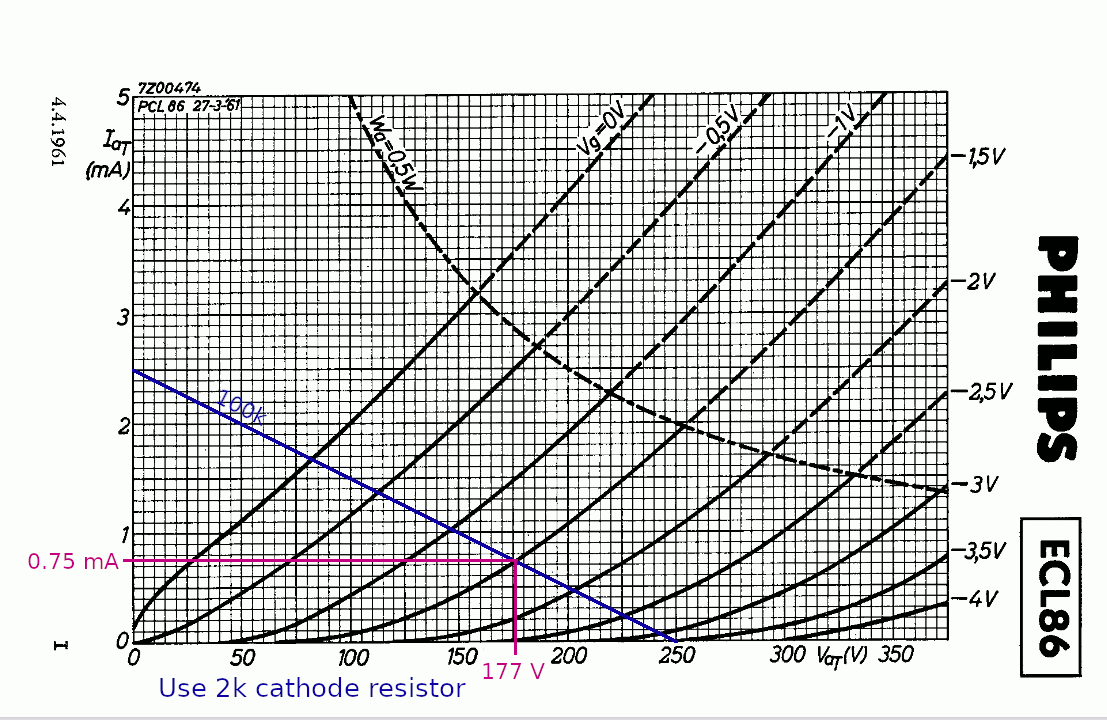

I've done the necessary math for you (pretty loadline and operating point picture attached), and all you have to do is make a couple of little changes:
1) Remove the 10 Meg resistor and replace it with a 1 Meg resistor.
2) Insert a 2k resistor (1/4W will do, or 1/2 W is fine too) between the triode cathode and ground, i.e., pin 2 and ground of the 6GW8.
3) Wire an electrolytic capacitor in the range of 4.7 uF - 10 uF across the 2k cathode resistor.
The capacitor is polarized, make sure the (+) side goes to the cathode, and the (-) side to ground.
This type of cap also has a maximum voltage rating. In the circuit shown, the cap will only have about 1.5 volts DC across it. You can use any 4.7uF - 10 uF cap that has a voltage rating of more than 3 volts. If you want a specific number, use a 25V cap.
That's it. Done. Your triode will now bias up stably. The anode should settle somewhere in the vicinity of 180 volts DC, but the exact value isn't too important as long as its reasonably close to 180 V.
I also edited the schematic you posted to reflect the changes I suggested, as well as the 100k triode anode resistor you have.
-Gnobuddy

I'd like to make a couple more comments on the schematic itself. Things you might want to consider changing, unless your goal is to keep the amp in original condition.
1) The network of 220k resistors at the input throws away half the available voltage gain, for no good reason that I can see. (Perhaps to keep the amp from overdriving, which might have been thought to be rude and unacceptable when it was new?)
At any rate, snipping out the 220k resistor across that 470 pF cap would give you another 6 dB of gain.
2) The remaining two 220k resistors could be replaced with 12k resistors, or just parallel one 12k with each of the existing 220k resistors, leaving the 220k resistors in situ. This will reduce hiss a bit, though hiss might not be an issue in such a low-gain amplifier.
3) If you convert the triode to self-bias as suggested in my previous post, you no longer need that 0.01uF/400V cap at the input (grid of V1a). It can be removed and replaced with a wire. (But it won't hurt anything to leave it in place.)
4) When changing to self-bias, the value of the cathode resistor sets the quiescent bias voltage, and changing the resistor will cause slight changes in timbre and available headroom.
The 2k cathode resistor value I suggested will centre-bias the triode and give you the most headroom. Most of Leo Fender's vintage amps used centre-biasing in the preamp valves.
But if you like to experiment, you can tinker with the value of that resistor. Anything between about 1k and 4k should still result in a usable amplifier, with accompanying changes in headroom and timbre. The 4.7uF - 10 uF cap can remain unchanged for these experiments.
-Gnobuddy

I'd urge some caution before hacking away at the circuitry due to unwarranted fears or forum suggestions who don't appreciate what is a very sought after amp - for what it is - and would be a lot less sought after for what it may not be soon.
The amp obviously works, and will work, once it is sorted out.
The A&R2191 may have 230 and 240V primary taps - the catalogue is a little ambiguous on that. If the heater voltage at the socket pins is 7.02V and you are using a reasonable true-rms meter, then that voltage is a little high and should be looked in to first.
All the resistor values should be checked for any drift outside of tolerance. The coupling caps should be check for leakage. The diode bridge should be checked for leakage. Imho, sort its base performance out first. Pots should be checked for wiper noise, and the vol cleaned as it could cause bias problems. That may mean finding a friend or a service tech.
Certainly a ‘collectable’ vintage amplifier should not be messed with if resale value is a concern.
Making changes to ensure that the amp functions correctly is the first step.
Minor ‘reversible’ changes may be of value.

If the transformer primary is shorted (or partially shorted), you won't get much voltage (if any) across it when you do the above test. A shorted primary could also explain another odd bit of data you posted: pentode anode voltage was quite a bit higher than specified.
If the transformer does check out, then we need to look for other causes of the high pentode voltage. One possibility is that pentode anode current is essentially zero, therefore no DC voltage drop across the output transformer primary. The easy way to check if this is the case, is to measure the DC voltage across the pentode cathode resistor (the 180 ohm, 2W one). I don't know the exact value it should be in your amp, but I would guess in the range of 5 - 10 volts. If you measure much less than this, further investigation of this stage is warranted.
On the heater resistor(s), in practical terms you only need one. But for the slightly OCD prone, that little resistor will very slightly unbalance the AC voltage to the heaters (which will probably have no audible consequences whatsoever). However, you can, if you like, split the resistance value in half, and put one of the new half-value resistors in series with each heater lead (one for pin 4, one for pin 5).
Since there is no way to calculate the exact value of resistor needed, I suggest you do your initial experiments with a single resistor, find the proper value to drop heater voltage to 6.3V, and only then buy two half-value resistors if you want to do the fully symmetrical heater wiring mod.
