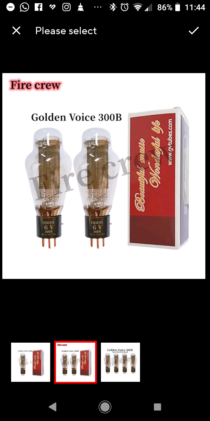

Someone know something about quality & sound?
The price is very tempting.
Just found this amazing item on AliExpress. Check it out! 91,19€ | Fire Crew Golden Voice 300B Vacuum Tube Replaces 300BL 300B-T 300BS 300B-Z HIFI Audio Valve Tube Amplifier Kit DIY Matched Quad https://a.aliexpress.com/_Ex2n1AJ
I have no experience with the GV 300B but the construction looks very similar to the GV 2A3C.
This happened 3 times with the GV2A3C I ordered from AliExpress! The tube would work for a week and then fail in the same exact fashion.
Finally the AliExpress seller gave up and sent me a pair of PsVane 2A3Cs. That pair has been fine for the past 3 months.
FWIW, I've been using the PsVane and Linlai 300Bs for over three years with no problems.

I haven't seen a 300B with guide pins on the base in years. They look like old Sovteks rebranded. I would stay away. If they're Sovteks, they were prone to filament failure. Also, don't buy 300Bs from eBay are any mass market site like Alibaba. I purchased two pairs of Psvane Hi-Fi from China on eBay. Two of them arrived broken, one loose from the base, the other with a dead filament. It was a nuisance to return them, though I did actually get most of my money back. I also had very bad luck buying EH Gold Grids from eBay a few years ago. Three out of four died after a couple of months.

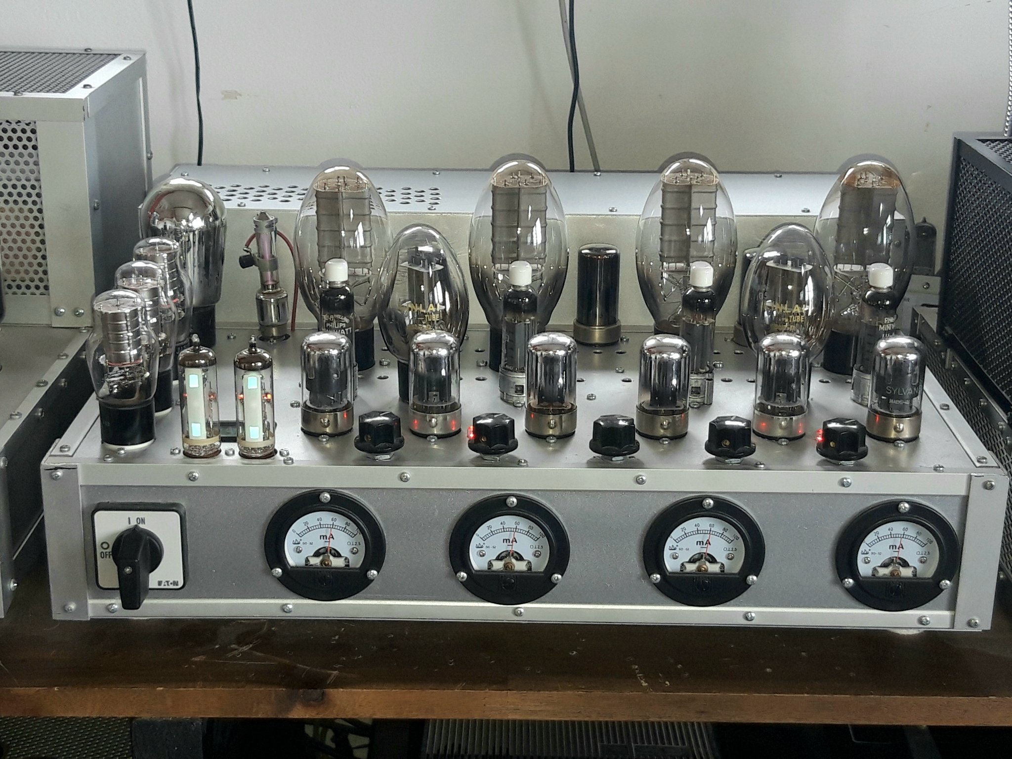

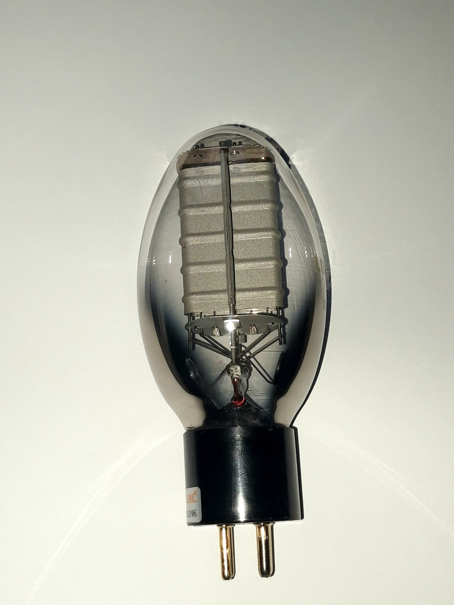

I have some quite good experience with the Linlai 300B versions with titanium coated plates. After they had become available in Europe I built an amp where I wanted to see how much I could push them - just as Titanium is quite an effective high temperature getter in high vacuum - which should result in increased vacuum (better stability and longevity), just when applied to the hot anode surfaces. Linlai named them 7300B-D. I also like their egg-shaped bulbs. 🙂
So I built this amp as a class AB2 layout to be able to push the 300Bs up to the grid current region at peak power - also, I ran them very hot for the first 1000 hours (470V @ 80mA), then I stepped down to 60 mA. In the meantime, the amp has run for about 1500 hrs (each of my amps has an hour counter, so I can tell quite exactly).
Just recently I had to exchange one tube - the rightmost tube, which showed quite early already an intense brown deposit (contaminations) on the glass bulb - emission was decreasing, maybe due to some emissive layer intoxication by too much contamination? But 1500 hrs at full plate load already is not that bad, I think. The other three tubes continue to run perfectly fine, I don't remember having to re-adjust bias currents, so they are very stable. All supply voltages (plate, too...) are stabilised (glowtubes + Mosfet regulation). So the next mark is 2000 hours.....
The amp is an all-triode-design. 14S4 input stage, 14F7 LTP phase splitter, Linlai 6SN7-D voltage and UL44 current driver, galvanically feeding the 7300B grids from the UL44 cathodes. The Loktal tubes are system equivalents to 1/2 12SN7 and 12SL7. Sound is extremely smooth, I like it a lot. So far I didn't try any other 300B versions.
I bought the Linlai 7300B-D tubes from BTB elektronik: https://btb-elektronik.de/en/produc...series-linlai-ti-anode--factory-matched-pair/
the 6SN7-D (also Ti coated plates) from Aliexpress. I've documented the construction a bit on my Insta blog @tubeampuli.
