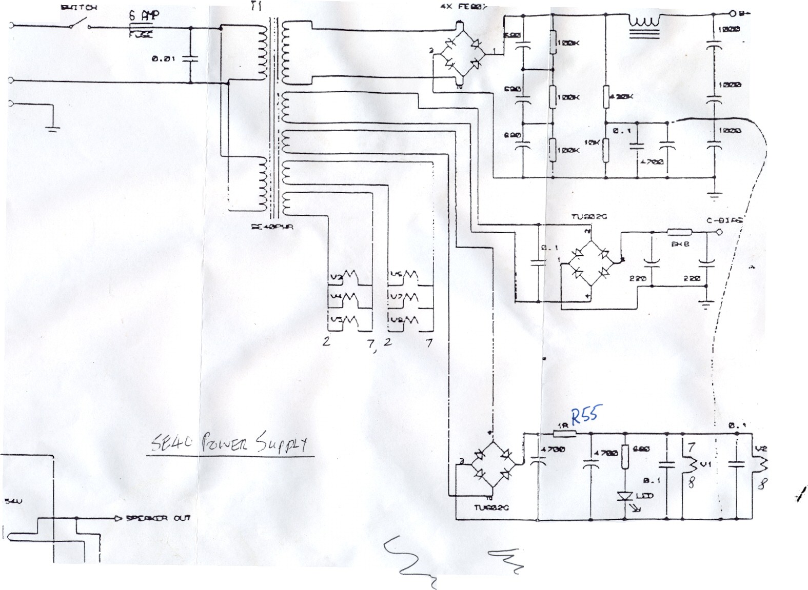

The GTA-40 has an AC supply for V2,3,4, another AC supply for V5,7,8, and a DC supply for V1,2.
Then the DC supply is bad, maybe an open resistor or diode.
I have both regular and special editions of the SE-40 including one Rev4 version. In the attached schematic R55 is used to drop the voltage after rectification. It gets hot enough to burn you.
The Rev3 versions that I have were designed for 110-115 volt line level. The filament voltage on the SN7s is above 7 volts. I replaced that resistor with a 10 watt one of slightly higher resistance to reduce the filament voltage to something closer to 6.3 volts.
The Rev4 vesion (their last) was designed for line level closer to 120 volts and all the filament voltages are within tolerances.
If the LED is not lit I would check R55 and the resistor in series with the LED.

Thanks for the power supply schematic Steve. It looks like R55 is one Ohm. Did you consider bypassing the rectifiers and running the filaments for V1, V2 off 6.3VAC?

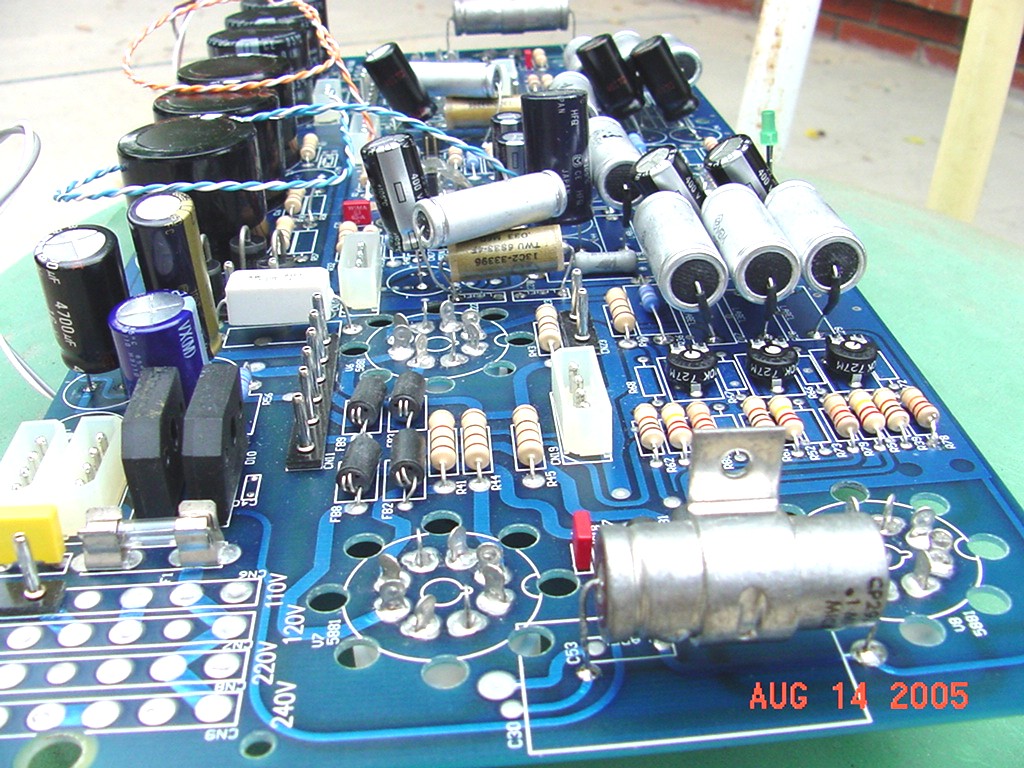

In the image the green power indicator LED is on the right. The dropping resistor is the 5 watt cement resistor on the left. And the bridge rectifier is in the foreground in front of the resistor.
It would be simple to replace the resistor with an LM317 and a couple resistors on a small proto board and grab ground from readily accessible locations on the system board.
This is why I would do the LM317 mod as opposed to anything else.
Steve

So I converted the SE-40's 6SN7 to AC filament supply... and it works fine. I was surprised to find that the transformer tap was 8.6VAC (no load) not 6.3VAC or thereabouts. I had a 10W, 2 Ohm resistor that I put in series with pins 7 and 8 of the 6SN7 which yielded 5.8VAC with the tubes in place. The 2 Ohm runs fairly warm--about 170F.
The PCB seems okay. The pair of 4700uF caps on either side of R55 measured okay, they are out of the circuit. R55 measured okay at about 1.7 Ohms. To my thinking that leaves the bridge rectifier as the prime suspect. I don't think is undersized, and I don't recall having one fail previously.
I intend to debug the DC filament supply since it is not regulated.
