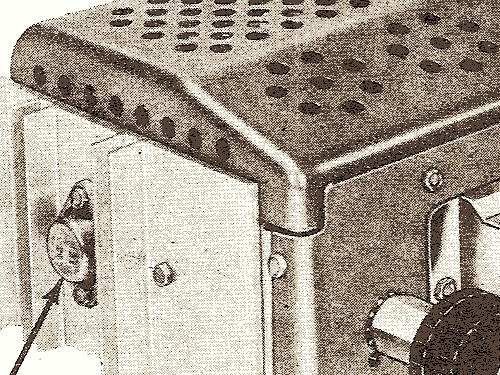

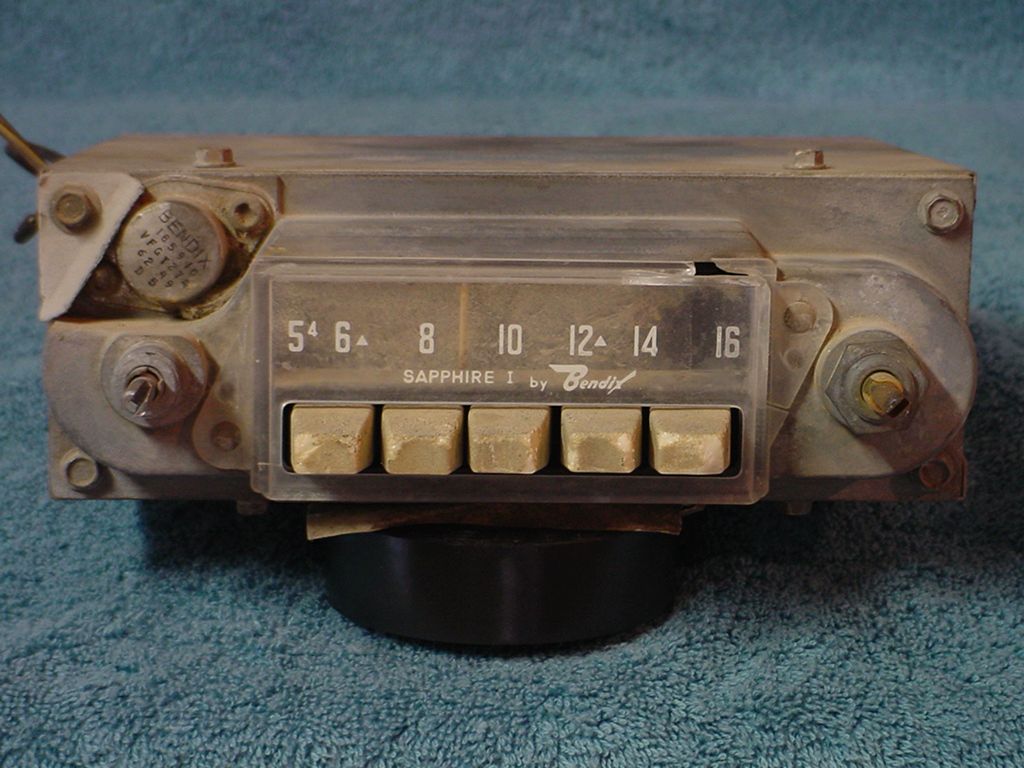

Bendix Single Ended Audio Power Stage
Bendix uses for the power amp stage in their car receivers even by the first "full transistorized" versions still no push-pull Class_B - go to post #35 about
http://www.diyaudio.com/forums/parts/167680-vintage-transistors-4.html#post2204039

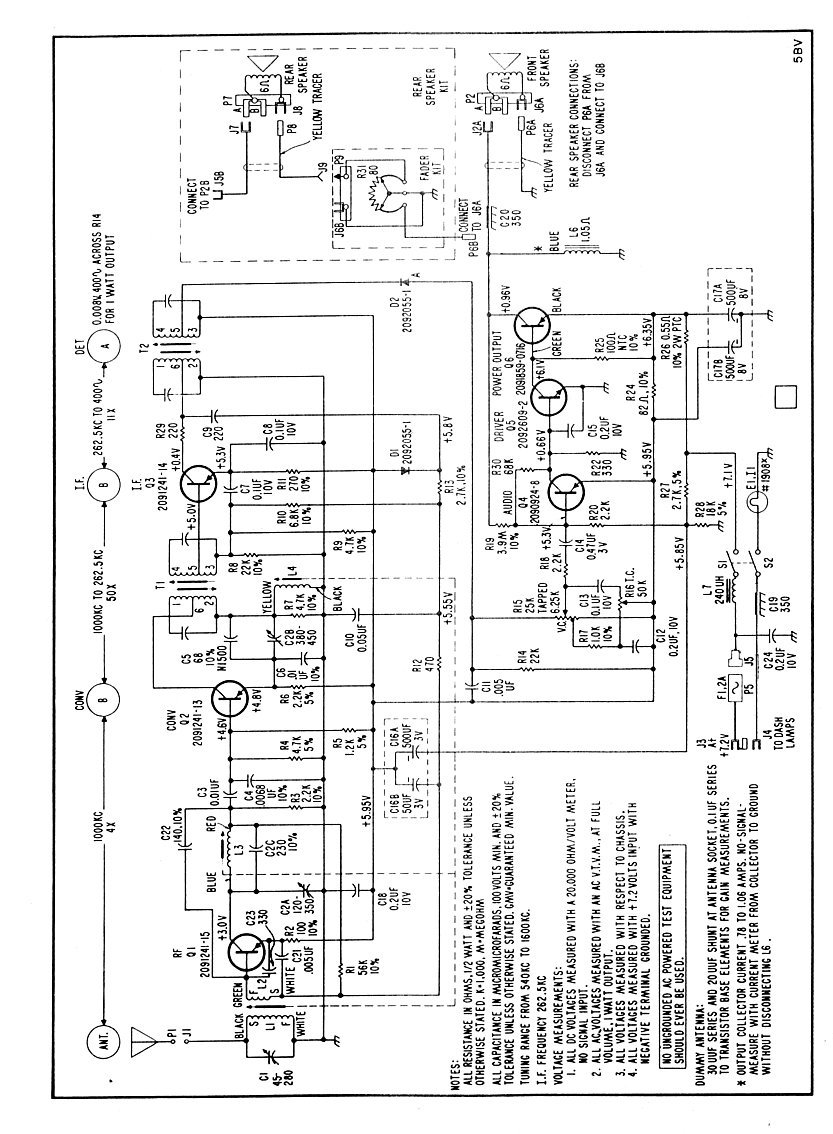

You will find in the attached schematic an aditional interesting thing: OTL, but parallel to the speaker output (and instead a boucherot/zobel network) an inductor (transformer outline). The same seems to be by the car radio from the third attached picture
What could be the reason therefore?

Ok, well that choke shunts the power transistor collector current to ground to complete the circuit. You don't want a lot of dc current through a speaker coil since that will move the cone up or down such that audio peaks will bottom out the cone. The choke is likely around 100mh in inductance. The text is fuzzy, but it looks like the choke has 1.065 ohms DC resistance. The speaker says (again fuzzy) 6 ohms. I know that speakers like this often have the coil DC resistance about the same as the nominal impedance. So if the collector current was 1/2 ampere ( a guess for a class A 12v audio power amplifier), the speaker might only see 1/6th of that, or about 80 ma.
A better approach that minimizes speaker current even more, and offers a better impedance match is to use the choke with a tap as shown below:

thank you for this explantation. By reading this I note, that there is no serial high pass capacitor in use for DC blocking - that I have overlooked completly. Without such capacitor and loudspeakers, which can tolerate a certain amount of DC components, the aim of the coil I understand.
