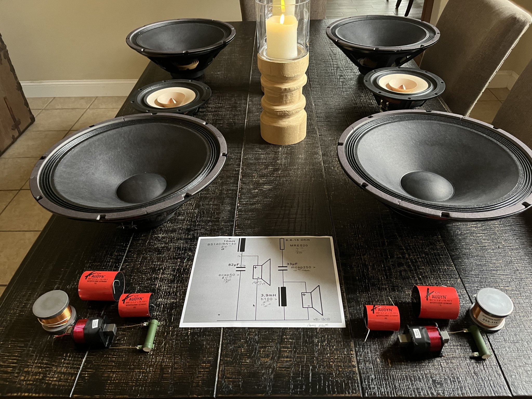

Thanks for the reply and info.
I checked out quarter wave and it is very interesting in deed. Above my pay grade as far as understanding the technicalities, but it in deed makes sense and gets me excited.
I just came across this post:
https://www.diyaudio.com/community/threads/upgraded-eminence-alpha15a-15-woofers.276225/
And, it looks like the Eminence Alpha-15A can indeed be swapped for the PAP OB-A15Neo with no crossover modifications, according to the post.
I am now taking a closer look at the crossover schematics I found and seeing if it all makes sense.
Could anybody take a look at these schematics and let me know if it looks like it would work with the Tang Band W8-1808 and Eminence Alpha-15A?
https://hosting.photobucket.com/alb...s over 100MF-100uF 33MF-33uF_zpswaualkg3.jpg
The photos look like Mundorf caps and resistors. With maybe Solen inductors.
https://www.diyaudio.com/community/...t-open-baffle-kits.300710/page-2#post-4958928
I know I am going to have some questions regarding the crossover assembly, but just want to determine if I am off on the right path.

For anyone who is following this.
I have stumbled upon a series of You Tube videos that document the construction of some Trio Clones using the Tang Band W8-1808 and Eminence Alpha-15A (my correction they are using the Betas).
I have compared the crossover build from the videos (first seen in PART 2 around the 26:27 time mark) to the crossover schematics that I have found (linked in post #1), and they appear to be identical.

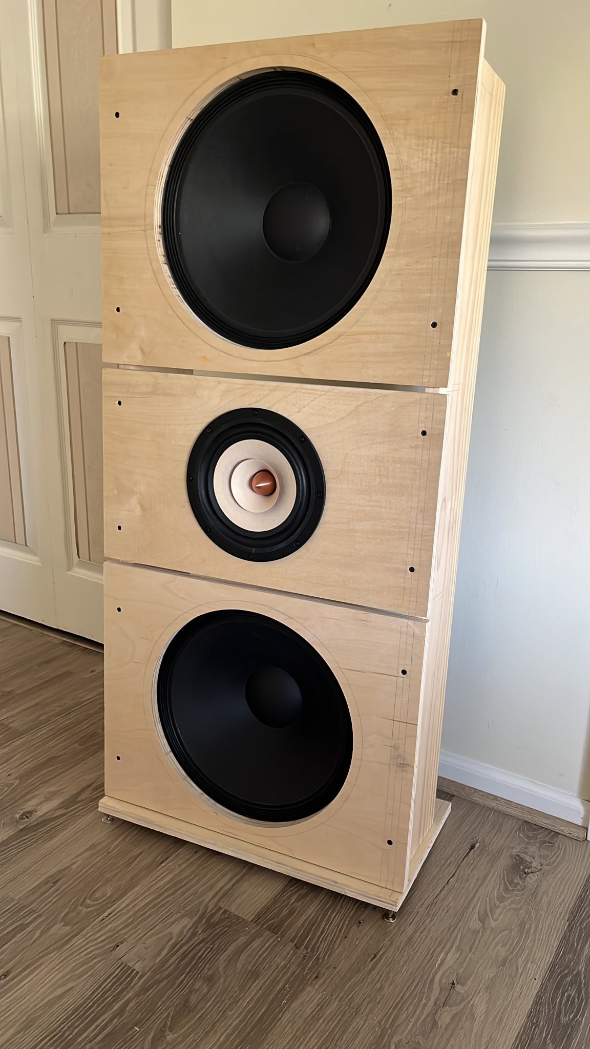

I built my set of PAP clones using TB W1808 and Eminence Alpha 15A. They do sound fabulous but I need to look for another amplifier as these are 4 ohm load. I have the SissySIT R3, Aleph J but seems like I may need good high current amplifiers. I use a FE22 preamp without any input/output caps.
I followed my build from here - https://www.superbestaudiofriends.org/index.php?threads/pap-trio-15-and-diy-discussion.6197/I have all the same drivers and all the crossover parts based on a schematic I found on this site. I'm curious if you built the same crossover -- would you mind sharing the crossover schematic that you used? The plan is to build the baffles / stands next weekend. Thanks in advance!
Crossover as L1 = 4.7mH, R1 = 0.1/20w and C1 82Mf caps with no exotic stuff just parts express. Later will go with Mundorf per the thread. But this is a great start I would say nothing missing with PE parts. You will love these PAP and do let me know what amplification you are going to run as these are 4 ohm load. Just shoot me a PM if you need any more details.
