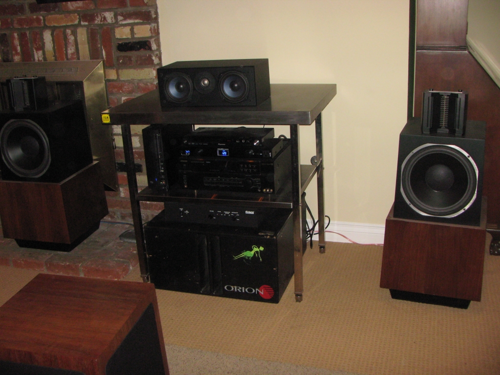

Here are my current 3 front speaker config (AMT 1-D)
(I have raised up the AMT's and evened them since this photo)

Goal: Create a center channel speaker that compliments/matches my ESS AMT-1D main speakers (post 2 details)
From my best understanding, this means matching the higher end characteristics of these ESS speakers, therefore I need to make a center channel around the GREAT HEIL / AMT (Tweeter)
From the ESS site:"The AMT ... range of 500 to 20,000 Hz. ...Crossover frequency is 800 Hz at 12db/octave or more. Impedance is 4 ohms nominal, 3.5 ohms minimum. Maximum sustained RMS power is 400 watts RMS band limited pink noise, 160 watts maximum peak. Sensitivity is 92db for 1Watt @ 1 Meter."
When I went to ESS and worked with Ricky to restore these speakers (I have bookshelf PS-820's as well)
Every cone and radiator, every surround were shot; Ricky recommended paper for the cones as he said paper is very light and therefore paper speaker cones has the best chance to try and keep up with the AMT's speed...
Therefore, my Desires:
1) fast speaker performance for the woofer
2) sealed box for the midrange-woofers
3) The Heil AMT(s) will be out in the free air as I will match the 1D's in how they fire front and back
Constraints:
1) The ESS 1D's are rated at 4ohms... So should the new center channel match this as well?
Specs on this speaker are included here
http://www.essspeakersusa.com/ESS_FINAL.pdf
2) Expected power I will have available for the center channel should be at least near 90 watts RMS
3) I do have an absolute maximum of 12" of height between my TV and my AV rack.
What I mean is that right at that 12" mark, it is physically touching the bezel of my plasma TV
3b) I am unsure what a heil would do close to my plasma anyway, BTW it is a Samsung 60F5300, I hear that unshielded speakers do not affect plasmas but I don't know this from 1st hand experience
In summary, HELP ME I DONT KNOW WHAT I'M DOING AT ALL - ONLY WHAT I HOPE TO MAKE! Where do I go from here? I got specs, desire and some finance... and a professional woodworking friend (he has not made speaker boxes before but he is really talented) please lend me your wisdom

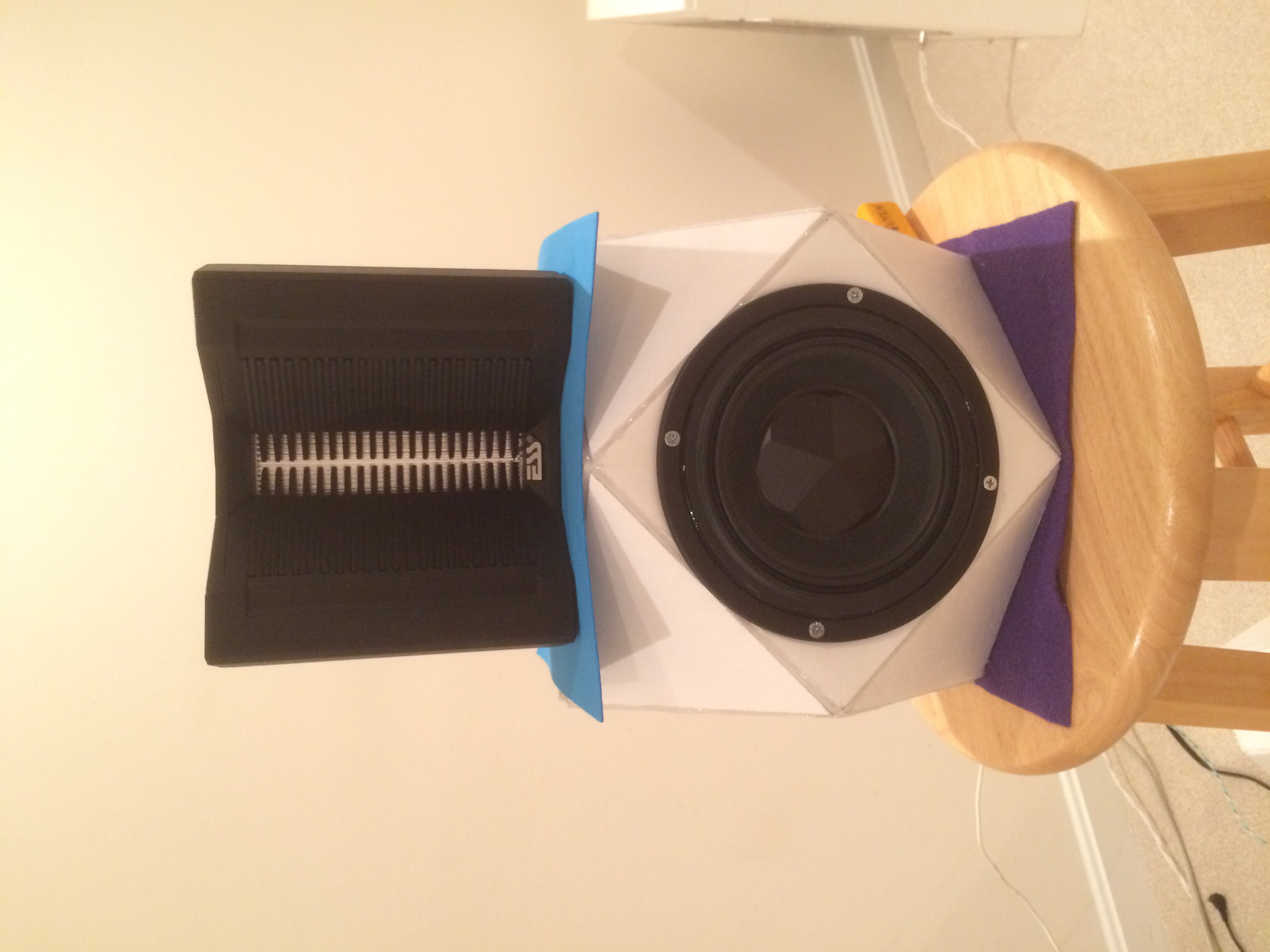

I made a 2-way with an AMT and a 5in sub driver W5-876SE (discontinued) but any 6.5in Peerless woofer would work. Use a sealed box and make it an WTW and XO at about 700Hz. That way the AMT handles the main telephone band for awesome vocal clarity and audibility. Don't do the TWT - you would get bad comb interference that way.
http://www.diyaudio.com/forums/full-range/265915-hyperfast-hypercube-based-2-way-11.html#post4156111
Here is the FR I got:
Impulse:
Minimum Phase:
This was just a quick prototype:
It sounds very nice and I think would make a great center channel.

Thank you very much for the response. I see that the prototype is like my 3rd image/config. Is that how it ended up? Do you have a pic of the finished product 🙂
OK roger on the kabash of the TMT, however would I not also get some interference with MTM (just not as much?)
Oh yes - one more question: did you have to add a potentiometer or something to adjust the sound/loudness between the AMT and the woofer? Thanks again!
I never went with a final build because I used the AMT for another project. But I can see how I would have really enjoyed it simply as a two way in a top/bottom type box. It has wide dispersion so you don't want to block its sides. I used biamp with TPA3116D2 amp and miniDSP so I could easily dial in the relative balance. The AMT is very sensitive to you need a sensitive woofer or two if you want to keep up with it.
you have nailed down my question
Thank you again. You have really nailed down my question:
-I do wish to employ a sealed box for the woofer
-I also think that I need a speedy/sensitive woofer (how do I find selection criteria? How would I fine likely candidates?)
-How would I dial in the 'relative balance' between the woofer and the heil/amt if I am running off a standard center channel output?
-Finally would the old rule of thumb to make a sealed box in proportions of 0.6:1:1.62 still hold true for this application
Thanks for your help!!!
Sealed gives best transient response
High sensitivity, large xmax, higher Qts for hitting lower 80Hz with sealed box, look for fs well below 80Hz - say 50Hz fs, Qts of at least 0.5, and at least 6mm of xmax.
A good esxample is this driver Peerless SDS-160F25PR01-08 6-1/2" Paper Cone Woofer Speaker
You need a 700Hz XO which is not easy to come by with passive components. You need a XO and an L-pad (variable resistor) to adjust the balance. If you go with a higher XO, you are throwing away the special and unique ability of the Heil AMT to cover from 700Hz up to 20kHz for a truly special sounding phase coherent speaker.
I think you are talking about golden ratio boxes to avoid standing waves - don't worry about as you will be using quite a bit of stuffing

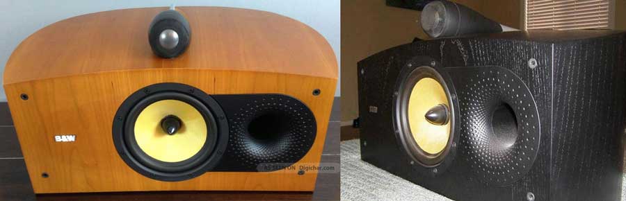

But I did finally find a speaker in the configuration that I actually want to make AND get this: they did intent its use for a center channel!
B&W Nautilus HTM2 (well I dont want bass reflex I want acoustic suspension but it is close)

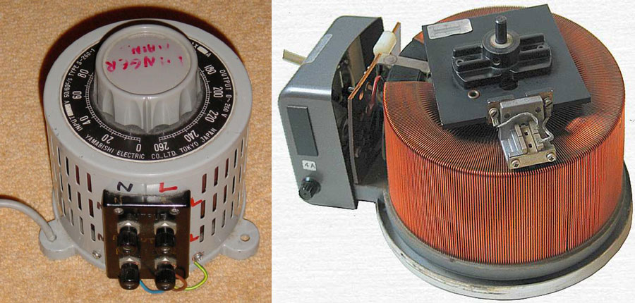

As far as controlling something with an adjustable resistor I remembered my use of a Variac, a variable potentiometer that could handle decent current I used this to help built a photo resist dipper for our thin-film lab, we used the Variac pot to control the speed of the motor in turn controlling the removal of a substrate from photo-resist... lol maybe *MAYBE* overkill for this application but I am stumped on what do actually do

Well, actually every L-Pad and this Attenuator as well cite 8Ω whereas the Heil and the speakers I am looking at are are 4Ω
Thanks again ... however I think I will go for this project, but I want to start with a
T
M
configuration (like yours) but I am space constrained to 12" total
the heil is 6 3/8" tall
meaning that 4.5" woofer is on the outsize
4" is more like it... so I am on the lookout for a 4" that fits your criteria if i can 😀
T
M
- Goal: Create a center channel speaker that compliments/matches my ESS AMT-1D main spe
