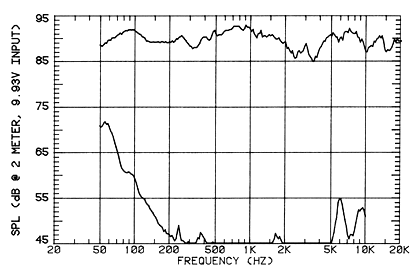

I explain:
- Tube amplifiers are know to distotion producers.
- Loudspeakers are REALLY distortion producers. Does not matter what power amplifier you use.
Valve power or Solid State power or MOSFET power.
No big difference for our loudspeaker part.
It will produce considerably more distortion than any modern amplifier.
von Schweikert are expensive High End audiophile speakers
no doubt about this 🙂
Still von Schweikert has a level of 0.5% THD at 1-2 Watt RMS.
1 meter away from speaker on axis.
PMA talks about the -90 dB level. He is in his dreams 😉
Because when listen with loudspeaker
and consider the Listening Room effects
( floor and ceiling and walls indirect sounds )
we are close to 1 % THD at 1 Watt.
1% = -40dB
0.0032 % = -90dB
What will dominate what we hear?
the Op-Amp THD or the Speaker THD.
I do not know what you think is correct answer.
But fortunately still I have some intact logics in my brains.
I attach the THD test curve of von Schweikert very expensive speakers.
They are NOT low or ordinary quality as of yours and mine speaker systems.
And they try to avoid Room influencis when measure
by putting Test Microphone 1 meter on Axis in front of speakers baffle.
no doubt about this
1% = -40dB
0.0032 % = -90dB
