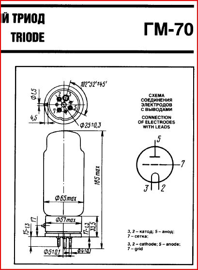

I found three GM70 datasheet on the web, this on Image 1 seems incorrect on the tube pinage. On this GM70 datasheet PDF file(image 1) there is a pinout drawer totally wrong or Iam missing anything??
Image 2 show the same pinout drawer with zoom, Image 3 is a real GM70 pinage photo, it is visible there is some differences in pins positions and mainly in the thicker pin tradicionally reserved to the plate.

Some major confusion on your part.
In "image 4" - what you've labeled as the "cathode" and "unconnected cathode" are the grid.
This is a Directly Heated cathode tube - there is no separate cathode - the filament is the cathode.
I don't have a GM-70 to physically look at, but here is a datasheet in Russian that shows a base which matches your tube.
The drawing of the base on the datasheet you posted does not match your tube; the location of the large pin is different. Where did that datasheet come from?

I find this datasheet at Frank's Tube Datasheets http://www.shinjo.info/frank/sheets/084/g/GM70.pdf there is other PDF file in this site, that show this drawer you show, looks this is the correct.
Many thanks, Gustavo
Michael's drawing seems to be correct.
It's very easy to look into an actual GM70 and identify the pins on sight.
You'll find that the two pins closest together are the filament. One of those is thicker than the rest.

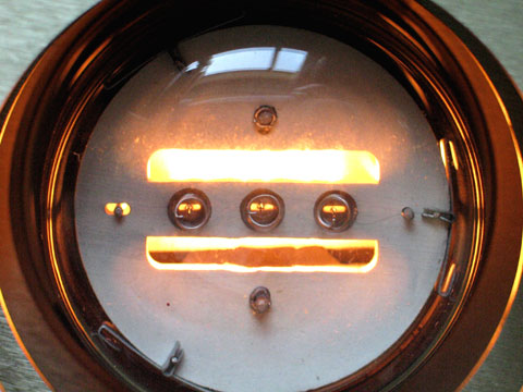

No, that thin wire in Image 4 is the grid. The two rods are the support rods for the grid. The heater/cathode is NOT shown in Image 4, it is a VVV shaped filament inside the grid wire loop. If you look at a real GM70, you can easily see it from above.
Kenneth
Kenneth
OH YESSS, now this is clear. Thanks alot Kenneth. Taking one more image from JacMusic, the four shorts pins in this image should be the cathode.
Looks to me the support rod that are connected receive the Bias.
Thanks for your help, Gustavo
Yes. The 4 short rods are where the VVV shaped filament/cathode is held in place. You can still see some remnants of it in the photo. The three "tops" of the VVV are held in place with three springs at the top of the tube, as you can see in this photo:
http://www.positive-feedback.com/Issue9/images/845_closeup_top_down.jpg
Kenneth
OH GREAT!! Now we are reaching some place... Seeing a GM70 I have, really there is three wire upright inside the plate, that are held in place at the top ceramic disc as three springs. Thanks again,
Gustavo
