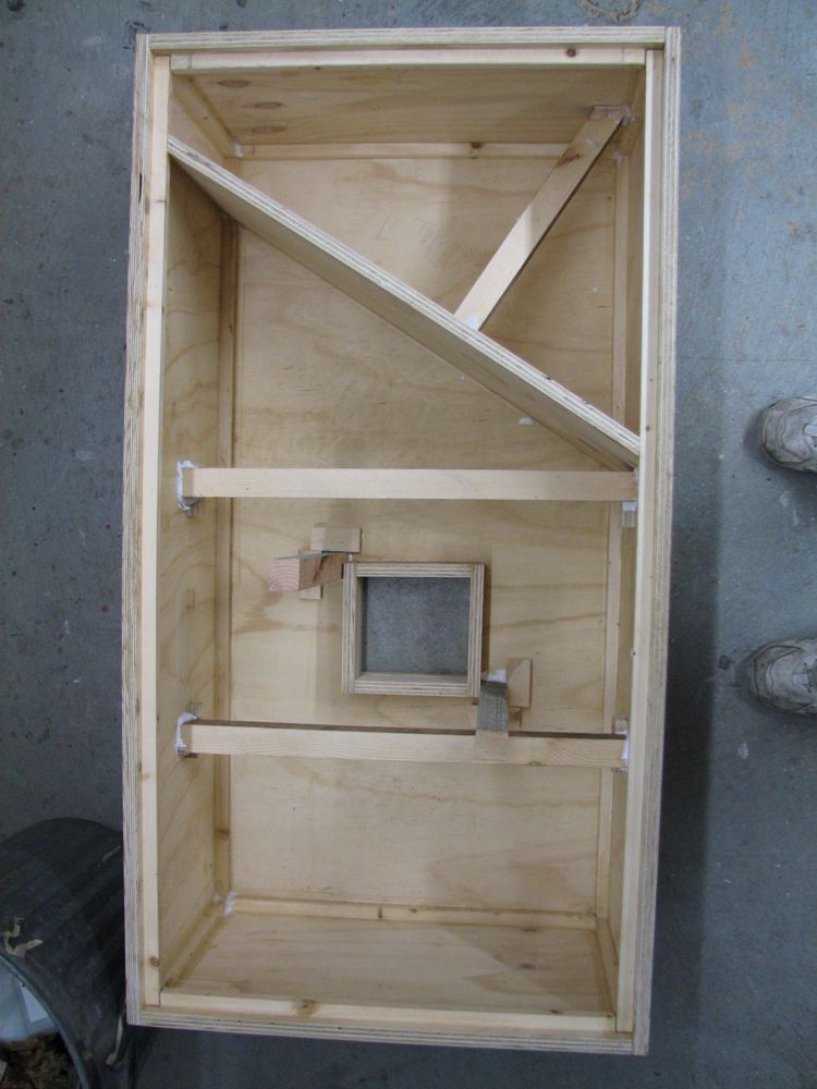

Cleats are what you see on the inside corners of the attached box. A finish nailer is an air tool that fires small, almost headless nails. You install the cleats on one panel using a scrap piece for a spacer, using your nailer and glue and by the time you've done them all, it's time to assemble the whole box. Glue by using big clamps to hold the panels while you fire your nails on the inside through the cleats and you can release the big clamps because the little nails are holding it now and go onto the next panel. You need only a few clamps, you can assemble faster than any other way, you have no exposed fasteners except on the back panel (and only if you're lazy or it's too tight to fit the nailer inside the cabinet's woofer holes.)I know clamps, but what are cleats and finish nailer??
I used to dread making even the test cabinets but no more. Gone are the screws, biscuits and all those other headaches. Perfect alignment of panels, no heartaches, no oop's or ah sh!7's, no extra bleeding, nada. Me and my air nailer are in a long term relationship. 🙂
