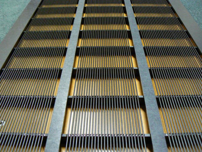

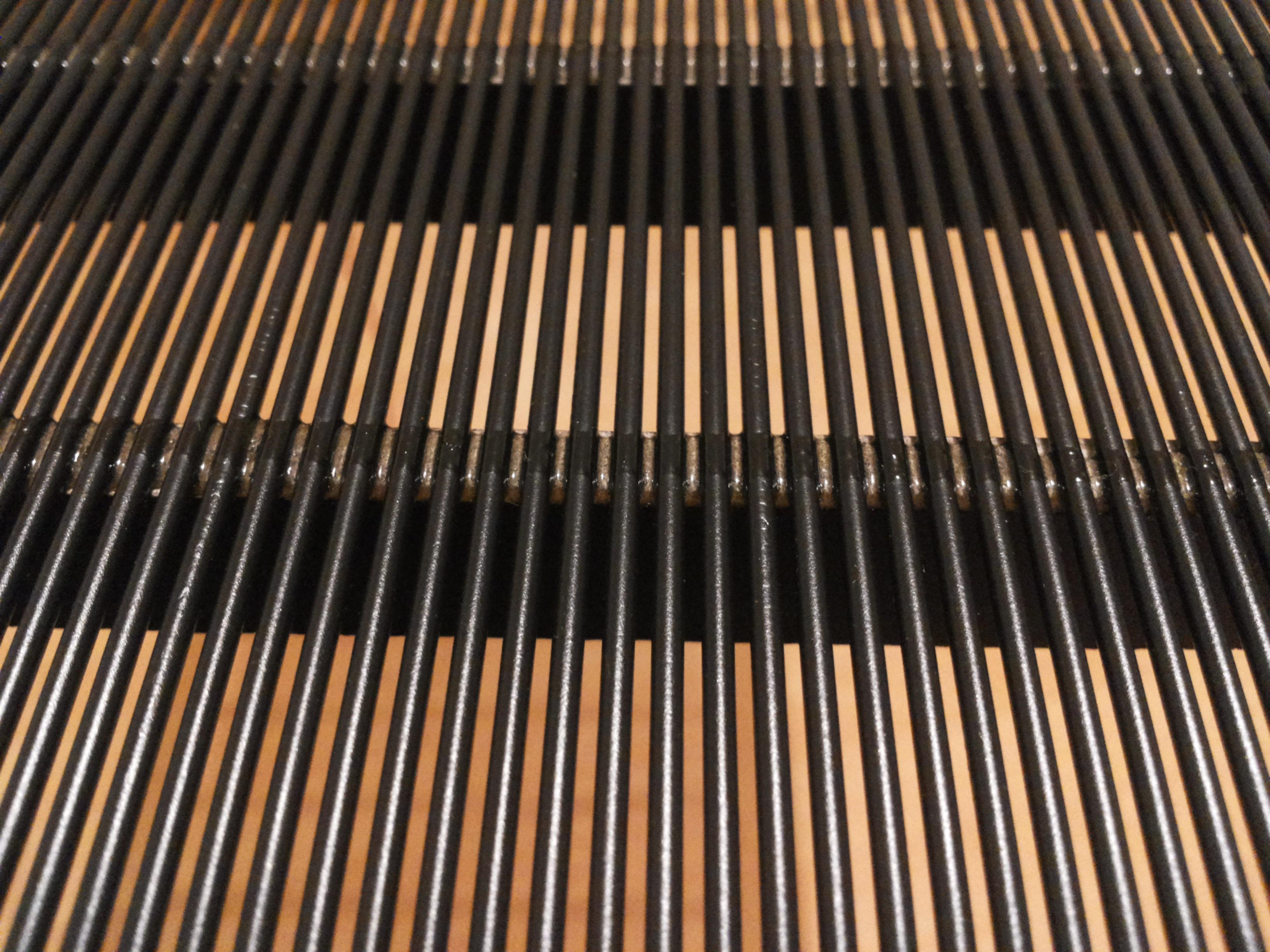

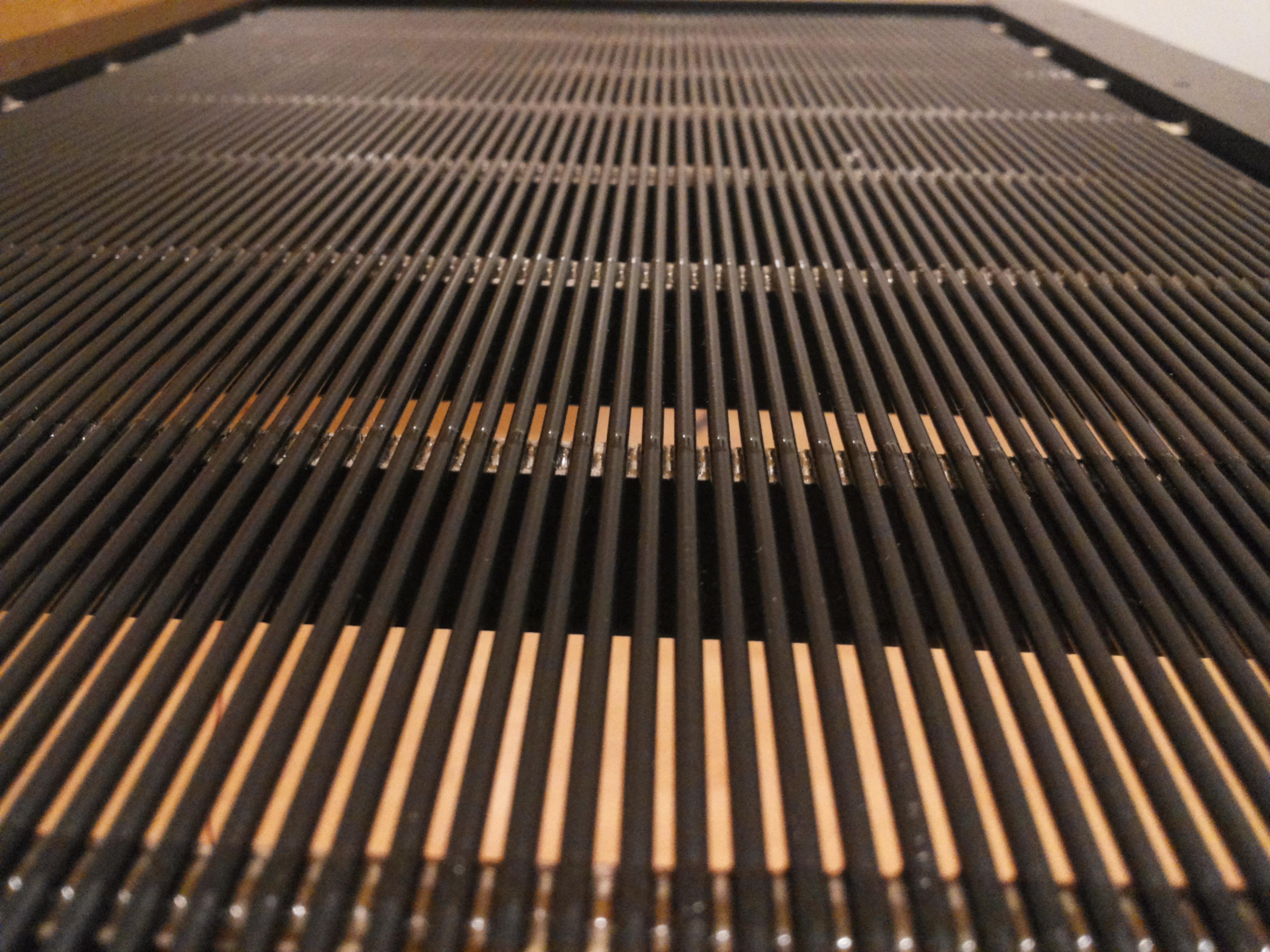

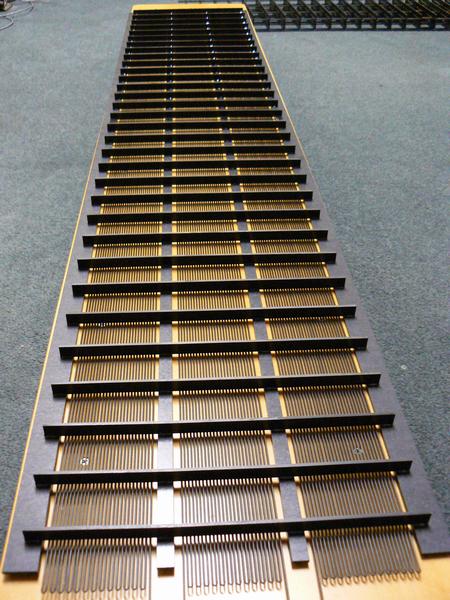

Here are some of pictures from a panel build using epoxy + marine grade ply for cross bars to get an idea:

nice pics verry straight!!! i can see you put the glue on the wires and let it soak down. this might work with all the glues i used. but i must say speed is an isue with me 🙂 no patience so it seems 🙂. i always keep speed in mind.
for instance i know use my cnc to mill one stator, the only problem is if i let him mill the spacer, say 1 mm, i run into the problem that my table is not level 1 mm all the way. its almost impossible when using a woodden spoil board (moisture and stuff or previous cut pieces leave marks in the bed)
so i mill the space where the wire need to go deeper then 3 lets say 3.5 the wire is 2 mm and the stator membrane spacing need to be 1 mm.
what i am trying right now is to use hot glue. and use a slightly bigger amount then needed to only tack it down. i want to fill up the 0,5 ~ mm i milled deeper then i needed. i heat the glue extra with a heat gun unltil its really soft. at top and bottom of the stator i glue the wires create the needed DC spacing of 1 mm and glue the 1 mm pvc that covers the wire in one go.the the glue i used to much comes out between the wires. so it all sits snug.
the supports i want to do the same, only problem there is that i dont want to glue the Pvc 1mm thick plastic on top of the wires, i only want to use it to set the spacing between wire and the frame where the menbrame gets sticked on. so now im looking for a simple tool wich i can press on the wires when the glue is hot wich does not sticks to the glue because i want to remove it when the glue cools down.
i tried using silicone spray on the tool this worked but not super, tomorow i create the tools/press from a piece of HPL and stick a piece of baking paper on the botom so it wont stick to the glue.
this all seems pretty much work just to glue a stator, but in the end i can create stator frames with a mouse click, and when the CNc is cutting i can stretch the wires, glue them right in and after a few minutes the glue is set and ready for duty.
sorry for the long story, i hope to make pictures soon , its hard to explain stuf in a non native language
i see you use seperate supports for the wires. i thought about this option to because then i would not have the problem with uneven cutting bed of the CNC machine. but i relaly like the fact of running the progamm, doing something else and come back to see a frame ready for wires 🙂

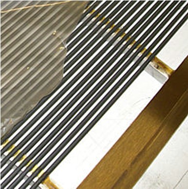

Attachment 3 shows the glue joints for an Audiostatic ES-100 stator.
The adhesive used is tan in color and does NOT encapsulate the wire.
Crossbars are anodized aluminum. Anybody have any idea what it might be?

As with epoxy, there are many, many types of CA glue most of which won't bond well with PVC and/or will damage it. The particular product I mentioned was one I found that bonded strongly to PVC without damaging it(I'm sure there are others). It's a little pricey, but if you are in a hurry...I've never used cyanoacrylate due to concerns of possibly damaging PVC insulation. Have you tried to inspect if this glue does any damage to it below surface? By the way, nice looking stators. Have you finished the project?
The stator pics are from some panels completed in 2009. They were used for experiments to validate segmented stator line source theories and models mentioned in many threads on this forum. They are retired from testing duties, now happily playing music instead of being tortured with test tones.
