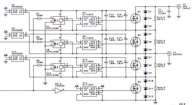

I’m designing a 1200V half-bridge PWM amplifier as a plate modulator for a vacuum tube class C AM RF transmitter. Upper audio bandwidth limit is 3kHz and the switching frequency is 100kHz.
Switching frequency ripple voltage at the output needs to be rather low (than for speaker driving applications), so a multiple pole LPF will be required at the output. However, the ability to apply a fair amount of global NFB would be desirable.

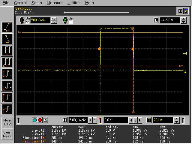

Anyway, if anyone is interested, attached below is my 2kV+ half bridge circuit. MOSFETs are low capacitance high voltage units from Sanyo. D1-D6 are beefy transorbs to clamp Vds. Works very well to over 3kV, but the topmost DC-DC converters begin to break down eventually 🙂
