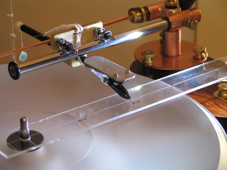

Theorizing and testing
I'm posting a photo of my 'almost finished' mechanical linear tracking tonearm derived from the original work of Colin in the "DIY Linear tonearm" thread. There are other photos of mine, posted today, at that thread; and, in time, a full report on my arm OTF VTA linear arm.

Points taken, John. I elaborated on the other thread so from now I will rest on the topic. And those who know me in this forum prefer me to continue to provide more tonearm porn, err, entertainment for the DIY community. 🙂
Thanks for contributing the picture of your impressive project. I like the simplicity of it and quite elegant. I notice the counterweight is hung on a string so that reminds me of the Roksan tonearm's Intelligent Counterweight.

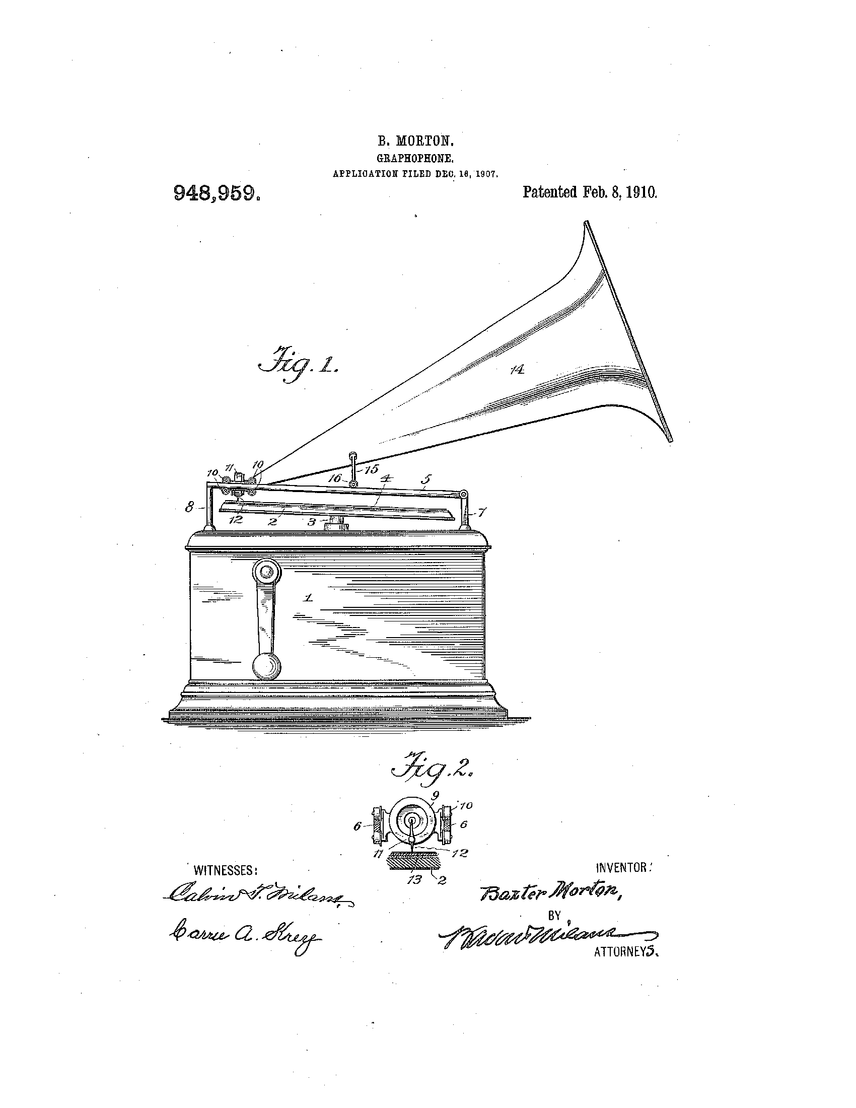

1910 acoustic passive linear tracker phonograph
Speaking of grand daddy lineage [no pun intended], I came across this 1910 patent for a passive linear tracking pickup for the horn on an acoustic phonograph. The patent even describes tilting the the platter and pickup, presumably to overcome some of the 'sticktion' of the rollers on the two parallel tracks - a concept I've seen mentioned in another thread.
The U.S. patent number is 948,959.
Methinks too much VTF for vinyl, though.
Ray K

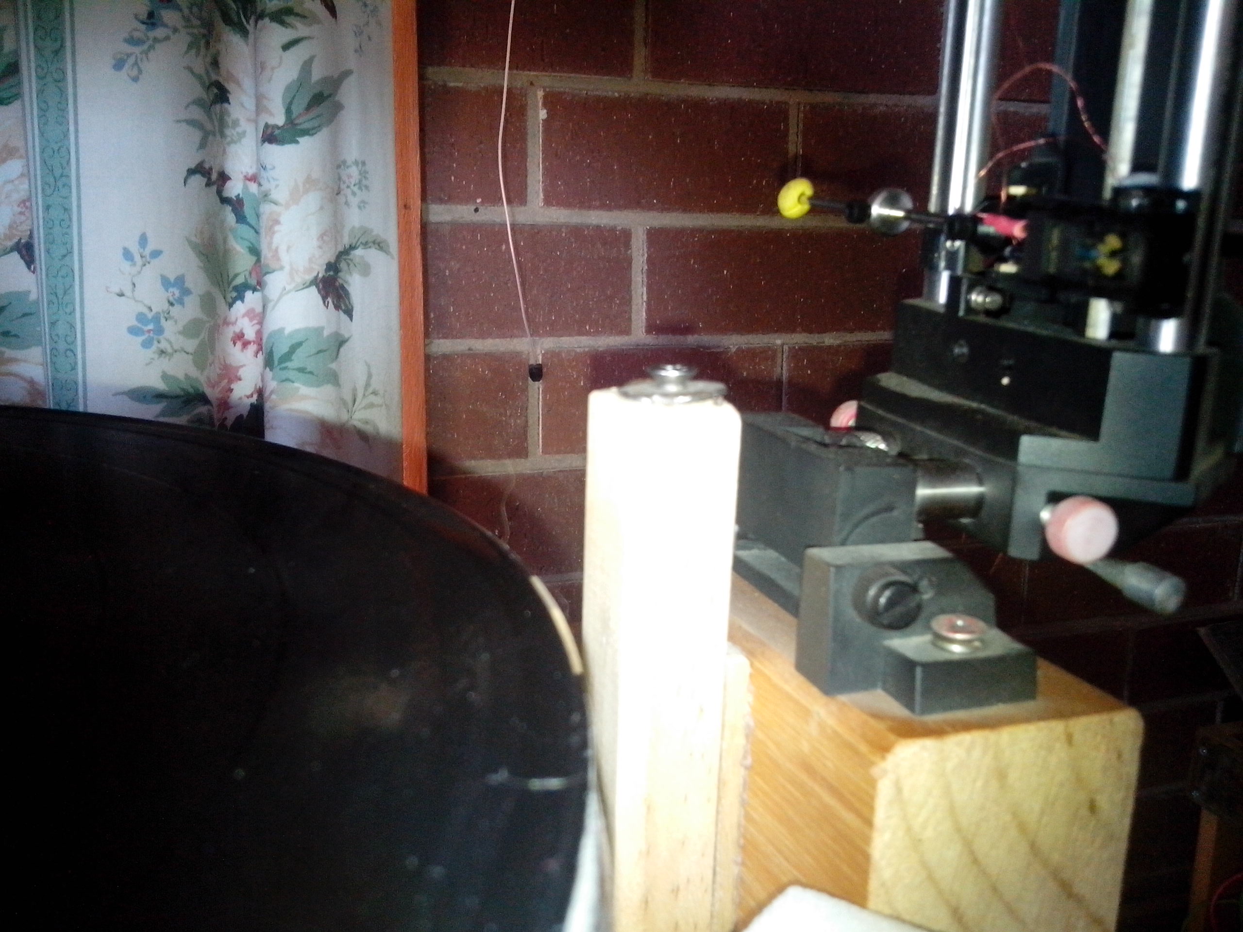

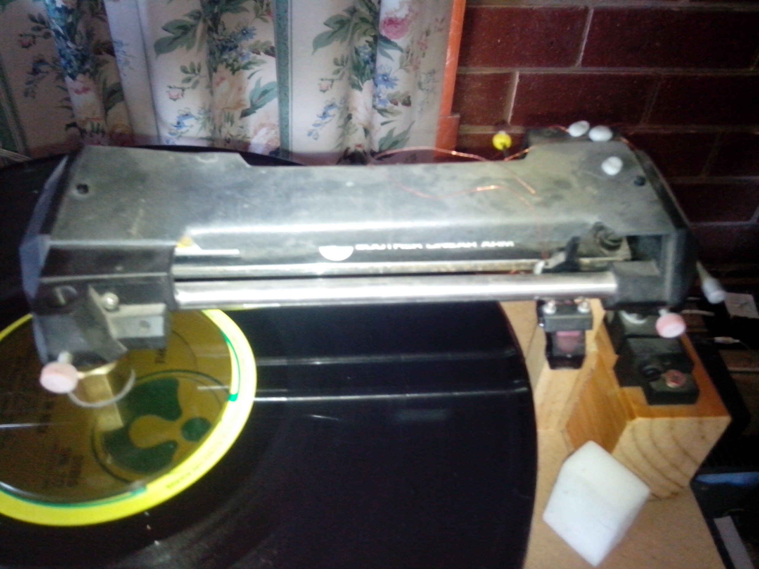

I love the Souther arm. I have 2, and have one on my SOTA table, with a WIN strain gauge cartridge. Amazing sound.
But there are a couple of design flaws in the Souther that I have tried to fix up in a DIY fashion. These are:
1. crappy cartridge leads and too many connectors
2. The arm sits on the spindle
3. Cheap plastic top cover
For the cheap cartridge leads my solution is simple - I have assembled 2 runs of twisted pair cable, made from 0.125mm winding wire. At one end I have soldered cartridge clips onto the wire, at the other end is a pair of RCA plus. The cable is carefully dressed to avoid any drag on the cartridge, following a similar path to the old Souther layout. One piece of very thin single core cable, from the cartridge to the pre-amp - what could be better.
I hate the thought of the arm sitting on the spindle - while friction is assumed to be low i am pretty sure that there must be some noise getting into the system. I think I first saw this idea on a Clear Audio arm, I have put on small block of wood on the plinth right next to the base of the souther. There is a T nut in top of this block and a bolt that screws in and out (with a flat head). The end of the arm carriage, closest to the pivot, rests on the top of the bolt when the carriage is lowered across the record. I have removed the spindle locater from the other end of the arm carriage. The bolt is screwed up or down to level the arm carriage.
To replace the cheap plastic top plate, my mate who was using my spare Souther fabricated a new plate made from lead. The extar weight and stiffness of the lead, compared to palstic, has a significantly positive impact on the bass - it goes deeper and is tighter. The only problem with this approach would be unbalancing the suspension if you use a suspended deck, but as my SOTA is no longer suspended (that is a story for another day) it is no problem for me.

Thanks for the photos and explaining your mods to the Souther. I totally agree with problem #2. I was bewildered by it the first time I saw a Souther that a tonearm would sit on a MOVING part! Glad that you're able to fix the problem. At least Clearaudio addressed the issue. But I'm curious why they never consider using a pivoting base like the one in the Versa Dynamic arm. A tiny magnet can be added to lock it when the arm is swung in play position and I believe it's a bit more user friendly than the raised bridge style assembly. I guess the bridge style arm looks more visually impressive to the buyer.
