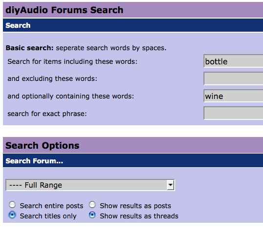

Cal Weldon said:
Dat's da vun! 😀
Thanks Cal!
