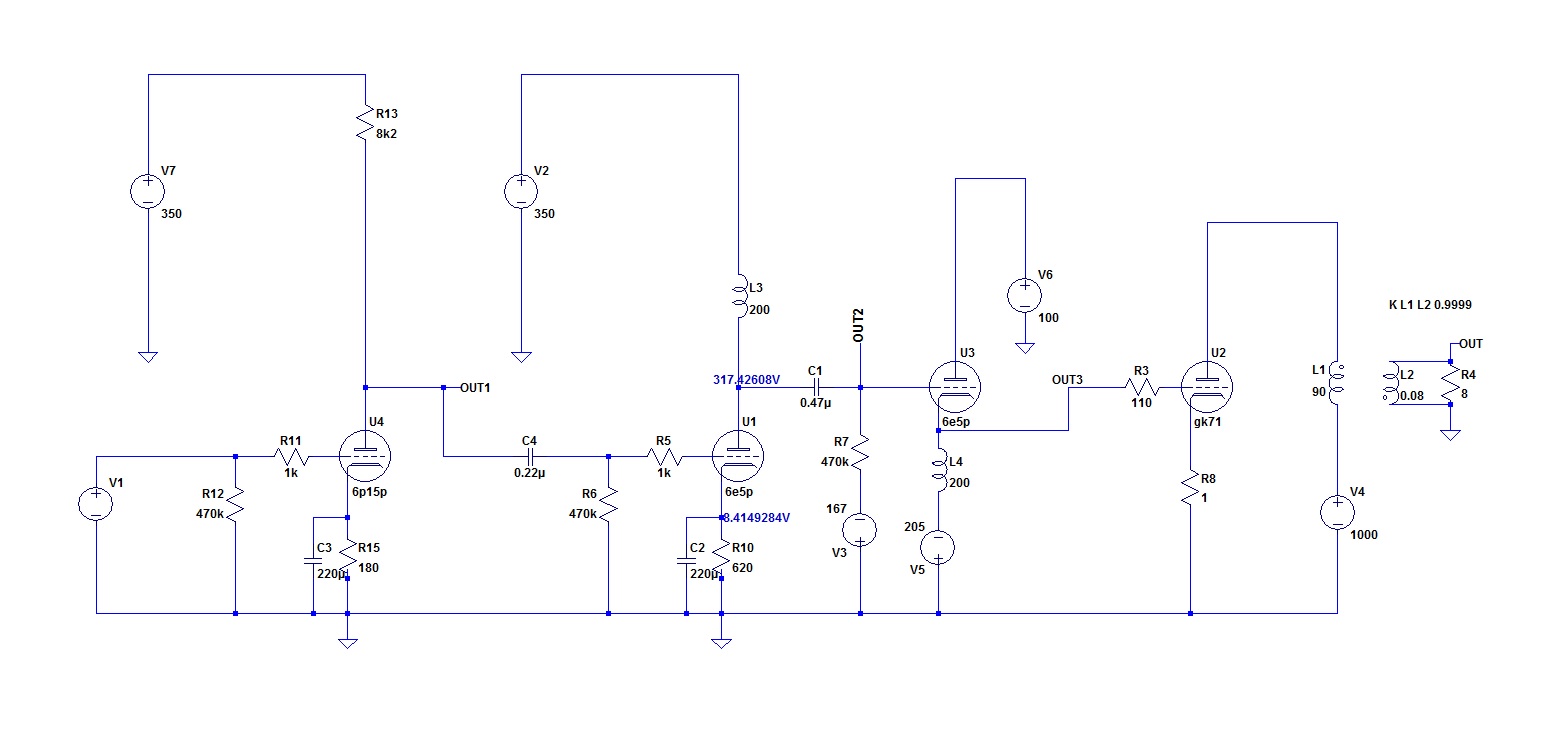

Hello , do you have a spice model for the -71 tube ,40W in triode in deep A2 SE. Still only in LTspice.
especialy a pentode(tedrode) Modell?
pleas let me know
best regards bruder tuck

No thanks , i need the pentode spice model of the GK-71 tube
gm70 and GK71 as a triode model is in my libary
but not the GK-71 as a pentode , i need Pentode as spice model
lg bruder tuck
