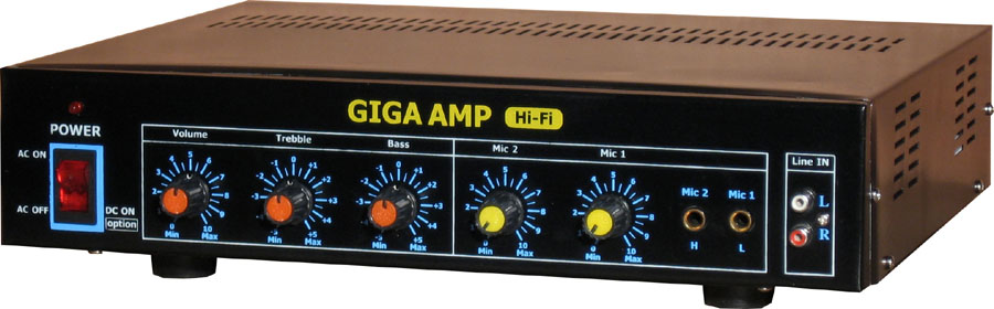

Now I am trying to test my new complete AMP.
But there are many problem.
Power AMP + Tone control + two mice pre amp.
Power AMP single(or)bridge.
Tone control Bass, Treble
Mice Pre amp low, high impedence.
I found very noisy when combine all together in high all volume.
Mice pre amp need output resister.
Some Ground resister must take out & connect direct.
If I do that noise level will decrease.
Why that happen ?
I will post my schematic later.
Here is my picture.

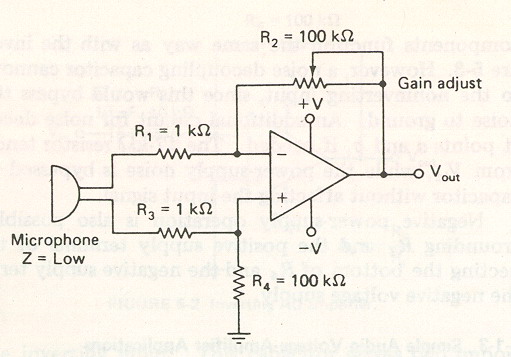

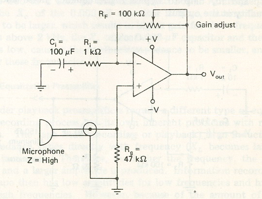

Here are my schmetics.
Two Mice Pre AMP Low & high impedence.
1. Low Impedence Pre AMP
need to ground between MIC & R3.
Why ?
If not that pre amp very noisy.
2. Two Mice Pre AMP need output resister before to the other pre AMP.
If not appear little crack sound ( not clear ) when talk to MIC.
Pls, advice & Explain.

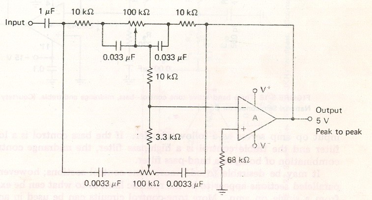

My tone control is very clear & good.
I compare with DVD output to direct input TDA2030.
I don't know why ?
With my tone control is more clear than DVD direct input.
Anybody can explain to me why that happen ?
I think that may be because of Impedence.
Is that true ?
My TDA2030 circuit is same which is in data sheet.
Pls, Explain to me.
