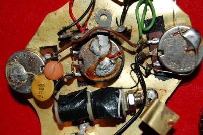

The original Gibson solid-body L6s designed by Bill Lawrence (not the reissue with completely different wiring) had 2 tone controls; one was a conventional high-cut and the other was a midrange control with an inductor (see picture), unlike the reissue which has a 'bass' control instead.
I sure wish I could get someone to measure the inductor for me. This is from somebody selling the control set on eBay (for a huge amount of money).
It looks like it's wound on two bobbins, with a bolt as the core. Heck, it looks homemade. Gibson schematics I've seen do not have a value, just a meaningless part number.
Bill Lawrence's Q control should be pretty close, reported to be 0.9H, which will put the center frequency at ~1.7k, you may tweak it to taste...

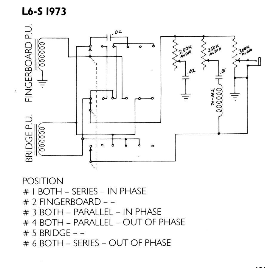

I haven't seen that before. With that pot: rotated clockwise it's a high-treble cut, and rotated counter-clockwise it's a mid-peak bandpass. Jazzy, no doubt. I guess those resistors across the caps are to alter the "Q", or are they just to keep the caps from making any 'pop' noises when switches are thrown? It applies the 'tone' control to the pickup output / input to the volume so that the volume doesn't change the tone much. I imagine that 'tone' control has really 'jazzy' 'woody' sounds, without a lot of treble unless it's in the middle of the pot's rotation?
The original 1973 L6S was supposed to be more versatile. Its 'mid' pot doesn't have that .02 cap bypassed w/ 1M resistor on the full-clockwise setting, and counter-clockwise it's a .01 cap in series with the unknown inductor labelled on the schematic '70-062'. And again, the 'treble' pot and the 'mid' pot are applied to the pickup output / input to the volume pot, so that the 'volume' pot doesn't change the tone much.
On the new 2011 reissue L6S the third knob isn't a 'mid' pot anymore, its a 500K which counter-clockwise puts a cap in series, a 'bass cut' control as they label it. No inductors at all. What is surprising to me is the value of the cap, only 500pF. And it's applied to the OUTPUT of the volume pot, between the volume pot and the output jack.
On the original, the 'treble' pot in series with the treble-cut cap had the cap wired to ground and the pot wired to the pickup output. I think that's pretty normal. On the reissue, the two components in series are reversed, with the cap attached to the pickup output hot, and the pot connected to the ground. Though the control's effect should be the same as the circuits are equivalent, I wonder whether that has any different effect on any 'scratchy' noises when moving the pot?
The original and the reissue also have something you don't see every day: a 300K volume pot. Usually you have a 250K which seems to cut treble a bit on those guitars, or on other guitars a 500K which hums a little around the '7 of 10' setting where it's not grounded much thru the pickup nor thru the grounded end of the volume pot. Maybe a 300K is a good compromise?
Here's the two documents. I got the new one directly from Gibson, and this is probably the first time it's on the internet, and I have Gibson's permission to post it.

I guess the best way is to breadboard it and hear which version suits you the best, but wonder why the newer model changed the configuration, was it by "popular" demand?
The new version's rotary switch has more "pleasant" sounds, including ones using only half the humbuckers. Very nice, even Fenderish. And the big selector has some volume and tone correction to make it more pleasant when you change the switch without big changes in volume etc. But the old version could put the pickups in series, and reverse the polarity of one to get them out of relative phase to each other. So the old version was much more versatile with some weird settings and behaved differently with some amps (mostly input impedance). The new version is meant to always sound 'nice' in the showroom, and is always more pleasant. Sometimes art is supposed to be disturbing though. Santana called the original his 'rainbow' becaue it was so versatile. Then new one isn't as versatile, but it's ironic that the original was intended to get share of the Fender strat and tele market, but the reissue does better at trying to get those single-coil sounds with humbuckers.
But I think Bill Lawrence might have been more sensitive to the woody mid-boost tones that jazz players used with hollow bodies, so there's also the 'mid' tone control. Which I think is a cooler thing than the new 'bass' control, and turning down the bass and treble is not quite the same either. IMHO the new 'bass' knob is mostly handy for cutting bass when playing thru a little champ with a 6" speaker, where any real bass just makes the treble choppy.
