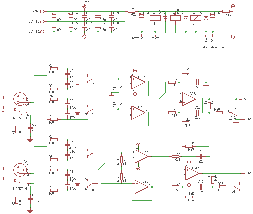

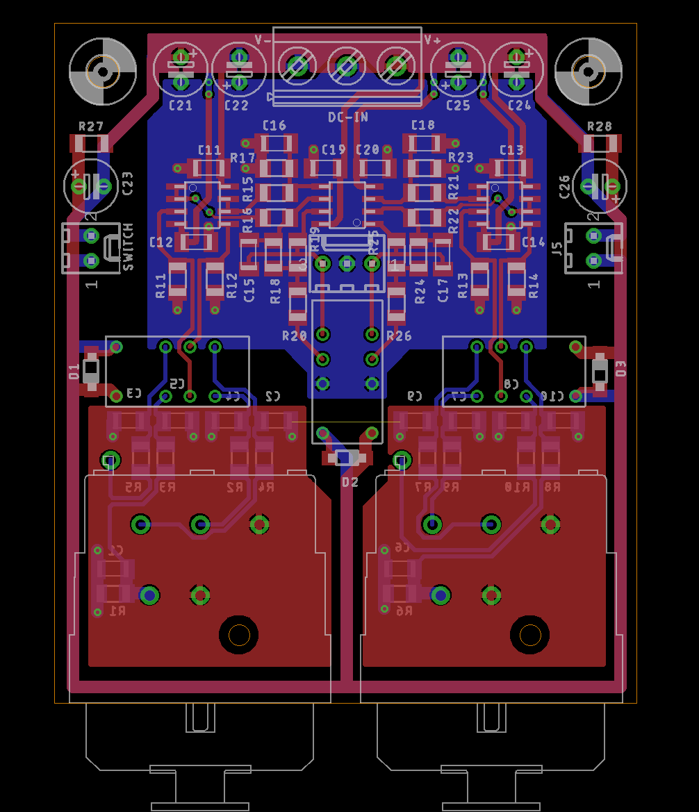

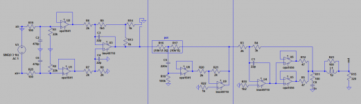

Input board
Basically it's a classical inamp. I don't particularly need multiple inputs but what I wanted is the possibility to have either balanced or SE input with minimum hassle. So I'll have combo xlr jacks, to minimize the space taken. Using relays to switch between the xlr and 1/4 jacks allows me to also switch the gain at the same time. It's at unity for balanced input, and at 6dB for SE, to account for the usual difference in levels.
I'll use opa1642 for the input buffers. They have a very strong EMI rejection ability, so it allows me to keep the external input filter minimal. For the output, the lm4562 is well suited.
At 60*70mm, it's compact enough that I could have two of these boards in the box if I ever wanted dual inputs.
810959d1579770982-getting-started-modular-headphones-amp-receiverschem-png
810960d1579770982-getting-started-modular-headphones-amp-receiverpcb-png

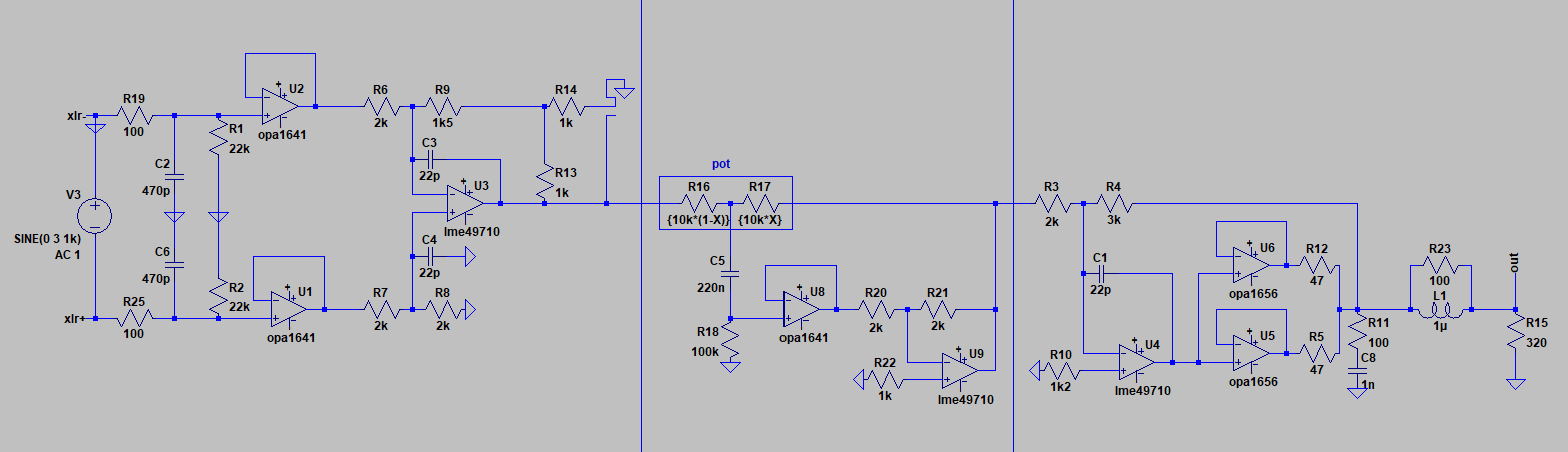

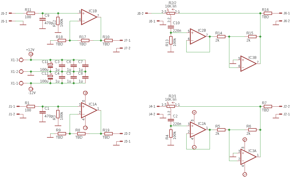

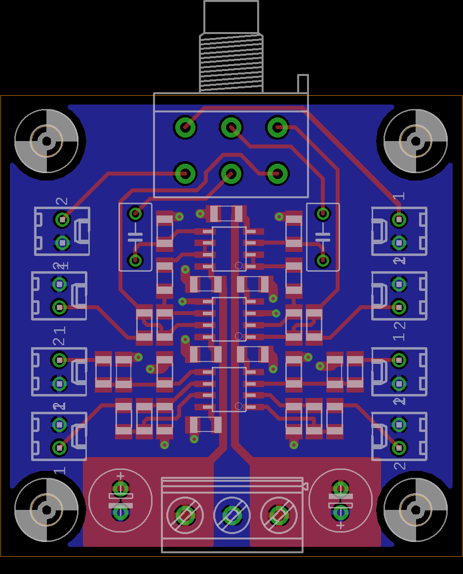

Volume control
The volume control board is a bit more complicated than necessary, a gain stage has been added so that it can be used as a stand alone preamp if needed in another project. The board dimensions stay reasonable, at 50*50mm. The pot used is the typical 17mm Bourns or Alpha. The first opamp after the wiper should be an opa1642, the inverting opamp afterwards a lm4562.
attachment.php
attachment.php
Headphones amp
To come, simple composite lm4562-opa1656.

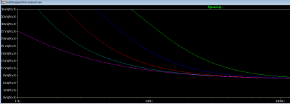

Wasn't the problem with the A1 that the wiper carried DC as the pot was used in a trimmer fashion ? The classical Baxandall as used here doesn't suffer of this, due to the cap.
I can increase quite easily the cap's value, there's room enough.
I just ran a sim in ltspice. The following graph shows the cap at 100n, 220n, 470n, 1u, 22u. The point of diminishing return seems to me 470n.
A 470n/100VAC wima MKP2 can fit with some minor shuffling around, at 8.5*75mm, 5mm spacing.
