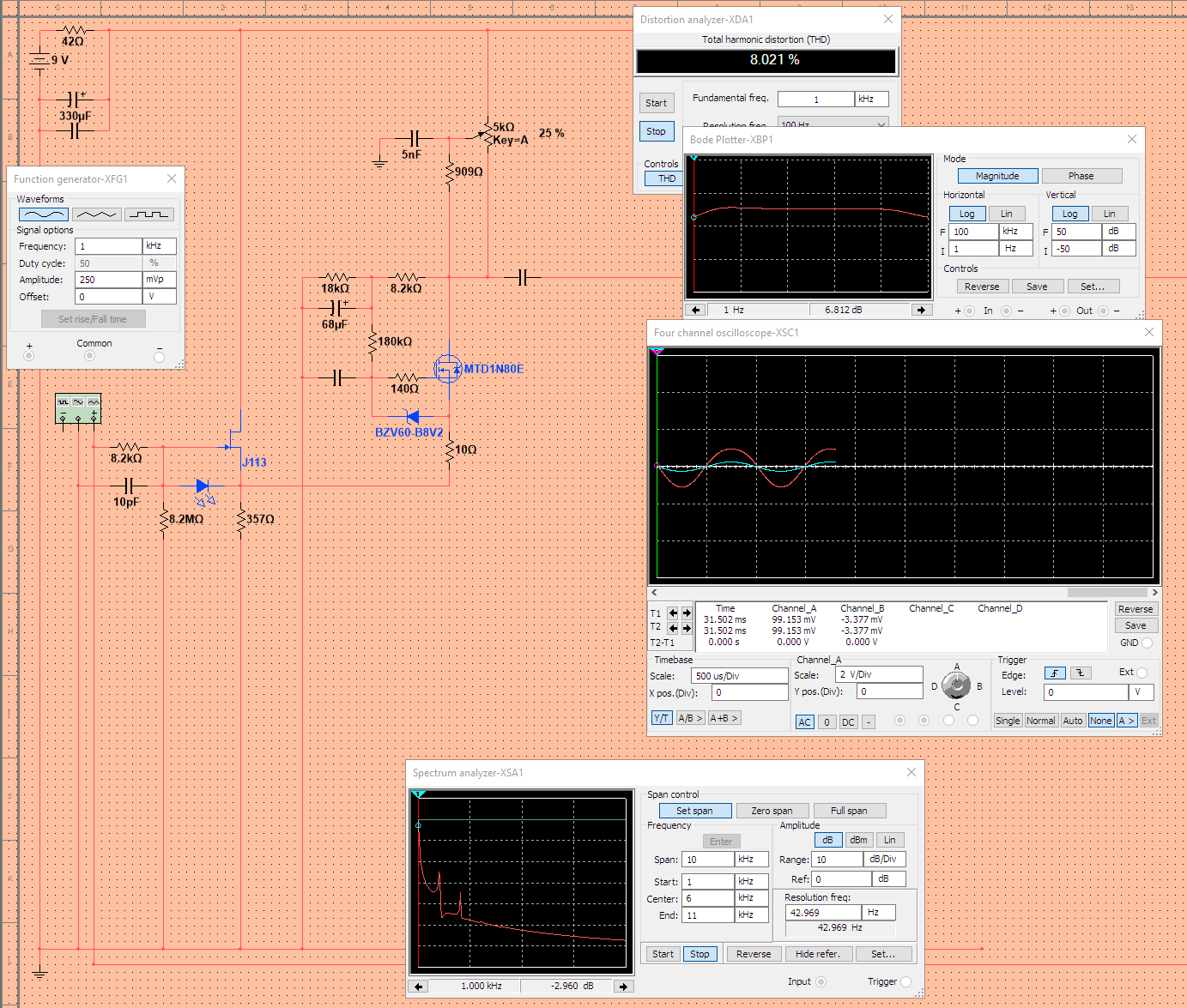

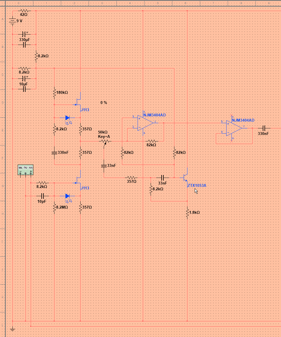

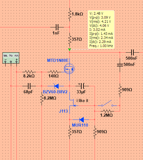

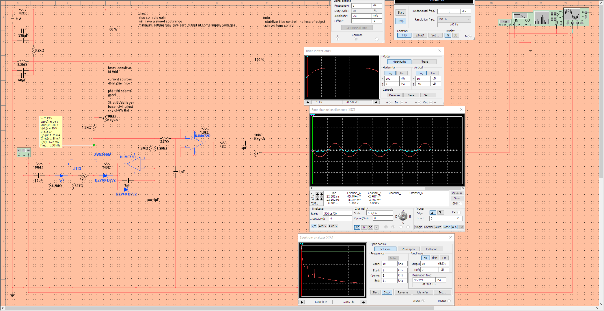

I should really tidy these up some more, but here are a couple quick examples of what I'll be playing around with. In some cases my schematics are greatly simplified, for example eschewing protection diodes, or are meant as more of a proof of concept than a finished design.
