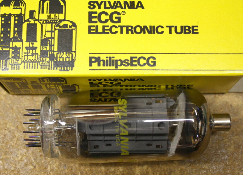

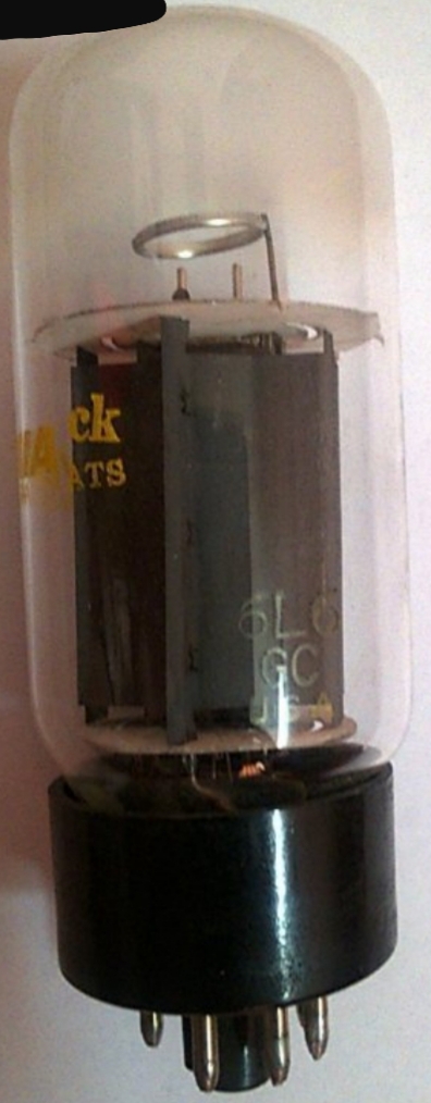

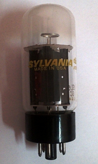

So I was looking at some tubes a few days ago and I saw the one and only 6L6GC on sale in Iran. It's a second hand Sylvania with the original box.
Now, everything seems fine to me except the getter. It seems to have the getter disc/ring, but it doesn't appear to be flashed. I'm not sure if this tube wasn't flashed when manufactured or there's something horribly wrong with it.
It's cheap though, around $9. The seller states in the description that "It's worth over $40 on foreign websites".
Do you think it has the barium azide on the ring that I can flash with my induction heater or it just has nothing?
I have attached the pictures of the tube.
Thanks!

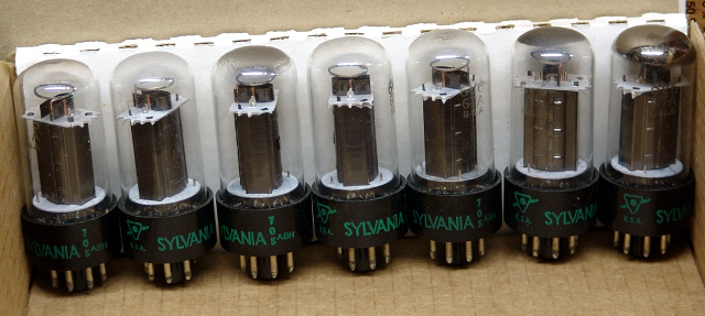

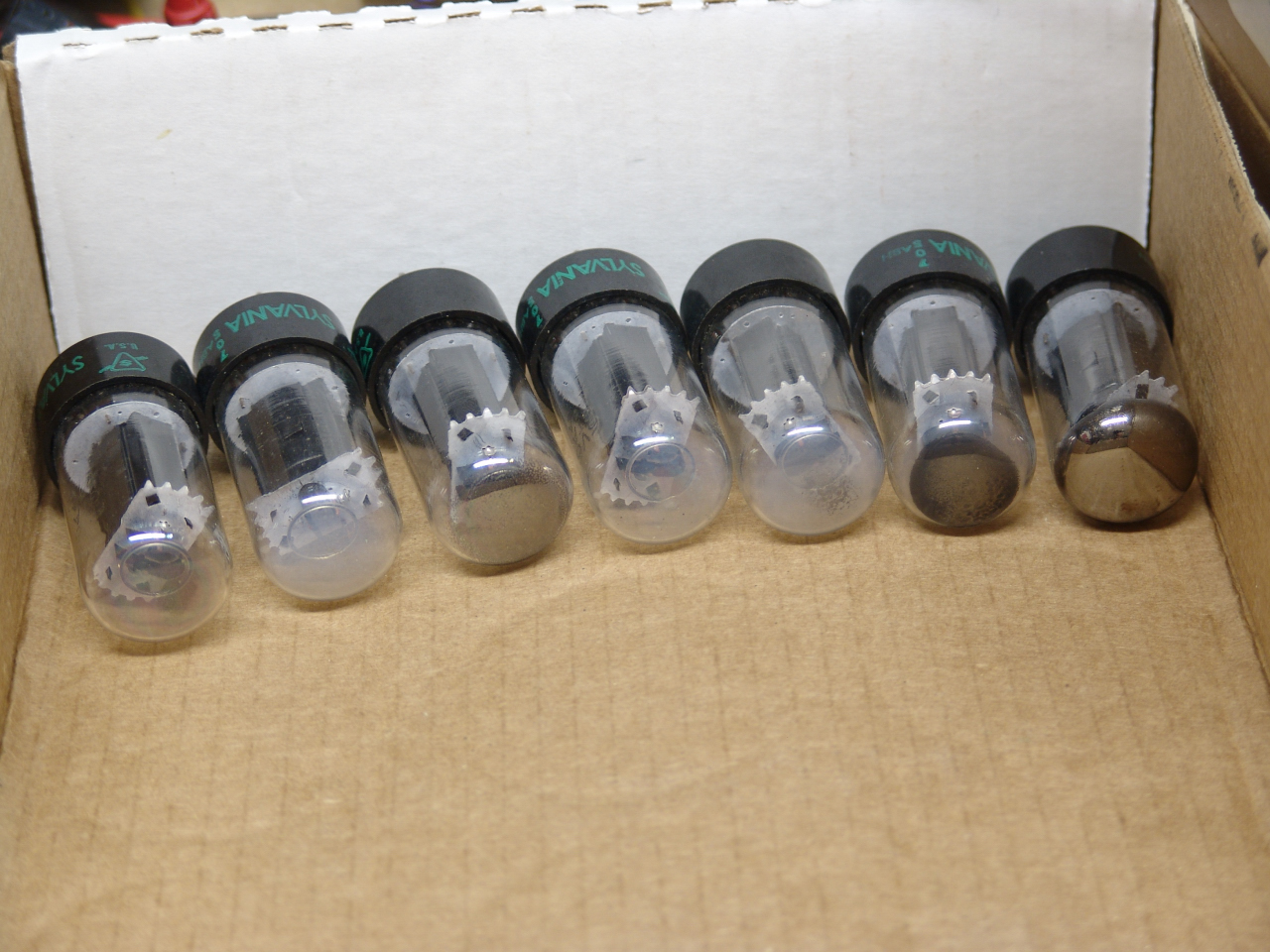

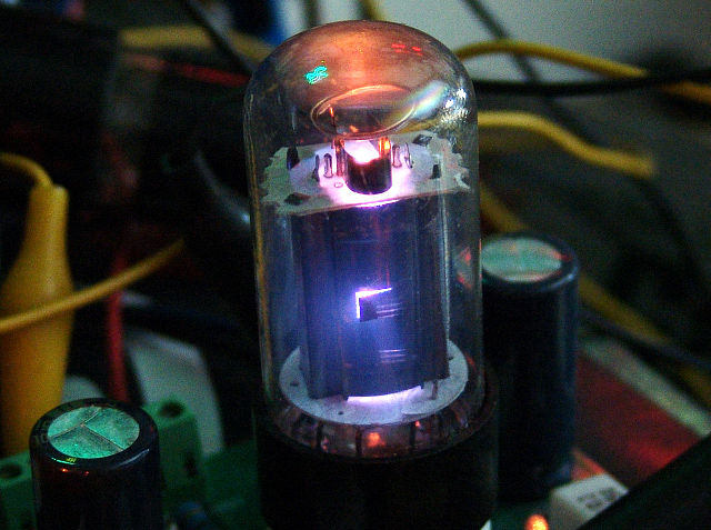

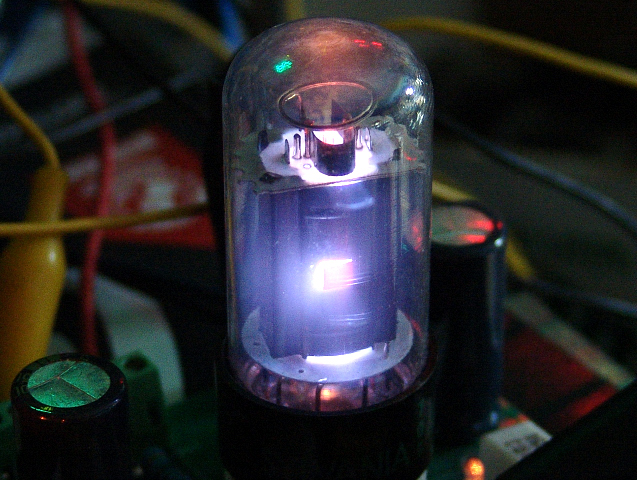

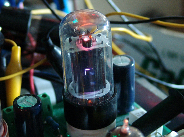

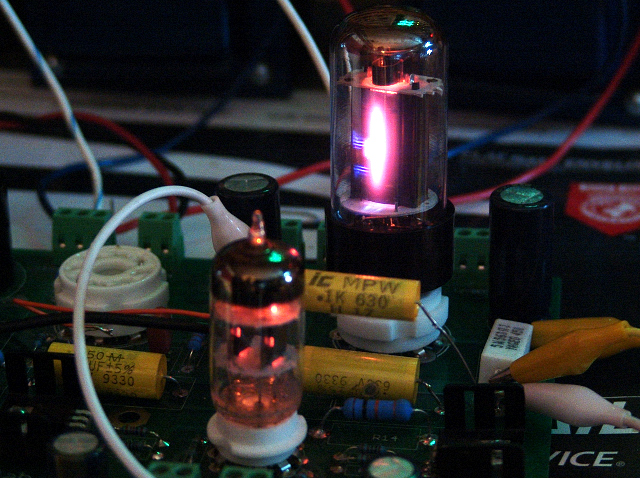

15 years or so I was at a surplus auction at a NASA maintenance facility in Florida. I bought a new, never opened bulk pack box of 100 Sylvania 6V6GTA's.
I was quite surprised to find no, white, or cloudy getters on about 20 of the 100 tubes. They were indeed bad tubes. In fact most all of the tubes had issues, or would develop them in the 15 years that I have had these tubes. I can't trust them in anything since a good one can turn bad overnight. There had to be some kind of contamination issue with them.

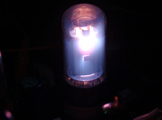

Here is a picture of 7 tubes ranging from no visible getter at all, to cloudy, to some shiny spot left. All will glow a gassy blue glow, draw excessive current and some will arc over internally. I stuck some of them in a working amp and let them play to see if some use would make them better or worse. All got worse, but the experiment ended when one arced over causing the cathode bypass cap to explode.

Ouch!
It's a pretty odd manufacturing defect though.
Yeah. The seller had stated that the filaments were OK, but that's just a fraction of the story. And I guess he checked it with a multimeter or something because if there are gasses inside the tube, the heater will consume a lot more power and the heater probably won't glow as bright as it used to.
I think unless there is no vacuum the heater will still be OK. The seller should/will have noticed the white on the top and should have binned them. They are not fit for purpose and I would ask for money back.

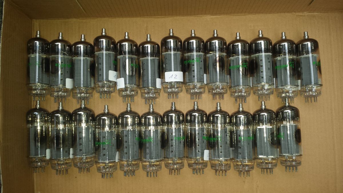

Sylvania had some quality control issues in final years of vacuum tube manufacturing. I got a large lot of NIB 35LR6's where the top taps on the plate structure were not given the bend or twist needed to hold the top mica to the plate. I plugged 4 of them into a modified version of Pete's big red board, but some serious fireworks and burnt parts occurred on power up. One of the tubes had a short between G1 and G2.
This prompted a visual inspection of all 44 tubes. Some were fine, but should not be banged around or operated upside down.....others failed the obvious visual inspection test.
The sick 6V6GTA's were older, not from the last days. There must be some kind of contamination or slow air leak associated with these tubes, and possibly the lot that that 6L6GC came from.
I had to pack up all my belongings and move 1200 miles about 6 years ago. I sold, gave away, or trashed everything that I did not want to move. I went through the remaining 6V6GTA's in that box and tested them all for THD in an SSE amp. Everything that didn't come close to some old metal 6V6's went into the trash. The rest were boxed up and moved. There was only about 20 of the original 100 tubes remaining. I haven't found that box, but when I do it will be interesting to see how many more have died.

Oh I haven't actually bought the tube. I was just browsing.
Thanks!
milky white = BaO barium oxide = oxygen got it = bad.
And that's the end of that.
It is, in a sense, why I've never become enamored by the tantalum-zirconium getters.
You can not visually inspect for vacuum loss.
