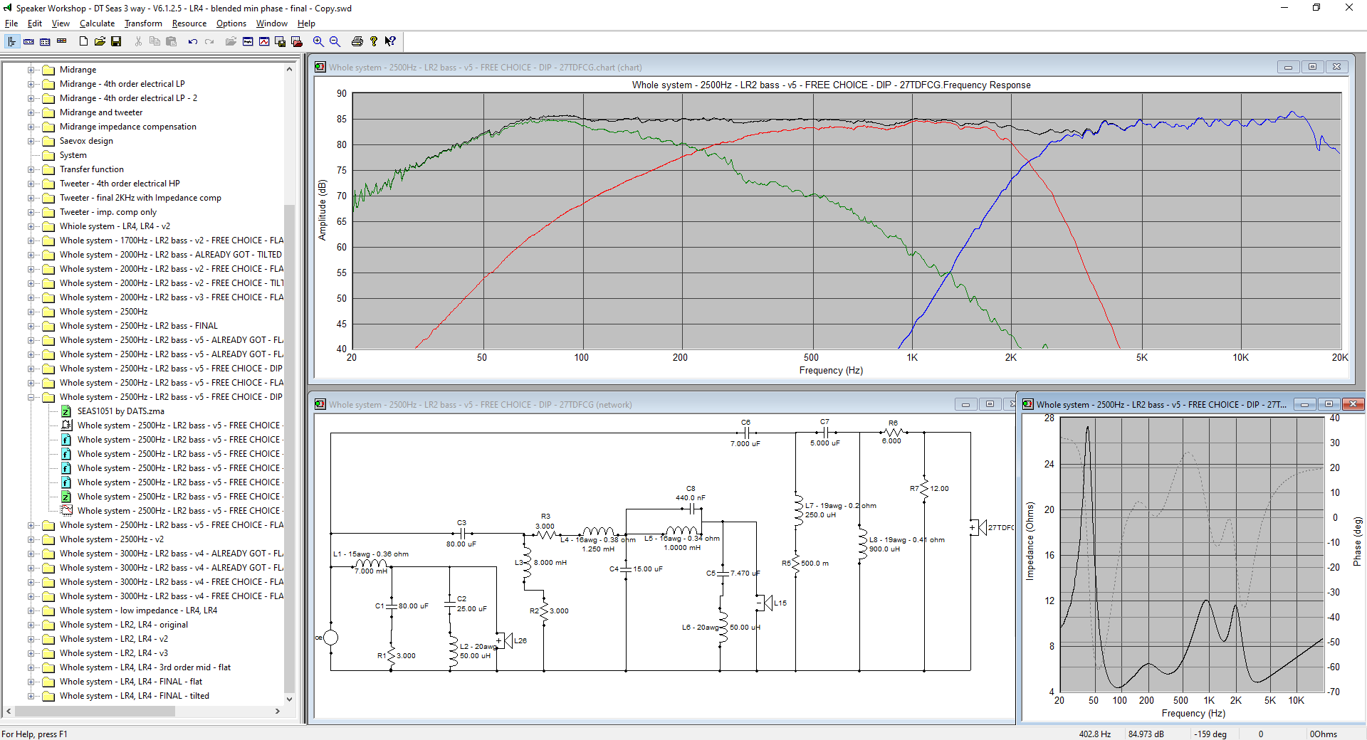

I was a Speaker Workshop user until that just wouldn't run anymore. I even recompiled the source and managed to salvage some old projects but writes would fail (even as administrator on Win10+)

As was I. I liked the way it would display multiple plots together, and could calculate differences between responses then add those to others to create target curves. For one thing I could measure my equaliser after a voicing session and add it to the current crossover plot, then modify it.
Yes. Although VCad allows you to save overlays (not quite as good as SW chart), VCad unlike SW cannot do any simple response arithmetic. I have to switch to REW for that (export / import - combine - export / import)... a bit of a hassle sometimes.
AS a bit of a throwback., here's Speaker Workshop in some of its glory:
You can't be serious, there's an entire calculator tool in VCAD dedicated to "simple response arithmetic".
