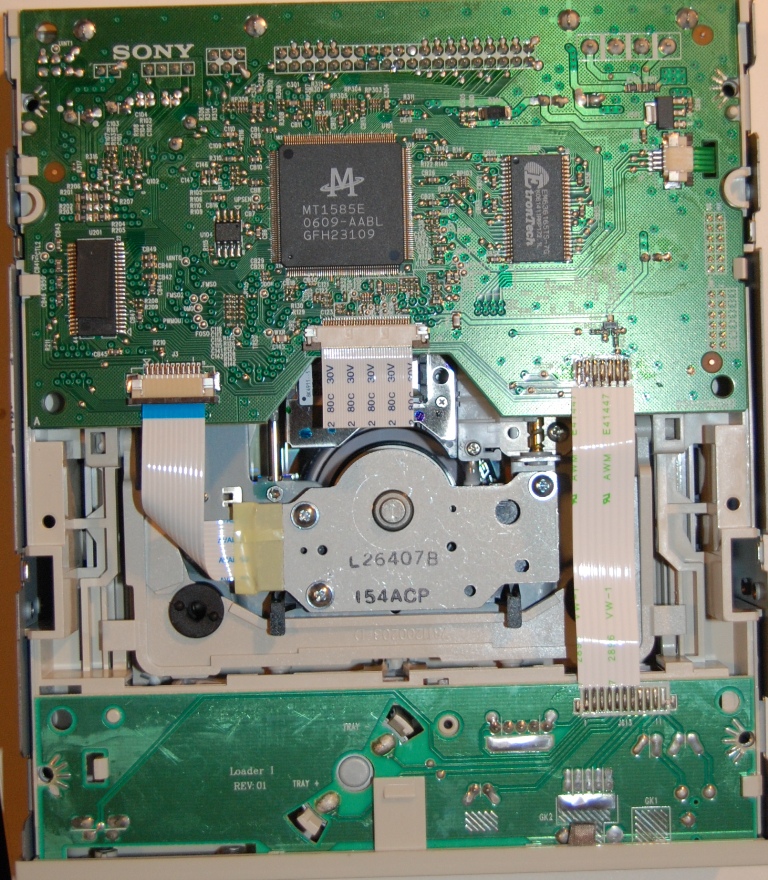

If it has an analogue output look for the dac, possibly an 8 pin device like a TDA1311 or TDA1387. You'll find what you want there.
AFAIK the I2S standard is not found on CD drives, any audio out analogue or digital (SPDIF) is handled by a general-purpose IC, in this picture the big M chip. Saves costs.
thanks... I found the link between audio out-analog and 2 pins from the big chip.

Older CDRs do have a separate DAC and you can tap the "audio interface lines". They are the same as I2S, but could be left justified, or right justified or 16 bits. I have pulled these lines from two different CDRs into an ASRC (so I didn't need the clock). But if you want straight connection to a DAC, you will have to find the clock (MCK) line. Then you will have to program/set the DAC accordingly. So look around for old PCs and pull the CDRs. The older the better.
