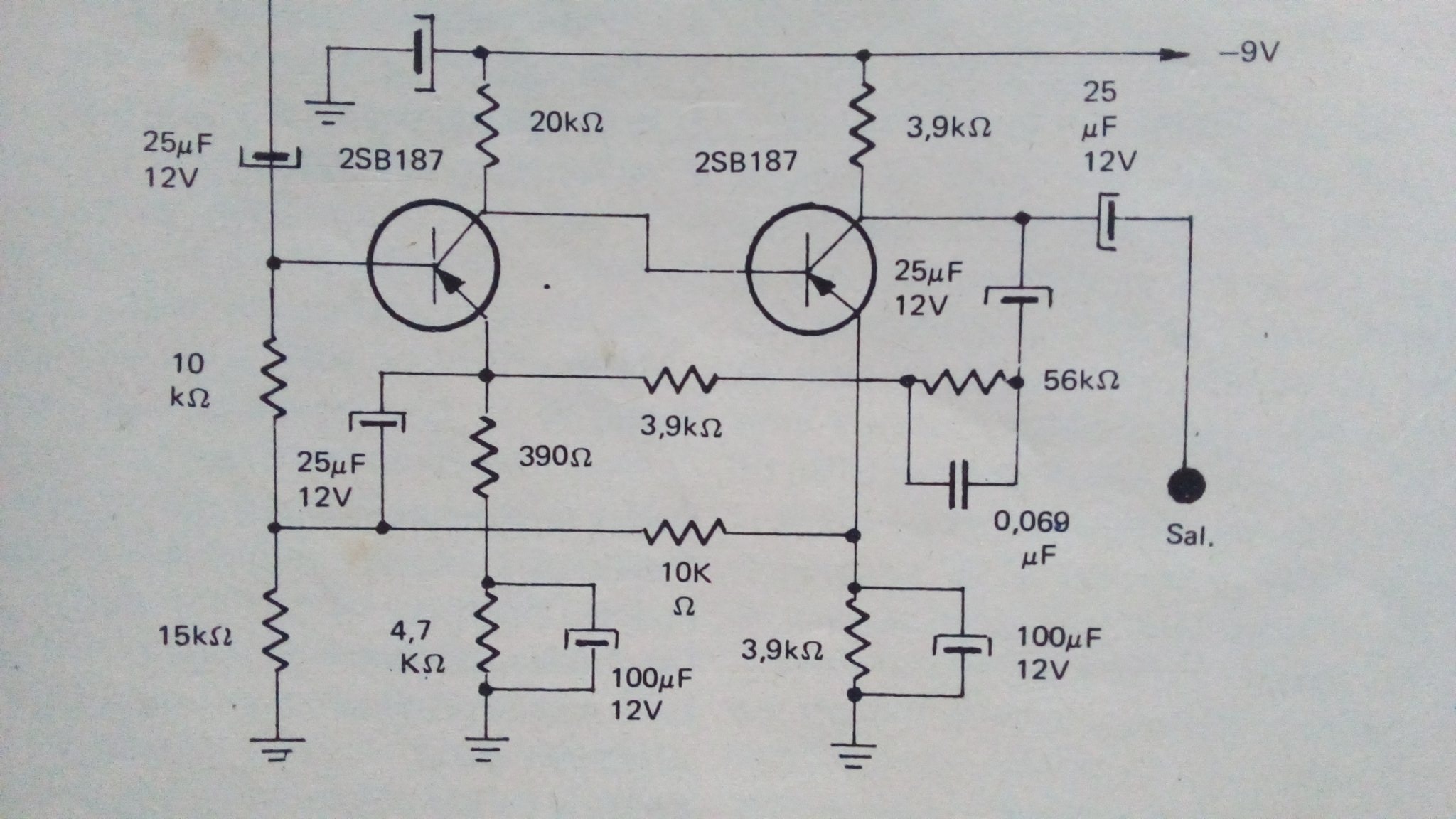

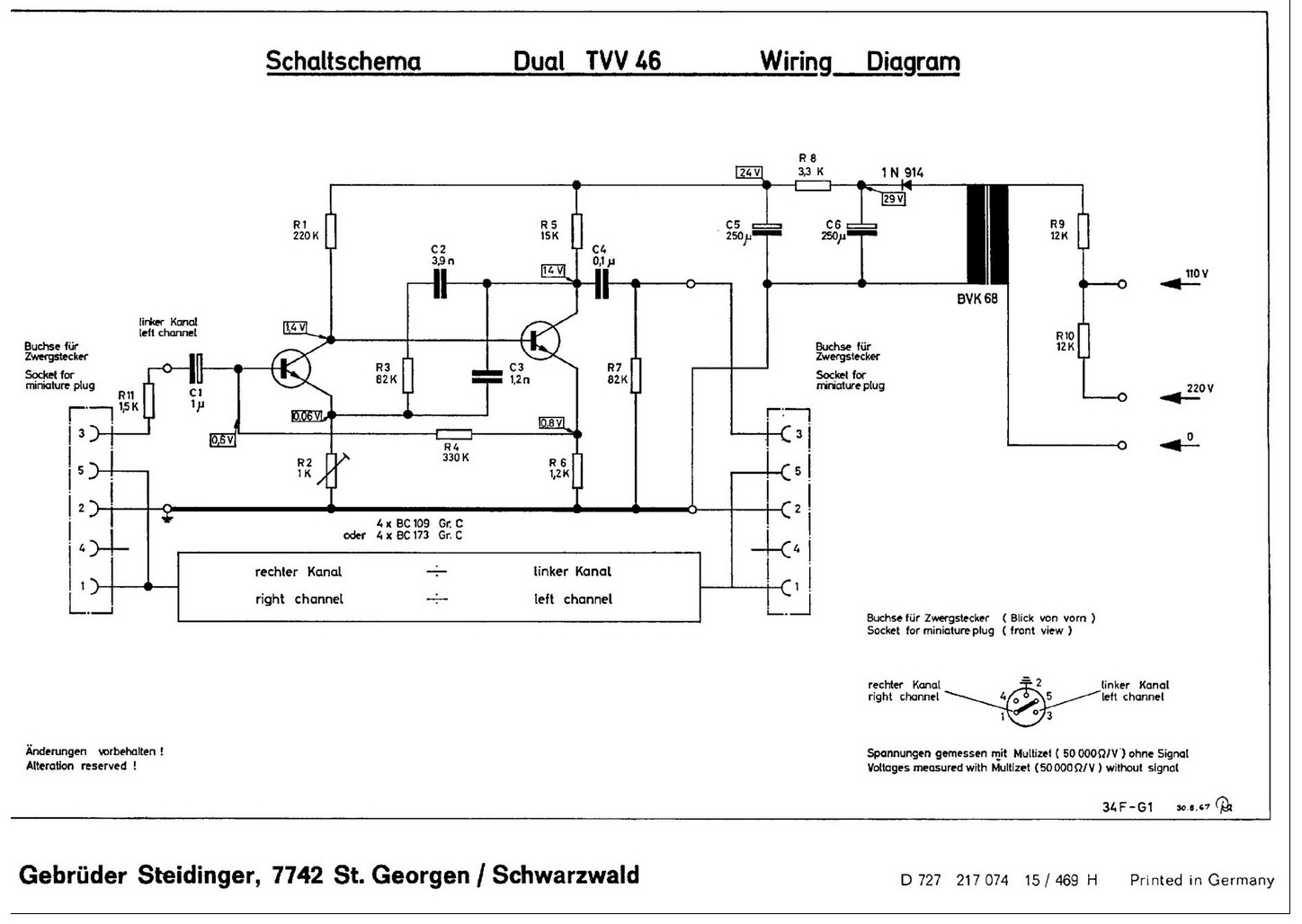

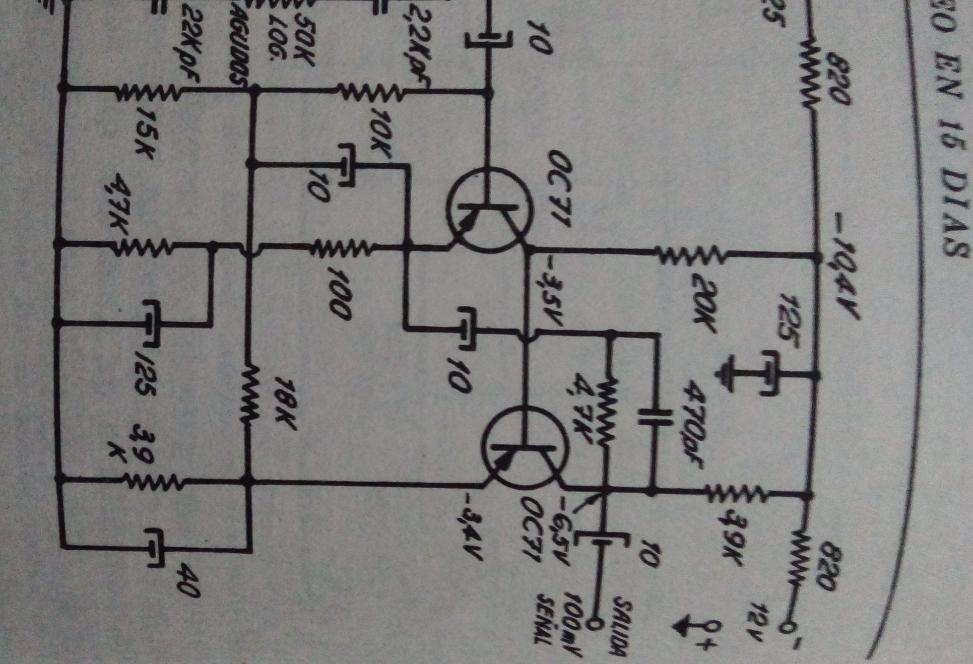

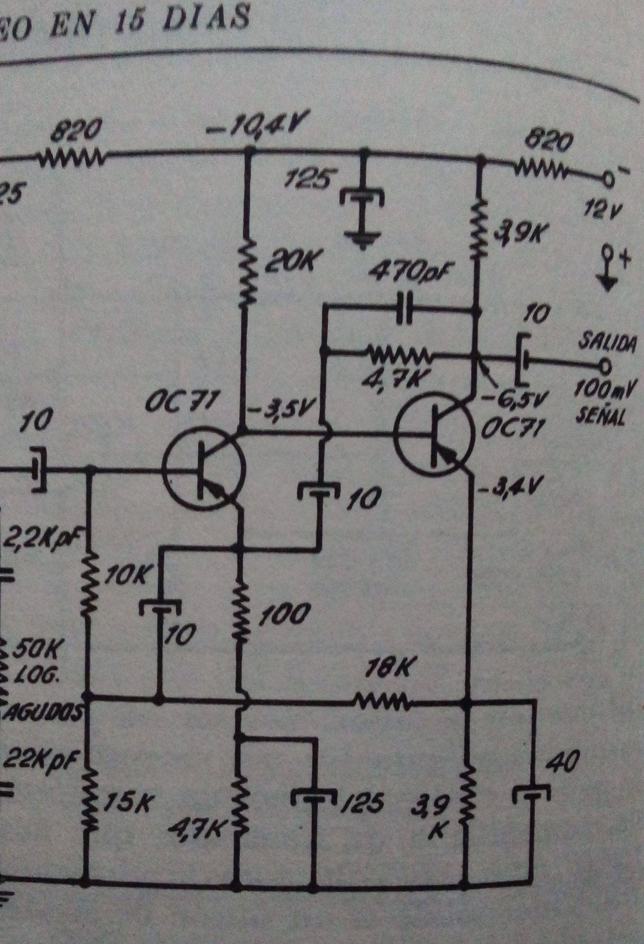

Hi all community. I found those pics in two different books from some decades ago. It's very simple: two stage germanium transistors (PNP) with the input base resistor bootstrapped and helped with NFB. IMHO too many lytics but not easily to save them.
Do anyone tryed it? Who is the creator (has a particular name)? Some other examples?
