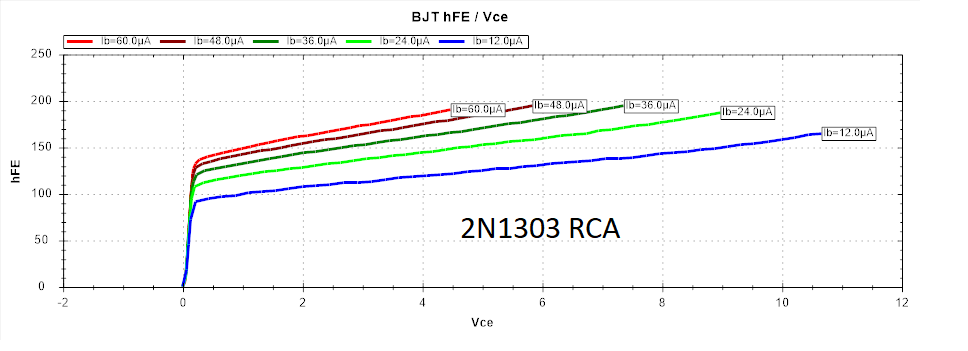

I have several Corning pH meters -- wanted them for the huge ammeter -- yesterday I pulled 5 germanium transistors off the PCB. Measured on my Leak, one has gain of almost 2,500.
These pH meters also have a pencil-tube.
Will probably just sell the transistors on EBay -- they have nice nylon standoffs!
