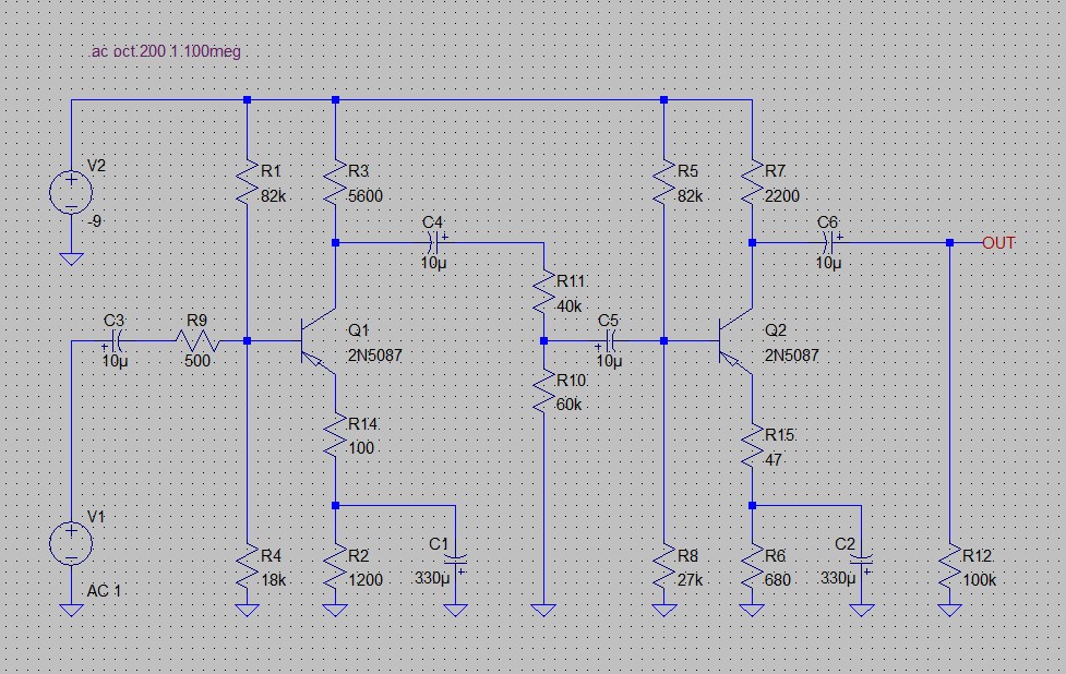

Since I've been shunned to far away lands without my usual gear I've been fooling around with some transistor-based circuits in an effort to learn and hopefully make something cool sounding.
After building some fuzzfaces and rangemasters I started 'hacking' together a schematic for a positive-ground germanium preamp. When I say 'hack', i really mean it. But, to my surprise, the dang thing works and already sounds pretty good, considering.
My current issues and questions are these:
1) The variable resistor between the two gain stages works just fine up until about 95% of maximum volume and then just squelches out until there's no volume. I tried different pot values (1k to 500k) and increasing voltage from 9v to 12v - no change.

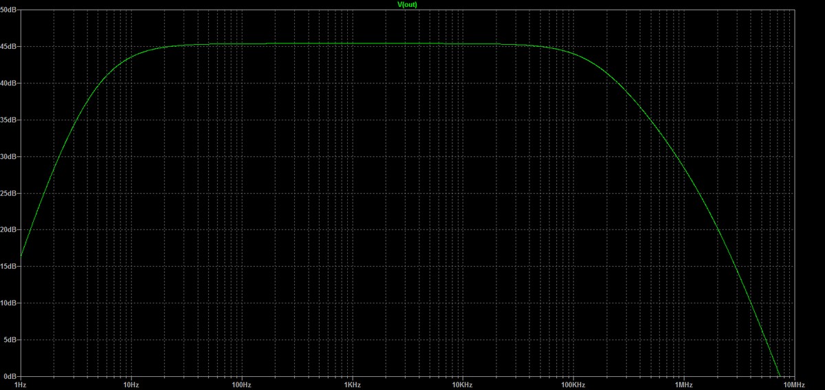

2) The frequency chart below says that this circuit is inherently dropping off pretty quickly under 200hz or so - how can I lower this? I want 80hz. (Note, I am using 2N527 transistors).
3) Since this is a total hack job, what could I do to improve it? I'm getting some good, colorful gain out of it at this point, but what are some options to try out and what have i done here that might be redundant or counter-productive?

You need a Ge model to set the DC bias points. Since you have the Ge part already working, and can observe DC voltages, there is less need to model the DC condition.
The _AC_ conditions will not be very different with hi-gain Ge or Si transistor. You CAN optimize clipping and frequency response with any modern jellybean.
Since SPICE capacitors cost ZERO, you can play with the bass response until happy. Replace one cap at a time with 100,000uFd. Does bass get better?
In this case-- not right away. The bass loss is mostly the emitter caps. Super-size one, the other is still bass-shy, and you might not notice the change of slope in the cut-band. (Especially with that puny 2.5dB scale range; look at least 20dB down.)
But wait! "Surely 100uFd is ample for 1K resistors!?" No, that's where gain picks-up. It drops-off when 100uFd equals 1/hIE or re of the transistor. At about 1mA, re is about 30 Ohms (Shockley's Law). 100uFd+30r is 55Hz. Two of those cascade is likely to be 70Hz, about like your graph.
I have real doubt you need ALL THAT gain. Even for guitar-mangle. I'd be thinking of small 50-200r resistors in series with Ce. Which also means Ce does not have to be so very big. Also raises input impedance from very-low to sorta-decent. But may mask the curvature of Ge.

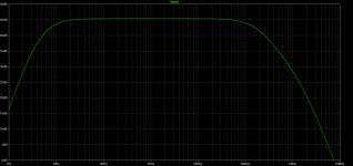

Anything more than a few hundred microfarads for the emitter bypass caps isn't going to make all that much of a difference. If you want to flatten the response you can add some degeneration. Make both caps something like 330uF, then add some non-bypassed resistance in the emitter circuits. This will bring down the overall gain, but flatten the frequency response.

by the way, i think the battery should be reversed on your schemo (positive ground)?
thanks again and will post back soon.
The voltage source is correct, it is set for -9V, so the terminal marked "+" is actually negative. You could flip it over and set it to 9V if you want, I just prefer to keep all my voltage sources oriented in the same way with + up and - down.
I ran this simulation with the germanium transistor model that jerluwoo posted earlier in this thread and I found that the low frequency response was better but high frequency response wasn't very good. I put a low value capacitor across each of the degeneration resistors (R14 & R15) and was able to get it better, I don't recall what values I used, you can experiment with different ones, something like 0.001uF to 0.1uF.
Play around with it in the simulator to see how different values affect the response, then when you build it you'll still to tweak things a bit but you'll have a better understanding of what to try.
hey Radtech,
I went back to the sim and popped in the values you had, then played around a bit with some values.
Putting those caps across R14 and 15 really did the trick on the top end. It's flat as a rail now past 20k, and only cuts about a half db by the time it reaches down to 50hz. I used 4.7nf caps. Changing R4 to 680r instead of 1.2k helped, as well.
Now to order some 330uf caps...Thank you so much!
It's showing around 60db of gain on the sim, which is a target range minimum for ribbon mics.
Question - how could I determine the input impedance?
I'm getting somewhere around 6K impedance, but I don't know exactly what circuit and transistors you are using in your simulation.
