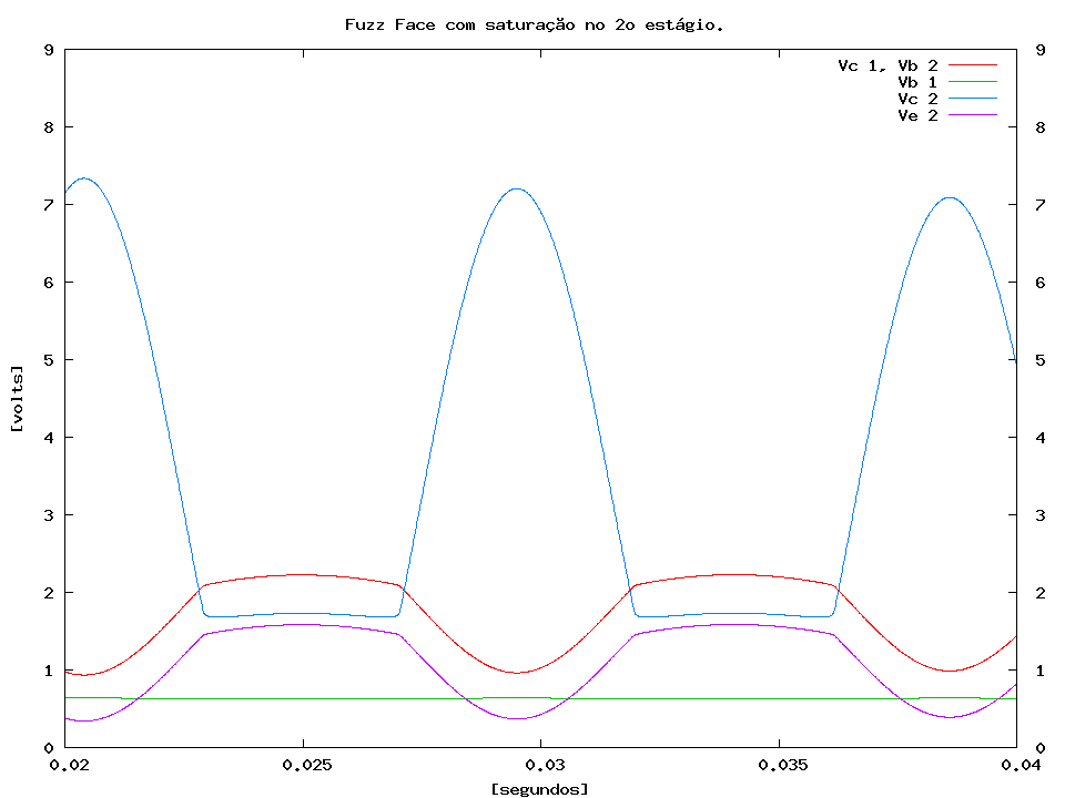

lineup, that's precisely the boy I've been studying... 😎 The curves on my last post represent this circuit working (with similar resistor values
What happens is that the first transistor is simply a linear amplifier, and the second one clips the signal, either because the transistor gets saturated, or cut, or both, getting out of the active region.
This is quite different from what I heard many times, people stating that older distortions were more "smooth", and newer circuits are more "harsh". How can the saturation and cutting of any transistor, including germanium, not be harsh!?...
I'm trying to study exactly why germanium might make a difference... I'm finding out that this circuit clips "hard", so the only difference must be internal capacitances and input / output impedances, something like this... The lower Vbe should men it would be easied to make the first transistor get reverse-polarized, but this doesn't make a difference, because the same result appears when we just saturate the second transistor.

I was trying to simulate a two-stage amplifier... Input around 10-200 mV (That's what I measured on my guitar). I changed the parameters (gain and DC current), trying to maximize the distortion, but I never reached the ultimate distortion! Just a little bit distorted... I couldn[ t figure out yet how to design how much distortion I want. and how much would be the maximum...
