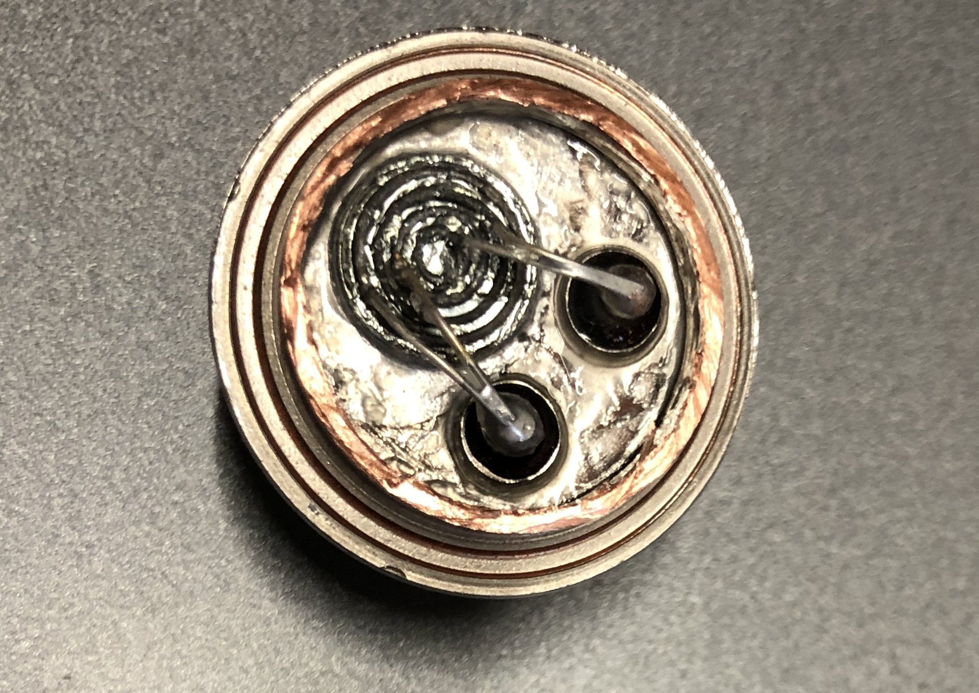

That's a good theory and explains why nothing is really visible on the scope after the breakdown. The date codes on the output transistors range from 1984 to 1990 and if you buy 10 you'll likely get 2-3 "good" ones from the batch. A buddy of mine cut open a bad one and the construction looks decent. The can is filled with some kind of clear silicone grease and the die has a blob of what feels like clear RTV over it. So my guess manufacturing impurities. The die in the pic is scratched up from scraping away the coating.
I have some AD140 transistors that don't exhibit this behavior but even after playing with the bias their THD was much higher than the soviets. Like 2-3% compared to 0.3%. Which seems odd as the Leak Stereo 30 used them.
