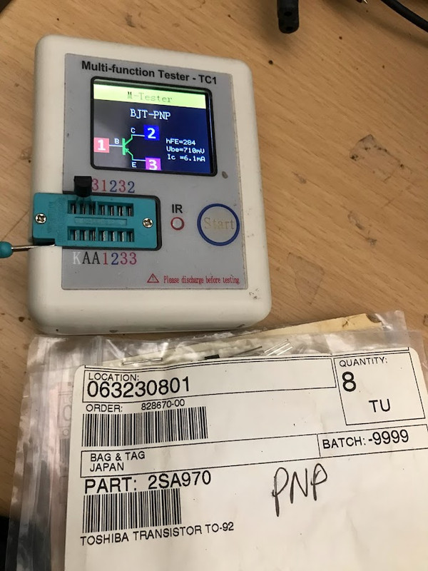

The Newark plastic baggie has a printed tag that notes: Japan and Toshiba. I'm pretty sure these are genuine. But any way be absolute sure that these are "genuine"?
I do have the ability to test them, as shown.
Check if the measured specs are according to the original datasheets if you can get those. 'Updated' datasheets can be changed, pinning as a starter. Make a simple testboard amp circuit on realistic settings/values and measure the dc/ac results (stability, beta, bode plot sweep). Just to be sure what in your bag&tag.

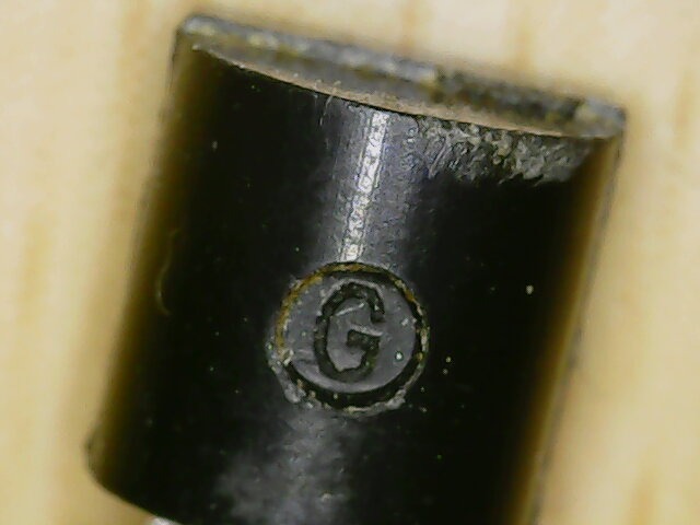

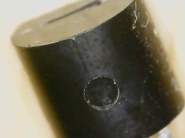

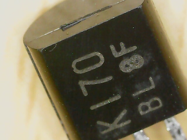

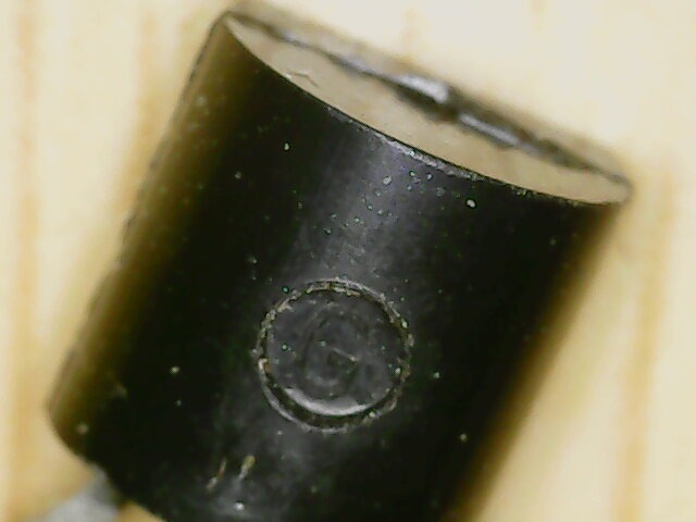

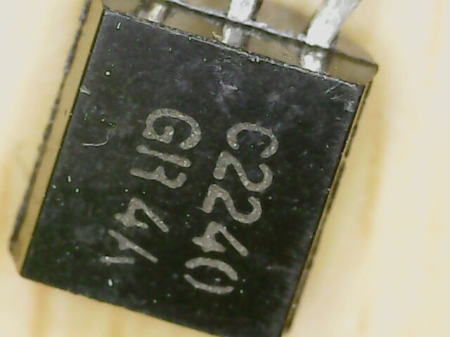

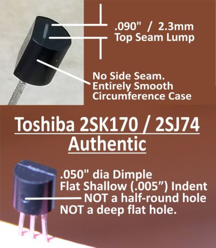

For the 2sk170/2sj74, there are some features to check for genuine.
The appearance of the font of the designation can also be used for determination. This topic has been discussed many times in the forum.
Reactions: philipsmarantz

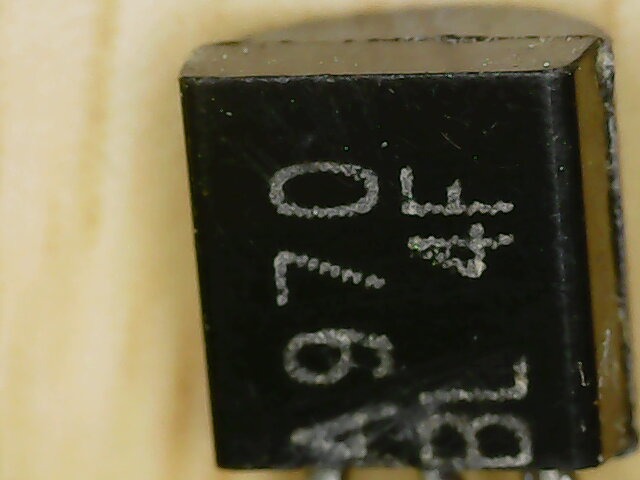

Your feedback is useful. Please see my USB microscope images of some of my inventory, and comment accordingly.
Not sure about 2240 and 970, but the K170 appears genuine.
About "This topic has been discussed many times in the forum." When making a remark such as this, be sure to provide supporting URLs and forum links to the posts/threads you may be referring to. Usually, when creating a new thread, the forum engine will suggest similar topical threads that my help in reducing duplicate topics. But that feature is often not very effective.

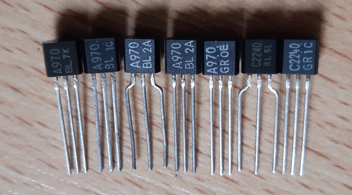

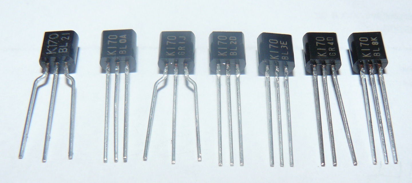

FWIW, samples from my stock purchased over the years from various (trusted) suppliers, showing both the older / printed and the newer / etched markings. Note also that the genuine Toshiba packages have a very clean finish, while the fakes are usually rough with burrs along the seams, etc.
