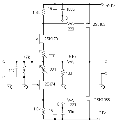

So, you are suggesting to try them in an real circuit...maybe like this regs from Kaneda ('cos I only have +30V/2A variable regulator at my disposal right now)?
http://www.diyaudio.com/forums/attachment.php?s=&postid=508975&stamp=1100036521

I would definitely use them in a power amplifier, even if they cannot compare with the devices manufactured by Hitachi. Please consider the design in post #7.
