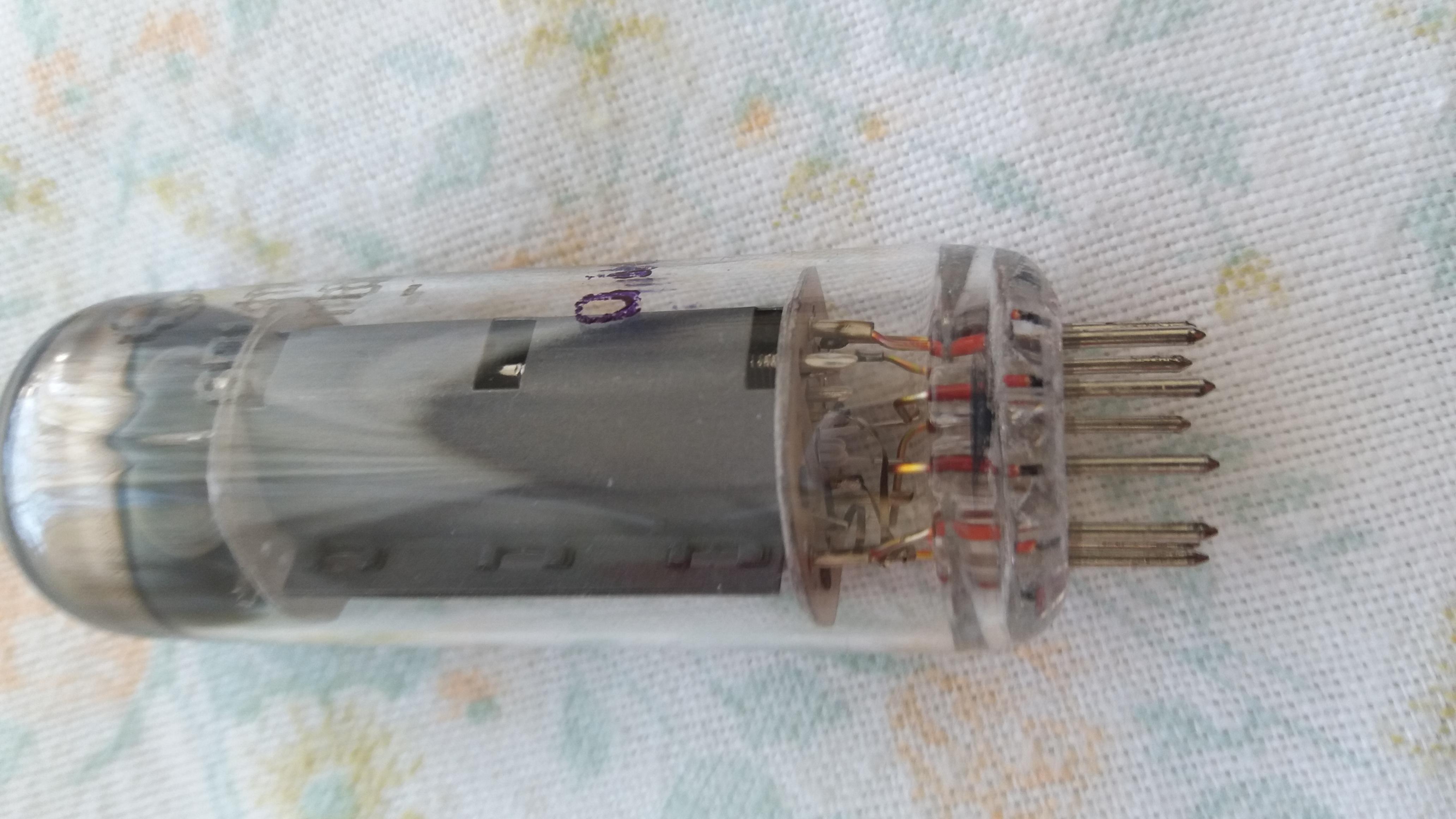

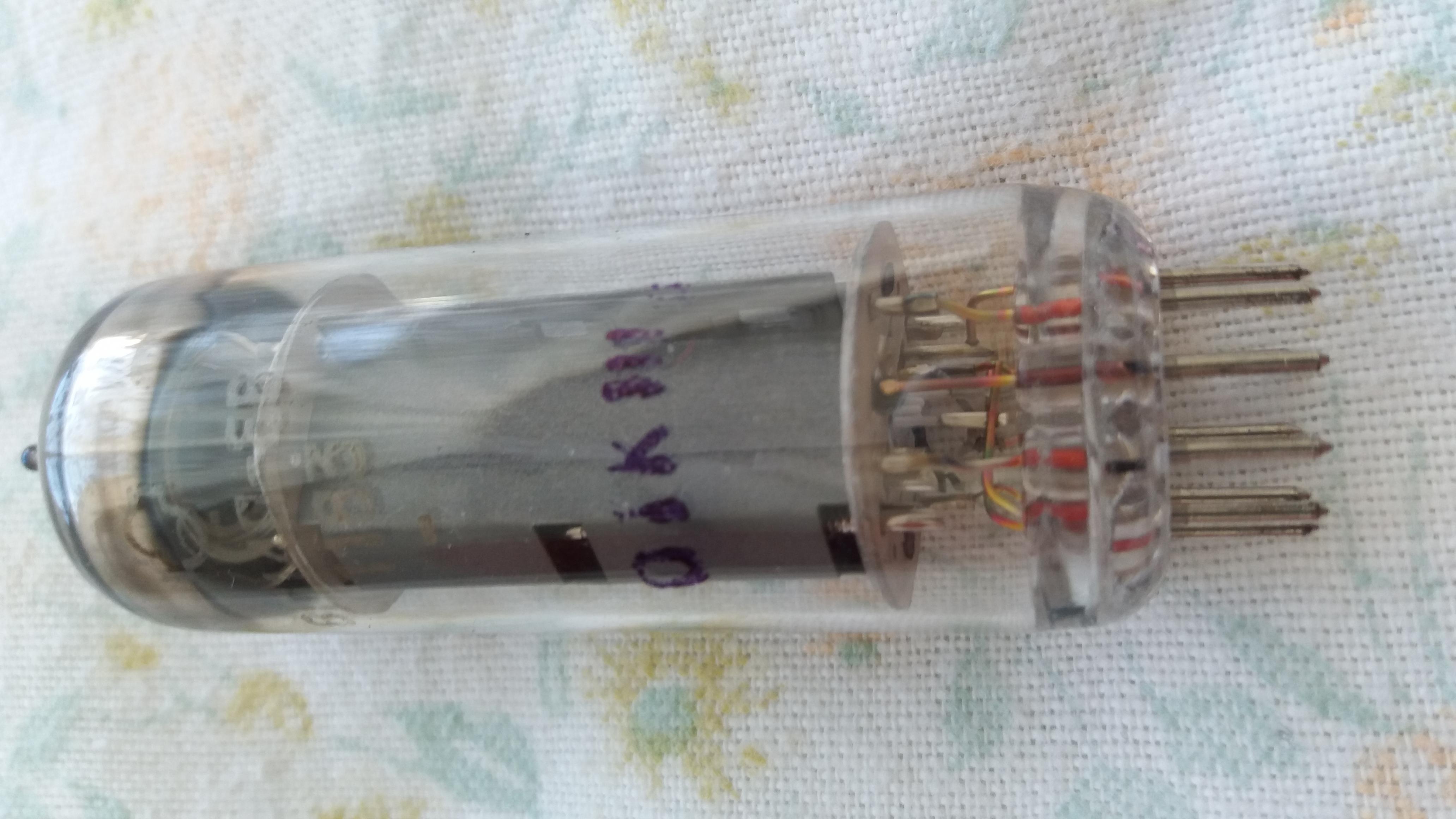

I recently picked up 20 tubes labeled 6pi14pi-eb online for a very reasonable price. I haven't plugged them into anything yet. They look quite a bit different than 6p14p-ev that I've had in the past and I just want to confirm that they are legit.
Specifically, the black (not silver mirror) getter and black markings make me wonder if they aren't just late normal 6p14p relabeled as the EB version.
Any thoughts? Are these legitimate and good quality - long life tubes? Thanks!

Visual Checking of 6П14П-ЕВ starts with looking at the Mica. The top and bottom Micas are doubled-up in the vibration-resistant grades: « B » or « EB ». That is easy to see. I just now verified this observation on a 1985 date-coded 6П14П-ЕВ sample.
Your photo looks like single-mica, but I can't see for certain. View the valve from different angles to look for two separate layers.
The markings were variable in later years, and I have certainly seen that typeface on Reflektor-made samples.

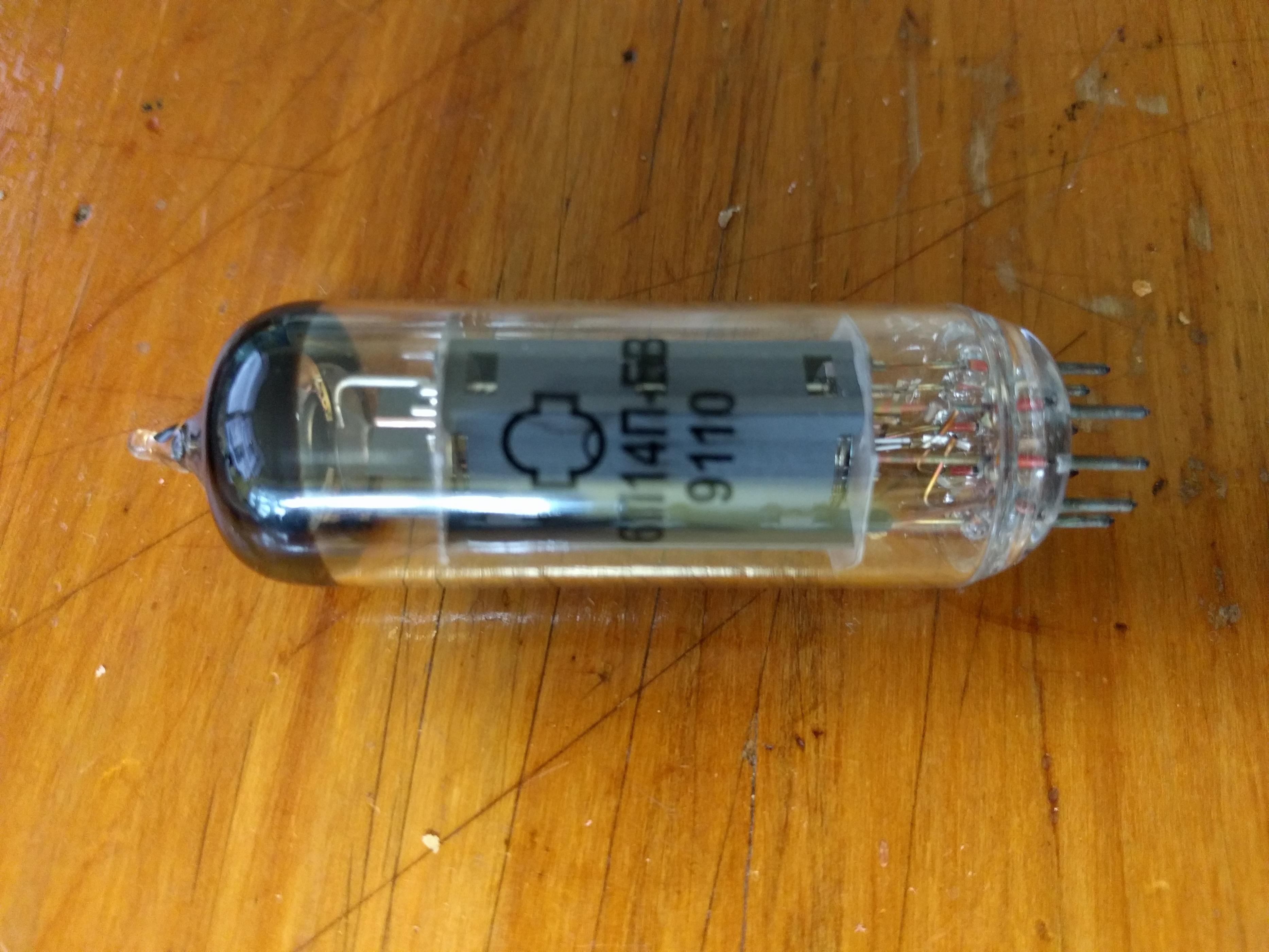

Like Rod say, 6P14P-EBhave double mica, an the shape of the getter is like this.

To me, that tubes are simple 6P14P.

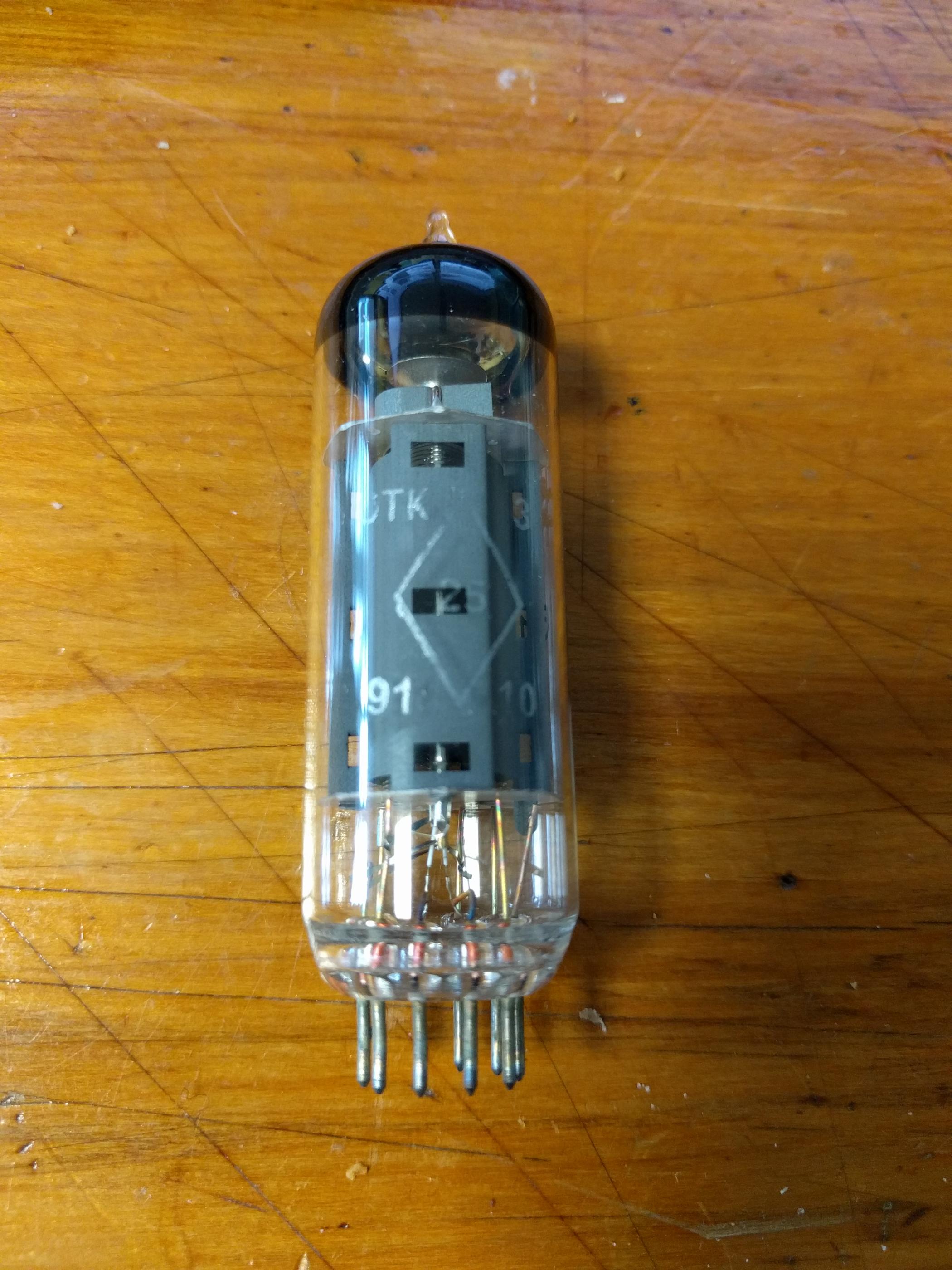

Military quality control #25 means if it was wrong the tester can go to GULAG.
A number in a diamond means military control that is not an ordinary OTK.

Tubes seems genuine, but mfg year gives questions. After 1990 (and especially 91-92 years) dont have build quality of <80s.
