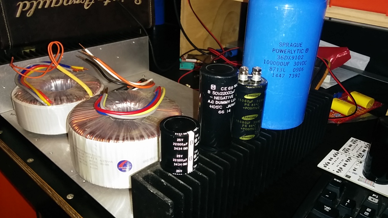

Parts to work with
One (part) chassis measuring about 345mm x 75 mm x 300 mm internal... Thinking if I add spacers then it's 87mm height internal and I get a bit of ventilation as well.
lots x bridge regulators and a few pcbs for discrete options with snubbers)
8 x 100000uF 30V very large caps (never used as they dont really fit in anything... Call it 77mm diameter though, and 143mm high)
12 x 22000uF 25V caps
12 x 22000uF 50V caps (80 mm high, but 35mm diameter, height not including solder legs)
8 x 15000uf 35V caps (screw in, 75mm total height, 35mm diameter)
Various mosfets etc for various regulator options...

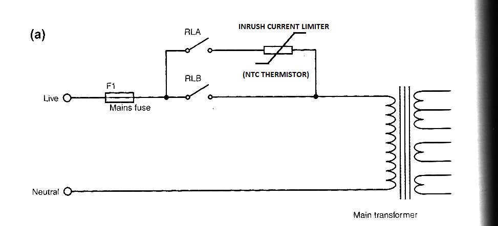

I'm doing a class A amplifier power supply, and for what it's worth, I've decided to add a few things "while I've got the hood up" that aren't always included:
edit- sorry, "hood" is US car slang for "bonnet"; it gives access to the engine compartment
_
- mains DC blocker (HERE is one reference among many) since my transformer is a 500 VA toroid
- inrush current limiter using Ametherm SL22-40005 NTC device
- bypass relay which shorts out the inrush current limiter xxx milliseconds after power-on ("RLB" in attached image)
- output muting relay which keeps the speakers disconnected from the amplifier for the first yyy msec after power-on

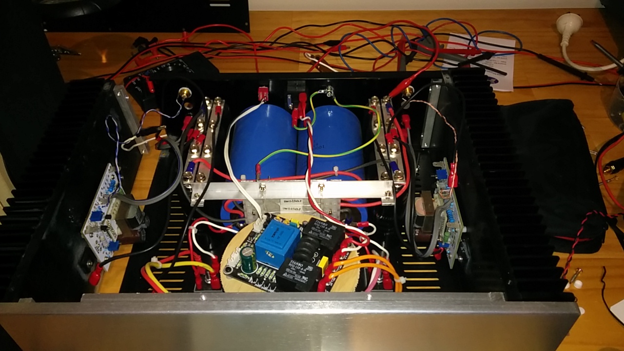

@Mark - noted! I can't help but consider the enormous amount of space in each amp chassis that wont be filled by caps and xformers... and think about the different ways I can awkwardly fill the space instead...
Pictured is the F6 build I filled to the brim... :facepalm: And I didn't get the speaker protect in in the end.
