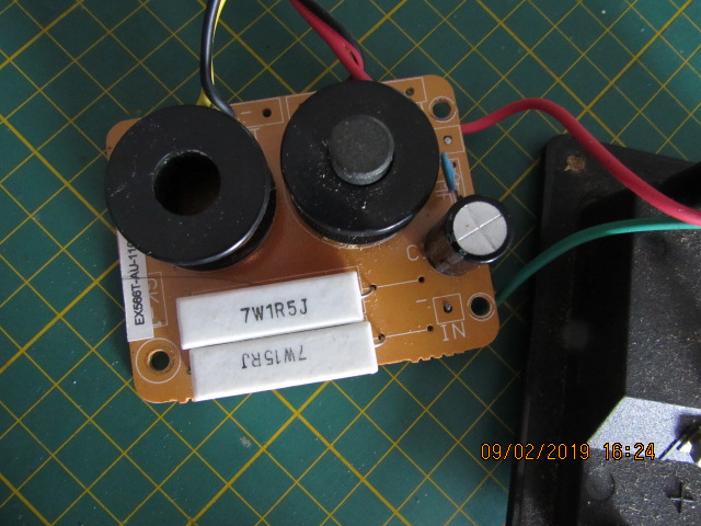

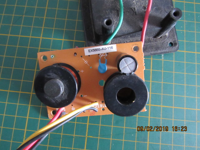

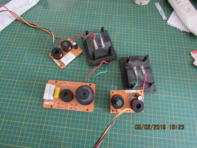

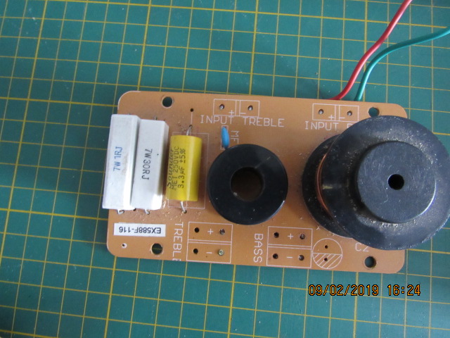

So here are pix of 3 Sansui crossovers.
While one is larger the difference is this is using an aircore coil and not the ferro
Apart from changing the cheap electrolytic for something better I have thought about gently turning the small aircore around to be at 90degrees to the other.
