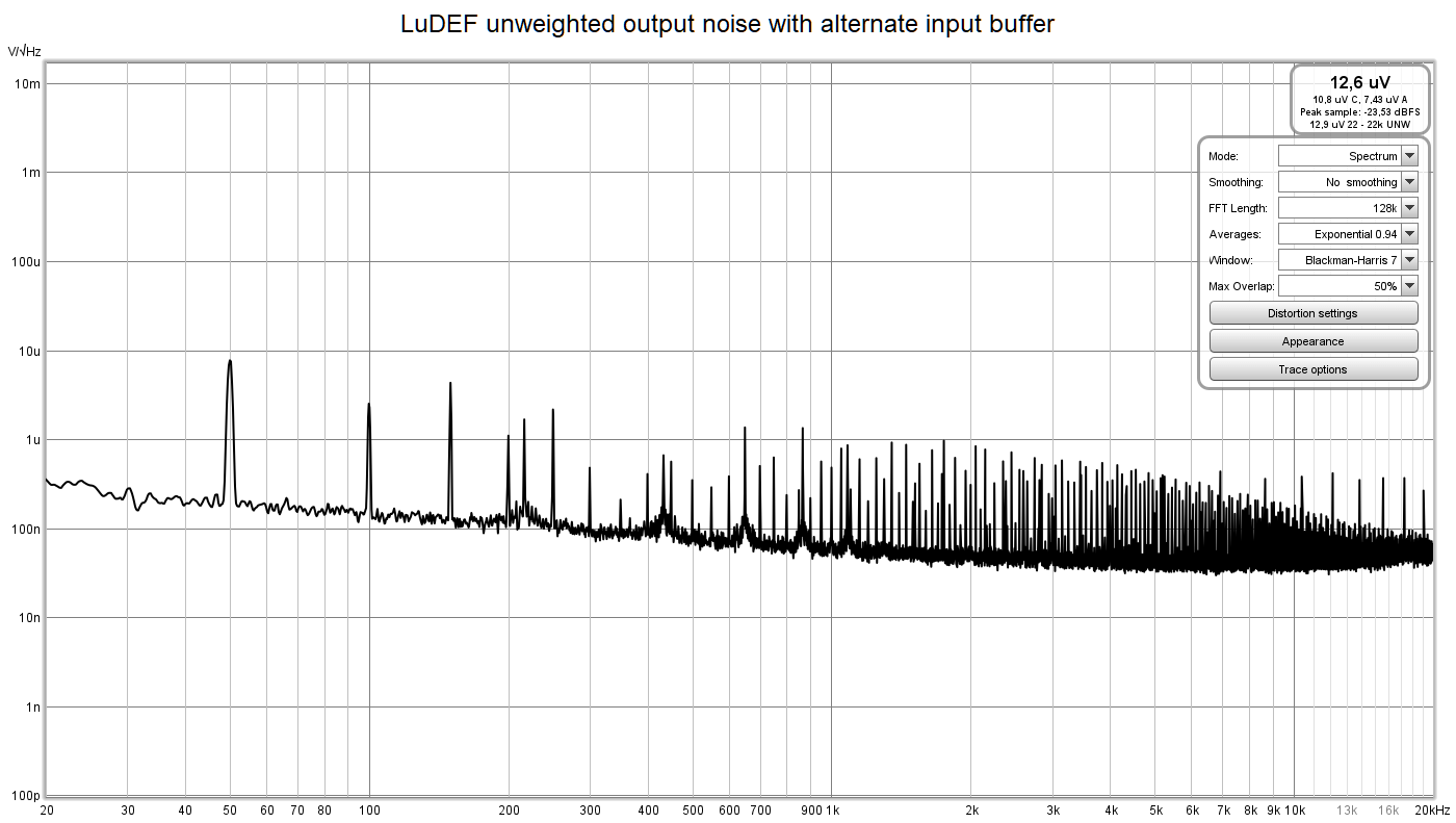

Thanks for that spectrum from a 50Hz AC mains, which appears to be DOMINATED by those 50Hz-100Hz harmonics at least to 1kHz. Every spike sits on a 50Hz multiple. So squish that 50Hz, and the rest goes down along with it. KISS.Measured noise at amplifier output, doesn’t consist only of 100 or 120 Hz ripple, which we hear as hum. Measured total value, consists of summed contribution of various noise peaks (harmonics of main 100/120 Hz ripple, various electromagnetic interference and base circuit noise) over the whole audio frequency band. Here is an example of measured noise spectrum and total amount, at one amplifier output.

FFT graph I posted is good example how high measurement resolution and graph scale can lead to impression that there is anything left to improve. Notice that measured levels, are in the single digit uV range. What would be benefit for a power amplifier to have supply with 2 uV of 100 Hz ripple, compared to 10 uV? That 10 uV is 109 dB below voltage required for 1 W at 8Ω load. Other questions are where that uV range ripple comes from, is it really there or is this EMI pickup by measurement gear or dirty ground is to be blamed.

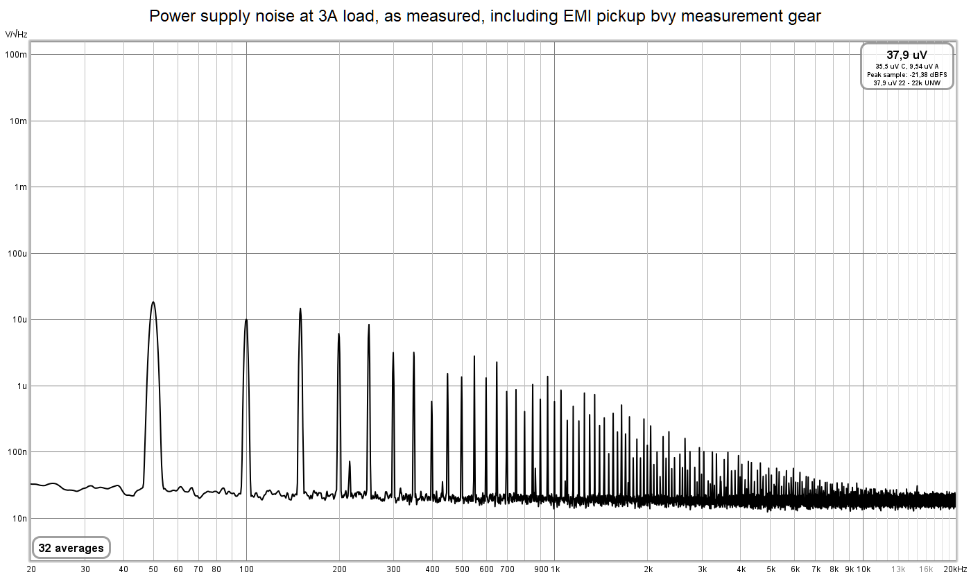

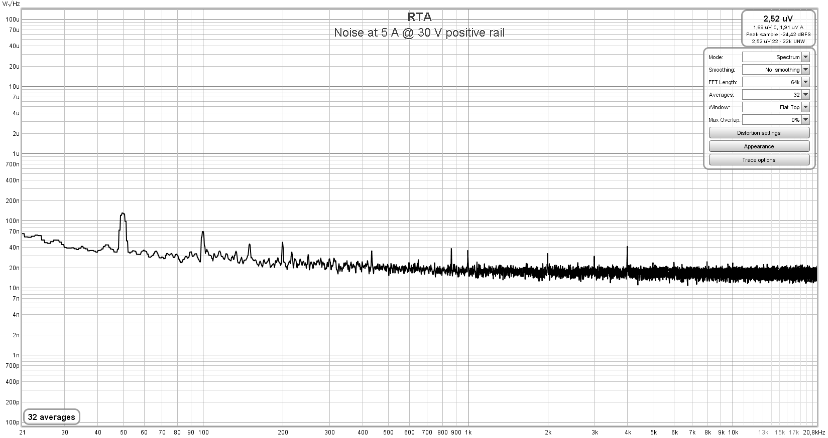

Let’s follow the trail of measurement to see if we can come to some conclusion. Measurements were taken on my amplifier which has Jung type super regulators. Regulator noise is around 2.5 uV total if measured on the bench, with no transformers in vicinity, as shown:
Measured regulator PSRR is 106 dB at 100 Hz. At 3 A load, I have 245 mV rms ripple before regulator. Regulator should pass to his output only 1.23 uV of 100 Hz ripple. However, measured rail on the FFT graph below, has 10 uV ripple at 100 Hz and there is 50 Hz as well. Where those come from?
There are two sources. First is EMI pickup by measurement equipment. Despite having all shielded and using coaxial cables, at such low levels, gear can pickup an odd uV from power transformer. It is enough that I just switch on power bar with no load, several meters apart and measurement FFT graph will jump at 50 Hz to 0.1 uV level, so transformer will add more.
Amplifier case has steel base. Power transformer 50 Hz stray field propagates though this steel plate and induces small voltages at PS PCB tracks and all amplifier grounding wires. So, ground reference used for measurements is actually floating by microvolts and affecting regulator output and measured values. Induced 50 Hz is also adding harmonics, first being 100 Hz.
Comparing rail noise to amplifier output, we can see that rail values are not the same as amplifier output. Amplifier is reducing rail ripple and noise at his output, but has other sources of 50 Hz noise and related harmonics. Amplifier PCB tracks and input signal cable are also picking some of transformer 50 Hz stray field. And, I have additional source: input transformer used as voltage amplification stage. This transformer is directly picking 50 Hz and inserting this as signal (with all harmonics) to amplification chain. I could add shielding to input signal line transformers, but there is no reason as noise levels are ridiculously low.
Based on all this, I have my conclusion on do I need to make any improvement on power supply. I leave it to you to make your own conclusions that may differ from mine. 😀
