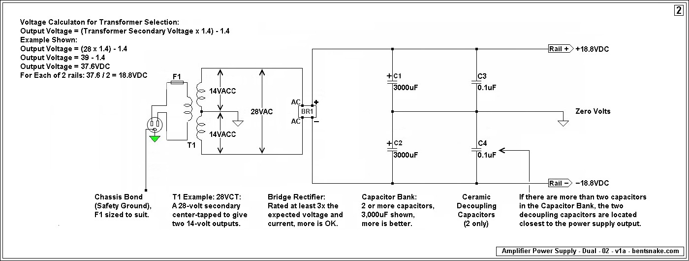

Transformer Selection
Before you can buy anything, you have to decide what you need...dah.
Decide what wattage you want from your amp. Assume 50 watts.
Multiply this by whatever "power supplies have to be bigger" factor you wish. I suggest 3, in which case you're looking at 150 watts.
Use the rule of thumb that watts = volts x amps = VA, so 150 watts becomes a 150VA transformer. So that's a done dealie, you need a 150VA transformer. But you also need to specify voltage.
Use the information in the data sheet to see what voltage will give you the power output you want. For the LM3886 this is about +/- 38VDC.
Multiply this voltage by 0.707. I'll explain why below, but for now just do it.
38 volts x 0.707 = 27 volts. But both positive and negative voltages are needed, so double that to 54 volts.
And this is the transformer you need. A 150VA center-tapped (for + and -) transformer with a secondary voltage of 54 volts. There might or might not be a transformer rated at exactly that, you always have to fudge these things.
Note: Transformers are listed by their total voltage output, not by the center-tap voltage.
Explaining that 0.707:
Catalogs list RMS (root mean square) voltage, which is exactly the voltage you've heard about all your life.
But AC rectifies into DC at the AC's peak voltage, which is higher than RMS voltage. Don't worry, there are multipliers that take care of this RMS-peak problem.
The multipliers are 1.4, and 0.707. The 0.707 multiplier is the inverse of 1.4, but you don't really care about that. The formulas are:
Transformer AC secondary voltage x 1.4 = rectified DC voltage out.
Required rectified DC voltage x 0.707 = required transformer AC secondary voltage.
Additionally, you subtract 1.4 volts from the total DC output because the rectifier diodes eat that.
If you want a fuller understanding of all this, well, off you go to engineering school. I recommend Georgia Tech, because the ramblin' wrecks have a great fight song.

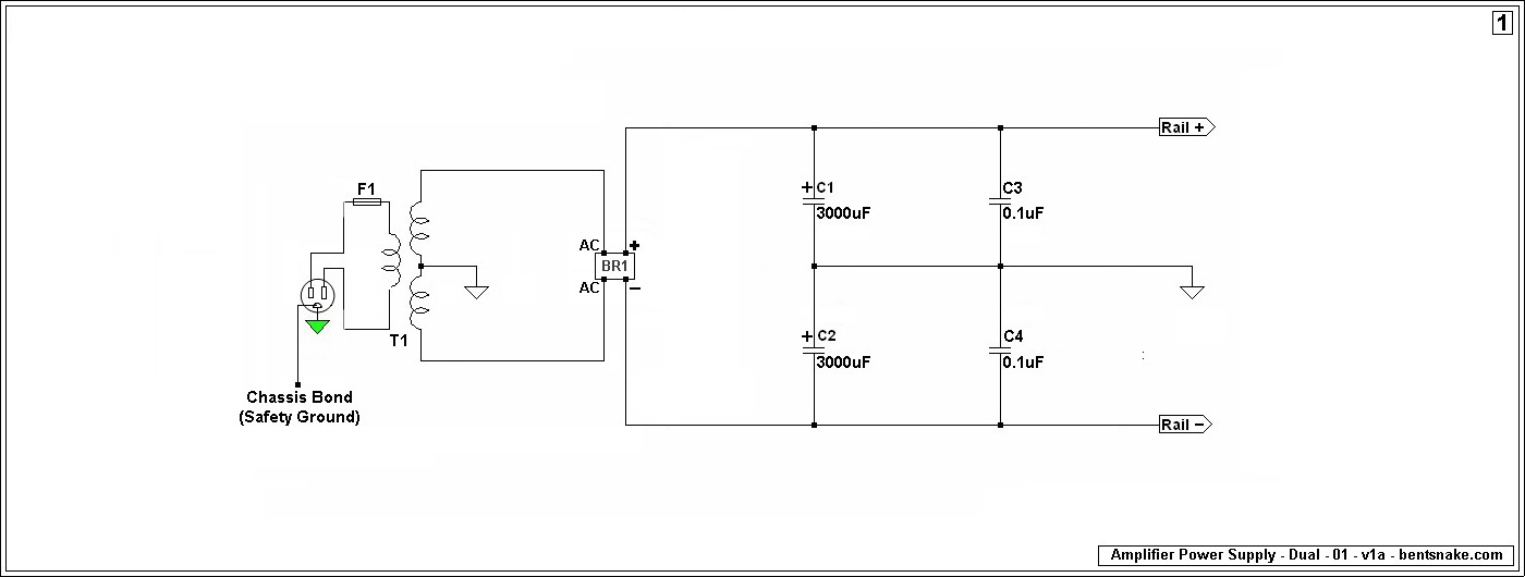

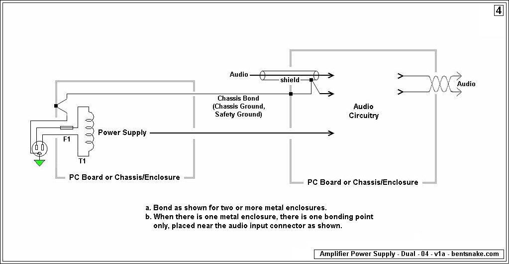

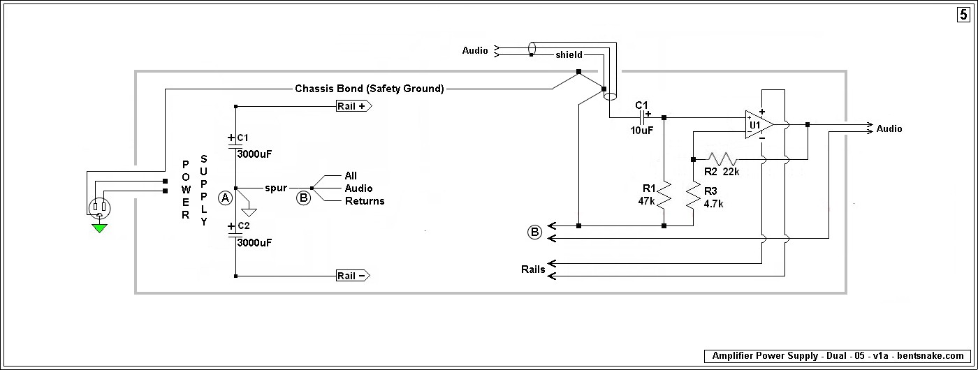

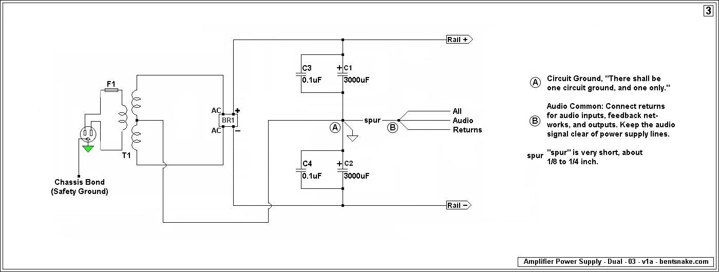

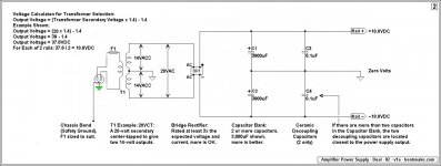

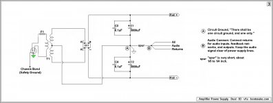

If I can't help with the transformer, I can with the circuitry, I hope. As posted below.
Figure 1 is simply the usual schematic for a power supply. You're supposed to look at it and think hey, what's the dealie, anybody can build this--which is true, but you do have to sail with care when in uncharted waters.
Figure 2 is the same (literally) circuit, but with notes added that I hope are self-explanatory.
Figure 3 is electrically identical to the first two, but real-world wiring is shown.
Figure 4 shows the chassis bond. This is also called chassis ground, safety ground, and who knows what other made-up names. I insist on calling it a bond because that's the correct term.
Figure 5 brings everything together, showing how the audio circuit connects to the power supply--or so I like to think.
Just to mention it, I'm not making any of this up. These are as suggested by audio gurus of serious reputation.
However, I don't present any of this as "the way you do it." You might expect that power supplies and grounding would be mature technology, with all issues long since settled. But this is partly true, and mostly not. There are different opinions, so take it all for what it's worth to you.
Importantly, I should add that what I'm presenting here is the Cadillac--for you I guess BMW--way of doing things. In contrast, when building just a small preamp or similar, it's not uncommon to just hook all the grounds/commons/returns together in the way that's most convenient. This is the "ground bus" method, and it's likely to work just fine.
But you're dealing with what in audio terms is some pretty significant power, so I suggest going the extra mile.
