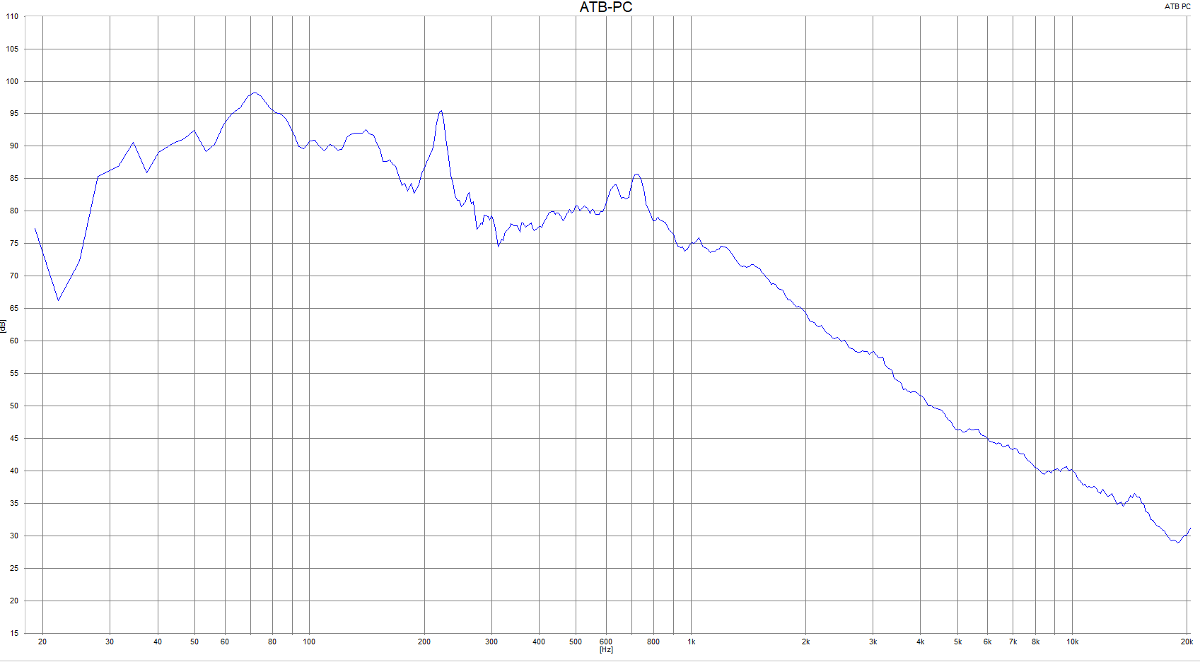

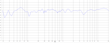

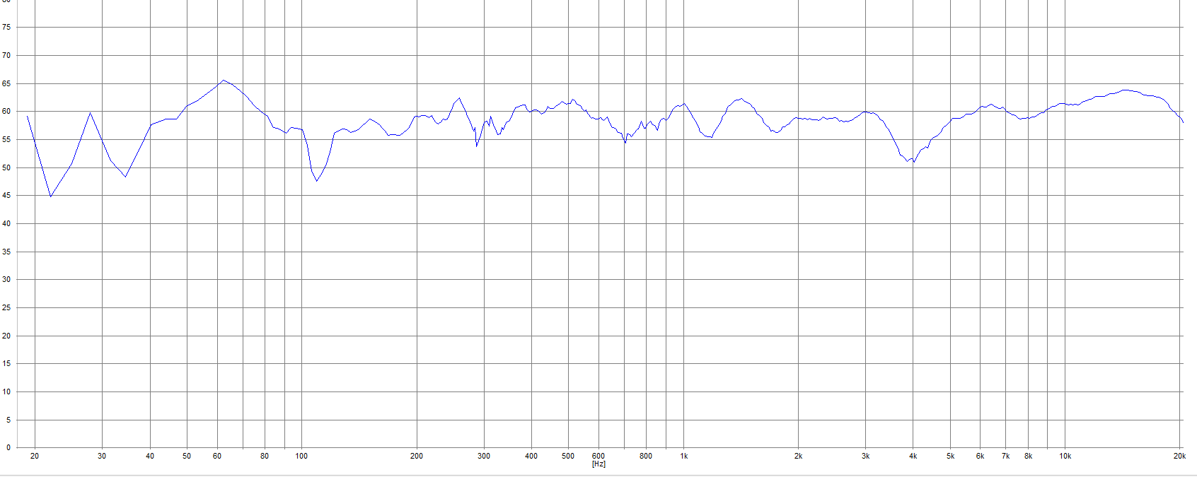

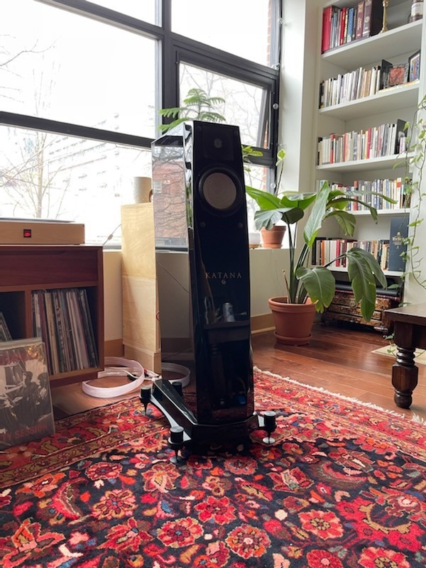

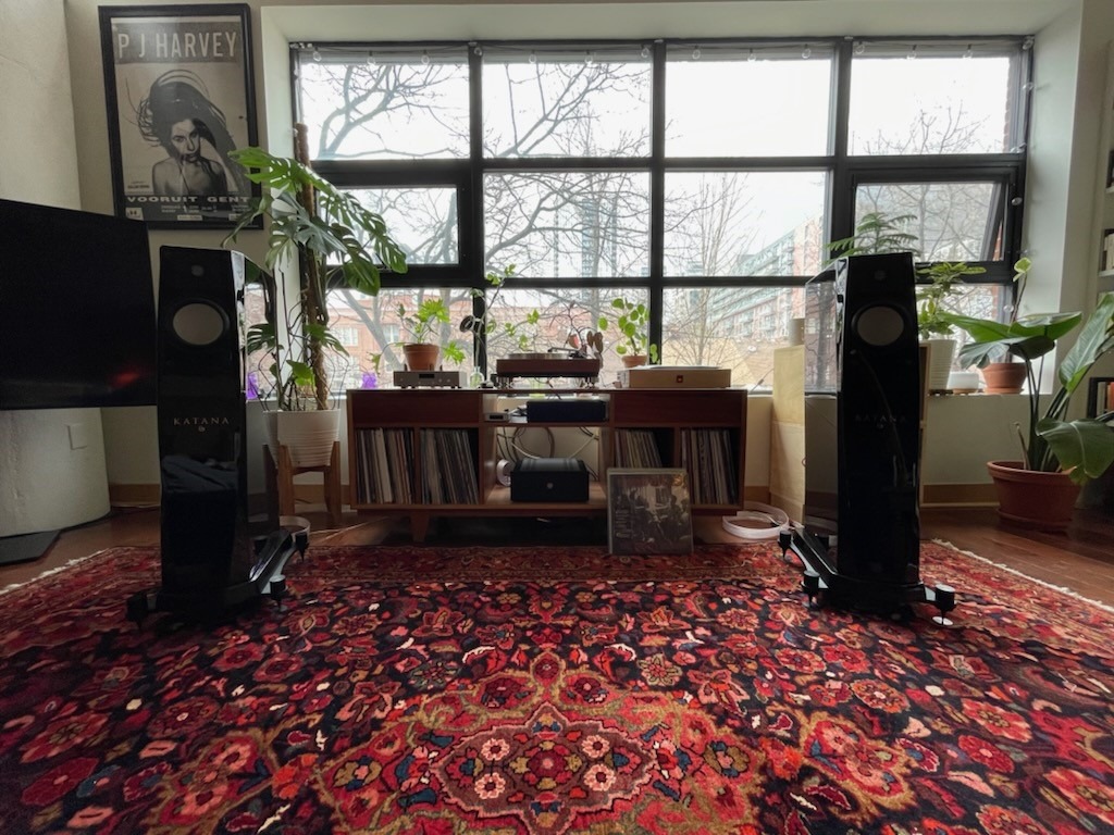

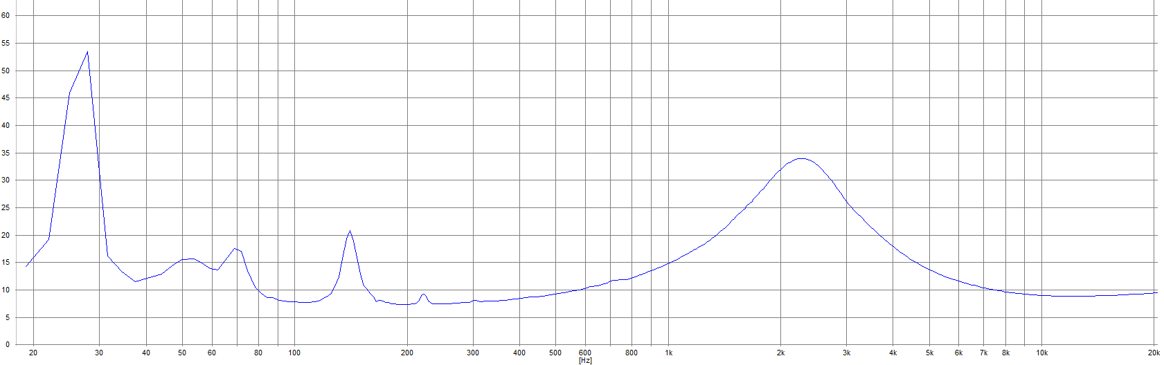

Revealing speaker. Subjectively well integrated but there is a dip at the crossover frequency at 2M on axis. Tilting the speaker removes the dip but creates a depression on either side of it. The bass is not great, not the most dynamic and not free from coloration.

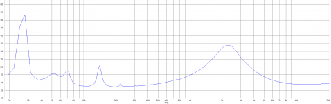

The dip in at 60hz on impedance plot is strange to me. Appears like a leaky box that I've seen in my experiments. What is the tuning frequency? Are they MLTL or? The rear port location is around the mid height position.
