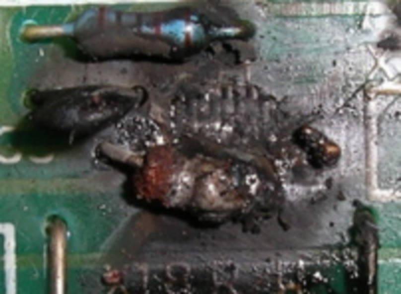

One of the channels on my Gemini XPM-900 has stopped working recently, so i whipped the top off to find this: 😱
It's just behind the red cable in the middle at the top:
Now, to me it looks like a toasted resistor, but I haven't seem that many burnt things, so maybe someone here would be able to tell?
Also, has anyone got any idea's what caused this and how to fix it? Also, whats the best way of cleaning the black crap off?

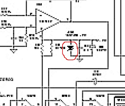

It looks like the op-amp that handles the balanced inputs has gone up, and at a guess, those resistors are part of the regulator circuit that power the opamp.

To determine if youve got further damage I would remove the blown parts and then try to power on the amp using a series lightbulb. The unbalanced input may still work just fine.
Can you make out the type no of the I/C . Use cotton buds and WD40 initially to clean P.C.B, then use buds and Iso. Can't really make out circuit, but the Op-Amps on left of diagram look like fed from simple series res and zener, no current capability there, the bottom I/C looks to be fed direct of it's own unreg supply ? .Is it this one ? Had another squint, is it the resistor to pin 8 +supply ? If it is would advise change all components on that line e.g rectifier, smoothing, caps filter caps and the zeners. Were you working on it at the time, it's very weird.

That doesn't look good :hot:
The resistor just below the opamp seem to be OK (just got a little burned) but the opamp looks to have cracked...
Try to wipe some of the burned away from the PCB. Maybe it's possible to see/guess what component went up in smoke...
Ok, I wiped some of the black stuff off, and here's another pic. The opamp is ok, it just has some black goo on it which I have now wiped off...
Definately looks like a resistor that went bang IMO.

TL072CP. I've pulled the burnt resistor, and got another pic:
Unfortunately I cannot make out what is going to what pins on the opamp, as it seems all the op amp pins seem to be on traces on the other side of the board... I will to take the PCB out tho, as there could be burnt bits of resistor under there...

What test equipment do have ? If you have meter measure on low ohms (amp off) for continuity from pin 8 and then pin 4 of that I/C to one end of the where the burnt part was. Is this where it goes to ?

I think it seems more like a blown Zener 😕

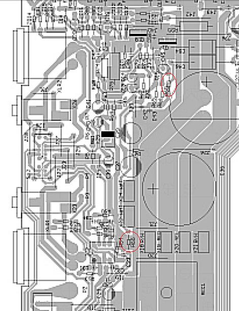

I did manage to find another burnt part while looking around tho. :hot:
Looks like I may be needing a new tank cap!
Hi Jan, You could be correct. There are two resistors (parallel) feeding the shunt zeners, but I can't see how you could get that sort of current to flow. I would change the I/C, both zeners, and the caps on both those rails and check those four feed resistors.

Oh dear, Think you're going to need a clearer circuit, the big caps probably O.K. looks like outer sleeve got burned from whatever went up. Clean it all up first before you do anymore. It all looks to be in the same "department" . If you can come up with a better circuit and the reference numbers for the blown bits you might be in with a chance, it all looks fairly straight forward circuit wise.
I have some 10000uf caps I can use for testing, but they are way to big to fit in as they are like coke cans...
I'll have a cup of tea and I'll make a start clearing it up, I'll post a higher res of the original burnt part:
I guess a zener would make more sense, I really wish I could find some high res shots of a unburnt amp...
The other burnt thing looks very similar, I guess they both could have got overloaded by something?
