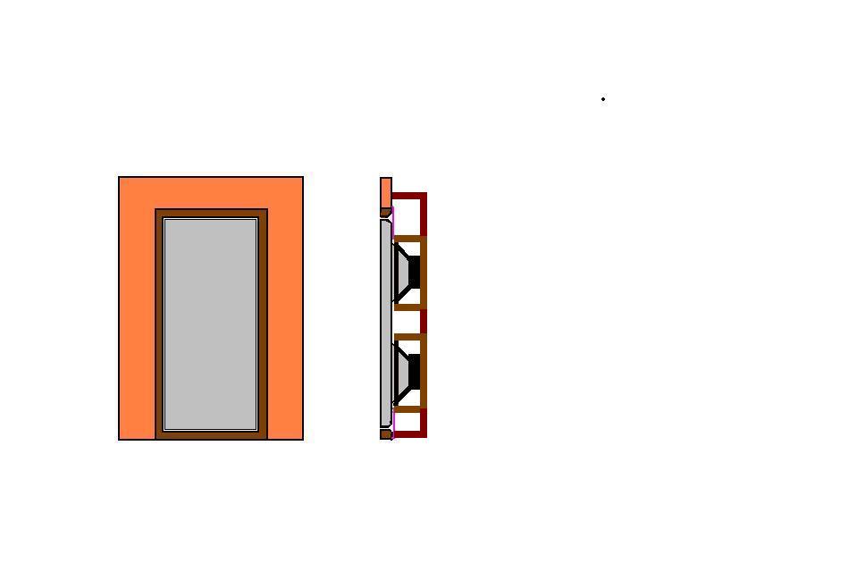

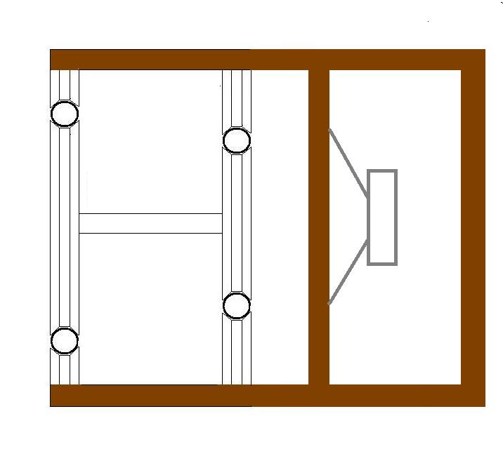

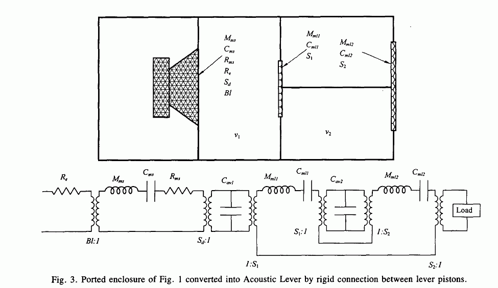

Can you give some insight into practical Acoustic Lever (AL)? It is meant to be an alternative to bass horn. Speak software that simulates such enclosure doesn't work with non-US Windows and even then it does not load databases and projects with AL so it's useless.
How should we calculate those three volumes, compliances and masses?
What is known driven diaphragm should be slightly smaller then driver and radiating slightly bigger. Maximum ratio 2:1. I'm most interested in rear AL so that we extend bandwidth rather than gain efficiency.

Fundamentally, it is a transformer, so it should function similar to the bass horn.

From what I can see, the device above appears to operate in a similar fashion to how a contemporary automotive hydraulic brake system works. The trade-off is excursion at the input for increased force at the output. An interesting concept, perhaps its goal is to better couple the driver's cone to the air-filled universe. A sort of mechanical impedance matching.
I would wonder at the mechanical losses imposed by such a system? That schematic, which I think is supposed to be the equivalent circuit expressed in electrical terms, is missing some resistors!

Earl,
It really looks to me to be a mass/spring resonator coupled to the driver by another spring. The electrical analog makes it look more complex that I think it really is. Ignoring the air spring behind the driver, the double disk is a mass, the air in the double disk chamber is a spring, and the air in the chamber between the small disk and the driver the coupling spring.
It would not work (very well) with an incompressible fluid though. An incompressible fluid in the coupling chamber would rigidly couple the driver and small disk on the compression stroke, on the expansion stroke there would be the possibility of cavitation or rigid coupling, depending on how fast the driver pulled back. Additionally, the small and large disks must move in unison but since they have different areas the swept volume of each is different. This would attempt to compress or expand the incompressible fluid and that indicates that the disks won't move. They could move on the expansion cycle but again, that would lead to cavitation, or sucking a vacuum.
I understand why you call it an acoustic level, but it looks to me like a PR with an additional compliance element coupling the PR to ground.

Hi John
I agree about the fluid coupling, I didn't think that through, yes, without a compliant coupling there is no chance for a resonance and the associated gain. The coupling does have to be compressible.
But I don't agree with your assesment about it being simply a passive radiator. When you simplify the circuit, it comes out to being a simple transformer with a turns ratio equal to the quotient of the two areas of the level. Since transducers tend to be poor impedance matchs to air - especially at low frequencies - there is gain to be had from this transformer. Many people who casually look at this circuit conclude that there is not much to be gained, but we dispelled that rumor. We did a fairly complete study of the level in an actual sound system in a car and found that the claims made about its incresed efficiency were completely correct. This was published as an SAE paper not an AES paper and so it was not widely seen.
Of note is that a horn, in the end, also looks like a transformer when simplified. But the horn has the turns ratio equal to the square root of the area ratios, while the lever is simply the ratio. This makes, in the most simplified cases, the lever and the horn comparable in efect, but the lever is more efficient because of the linear versus the square root ratio. In terms of gain for a given volume of enclosure the lever is much more effective than a horn. Why don;t we see them? No one makes a lever and they would not be easy to build (by a DIYer that is).
The downside of the lever, as I said above, is bandwidth. You simply cannot get gain AND bandwidth at the same time. The horn has a bandwidth advantage, but the lever has an efficiency advantage.

It is and it isn't. In a lever, the volume velocity of the output is greater than the volume velocity of the input. With a passive radiator it is one to one.

Who cares about "delay time" in a sub. Yes, the system is "like" a PR bandpass, and yes the gain comes at the bandpass passband.
You can also port the back (this is covered in the patent) which adds a little, but makes a LF dipole.
