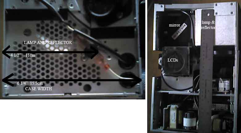

Well I bought an old boxlight projector that uses a 250 watt MH lamp (from what I've been able to find out), maybe if I can figure out what part of the innards is the ballast I could use that, One of the lcds seems to be shot so unless I can find the same model cheap with working lcds it's just taking up room. The wiring is pretty simple since it was built around a pc case format and there seem to be only a few that carry much juice. It also seems to have lots of UV and IR protection I could use as well. This way I could at least get my $35 worth out of it.

if the lamp was relativly small form factor could you not use this? eg, attempt to use the entire light box ..
No cos they are DC rated and they wont carry the same voltage or amperage as the AC rated lamps we use. If you did mannage to get it going it will also take the life out of your lamp as it will burn the cathade electrode out.

I have a feeling that I wasn't very clear about what I was planning. The idea is to use the entire "light engine" from this projector including the lamp & reflector. Just mount it and all the cards in a larger case (with the cards out of the light path of course). I know from messing around with it that the lamp will function without the LCDs, TV tuner/composite input card and the VGA in/out card. Just use it as a light source. Since the fl of the condensor, fresnels and objective are longer and the LCD is larger I will need a much larger case anyway,(even using mirrors).
Here'e what I'm looking at:
It still wont work because the light in these things are condensed and they are made to illuminate 1.8" lcd's only. They are custom made to be this way and it goes right back to the reflector.
If its got an elliptical reflector no problem, but if its a parabollic (in most cases) you wont have a chance.
