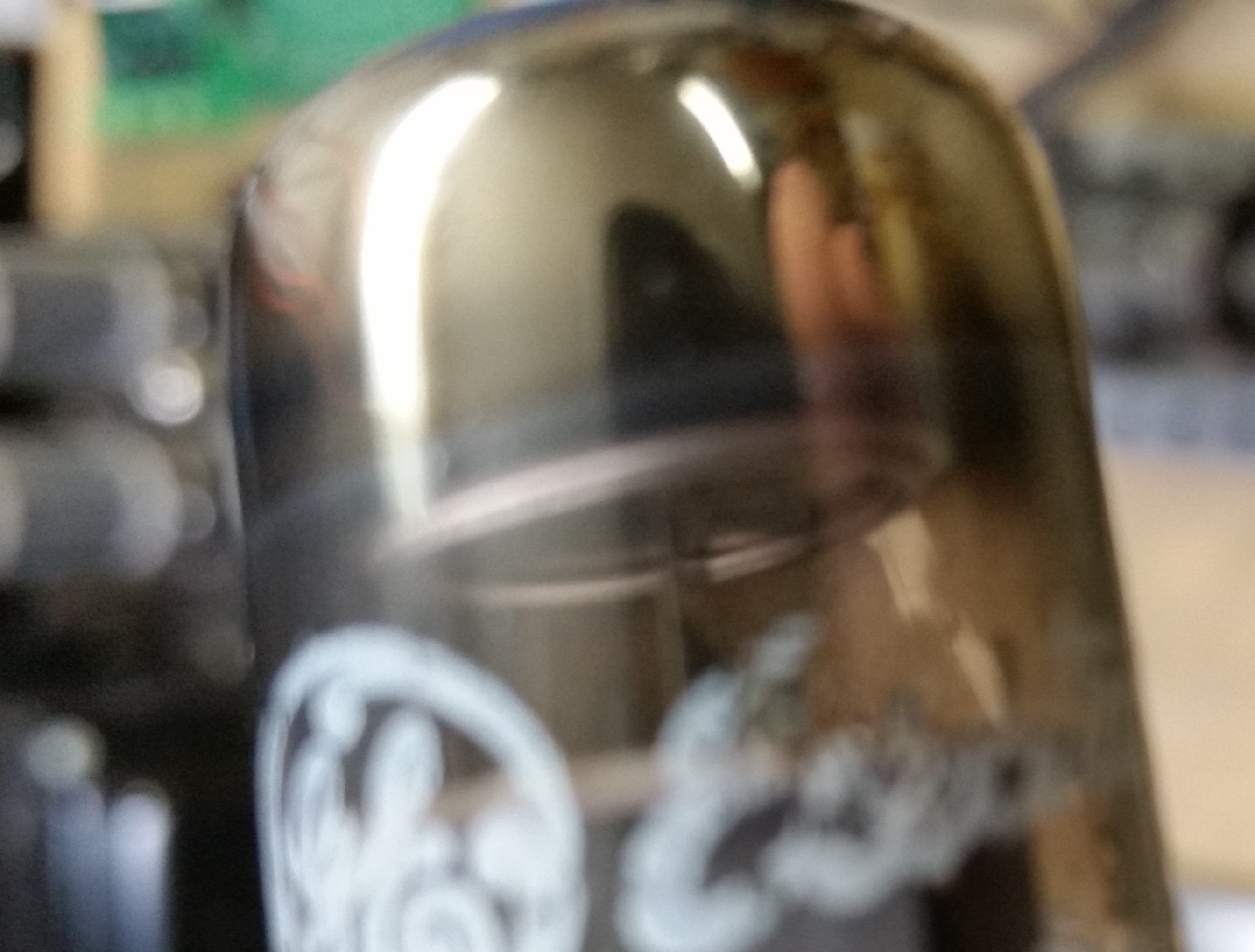

A number on each tube the tube says 188-5 in white letters. Above that there exists the letters NR in a larger font. In cursive in white letters there are the words "electronic tube" along with the GE logo and tube type.
In grey, its also says the tube type with U.S.A. printed below it. Below that there are four grey dots.

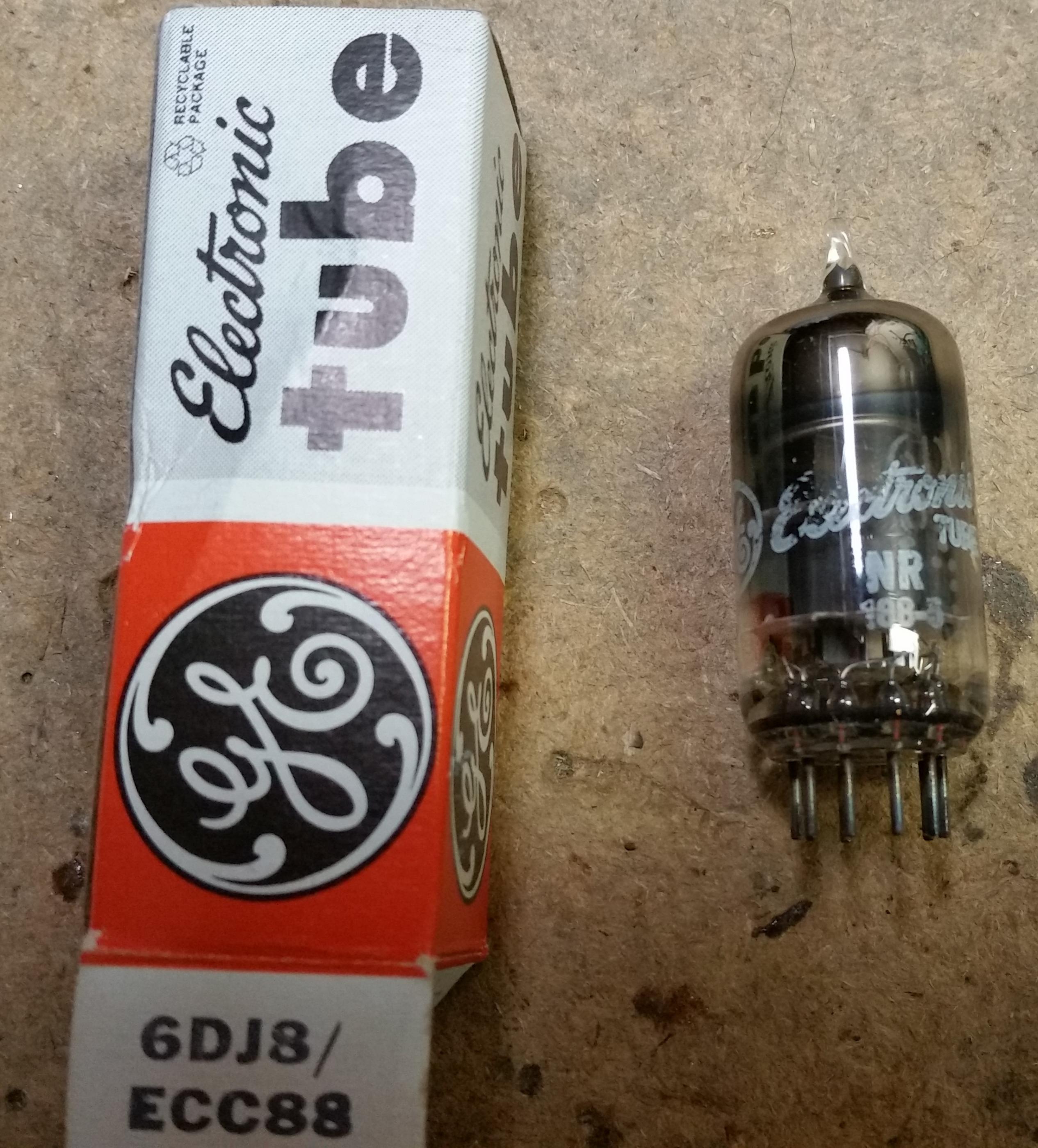

Here is an image of the tube and box (see attached). The second one is identical.
I see the ubiquitous GE etched number and dots in this picture. That would indicate a US made tube. When GE sourced tubes from other vendors they would be print labeled but won't have the dots and number etched in the glass.
Then how did the bottle get the typical GE etched dots and tube number? IMHO the printing on the ink is not a good indicator of much. The dots/etching would be quite hard to "fake"; the printing not so much.
If it was a Philips valve then it would probably have glass seams on top and almost certainly have a Philips factory code near the base.
On reflection, the pin seals are not the bright red often seen on Russian valves so all the evidence so far points to manufacture in or for the US.

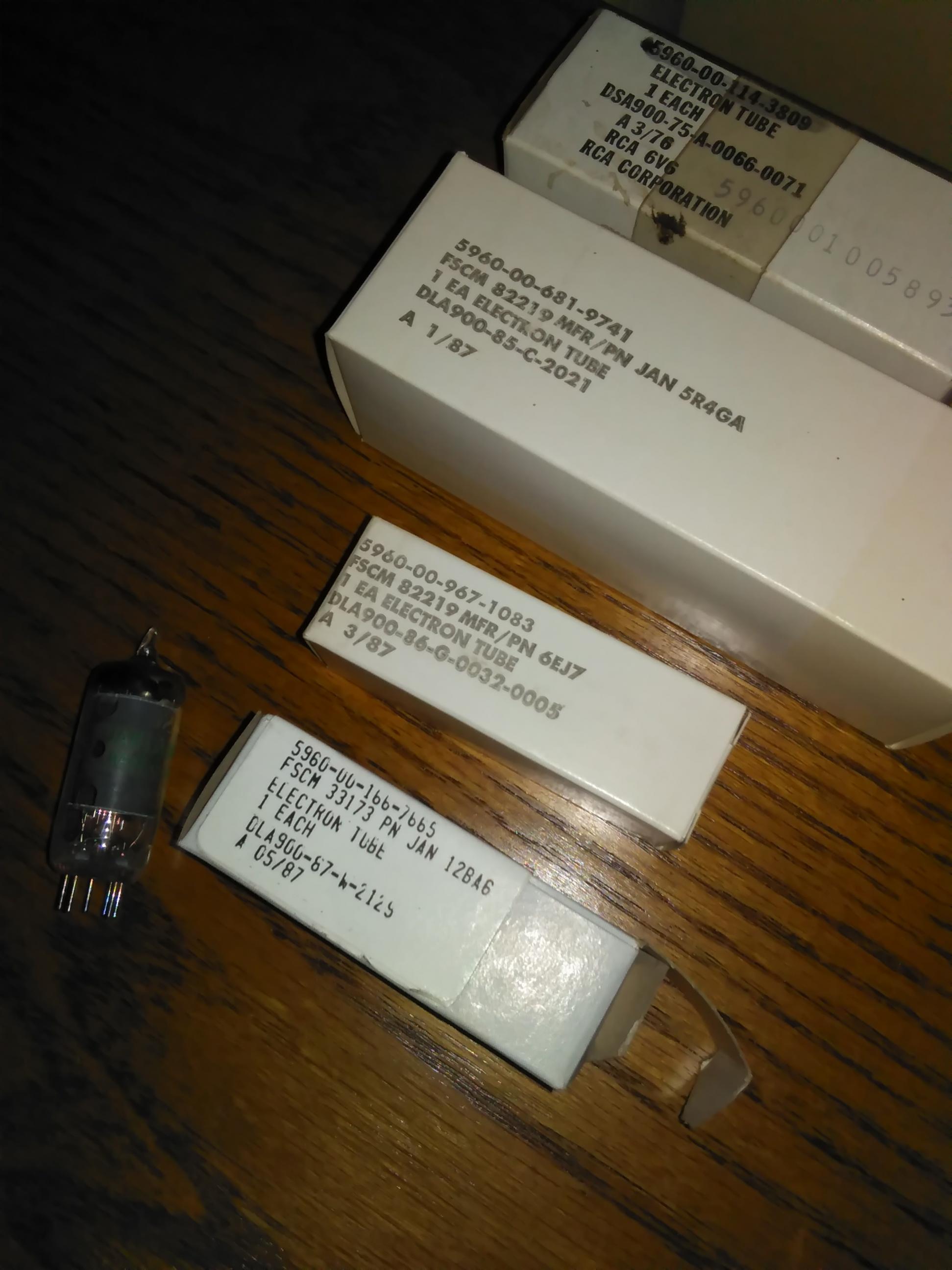

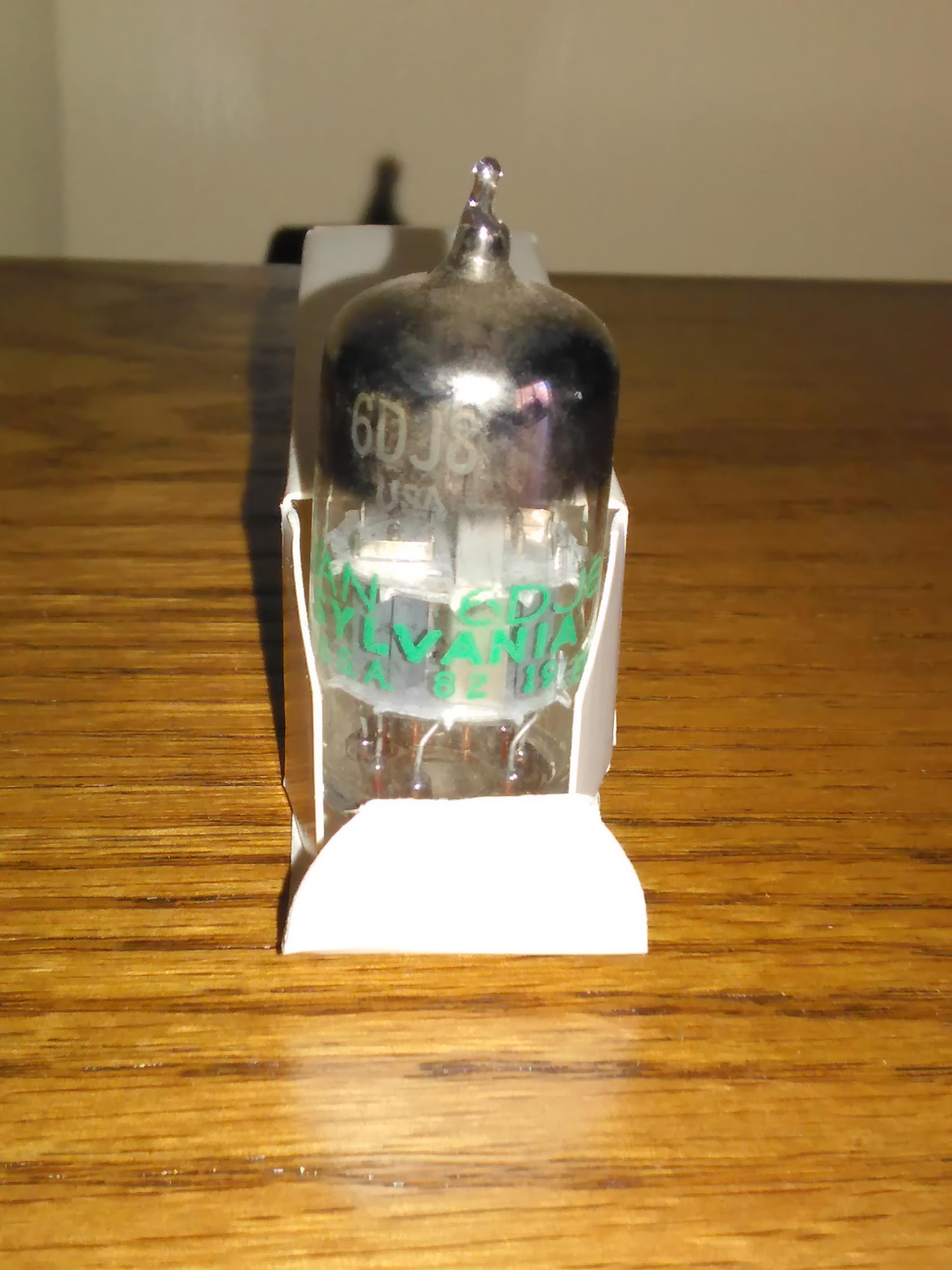

The tube in question looks like an ordinary late 70's GE 6DJ8 to me. I don't keep a lot of tubes here at the office, but I've attached a poor pic of an '82 JAN Sylvania 6DJ8. The tube in the OP pic is not a Sylvania.
I have not seen a genuine RCA receiving tube manufactured after 1976. After that date, the receiving tubes were mostly Sylvania manufacture, some GE.
GE and Sylvania ( or Philips/ECG - whatever you want to call them ) were cranking out JAN tubes well into the late 1980's.
As I said, I don't keep a lot of tubes here at my office, but I easily located a last year RCA 6V6 from 1976, a couple of Philips JAN tubes from '87, and a GE JAN 12BA6 from '87.

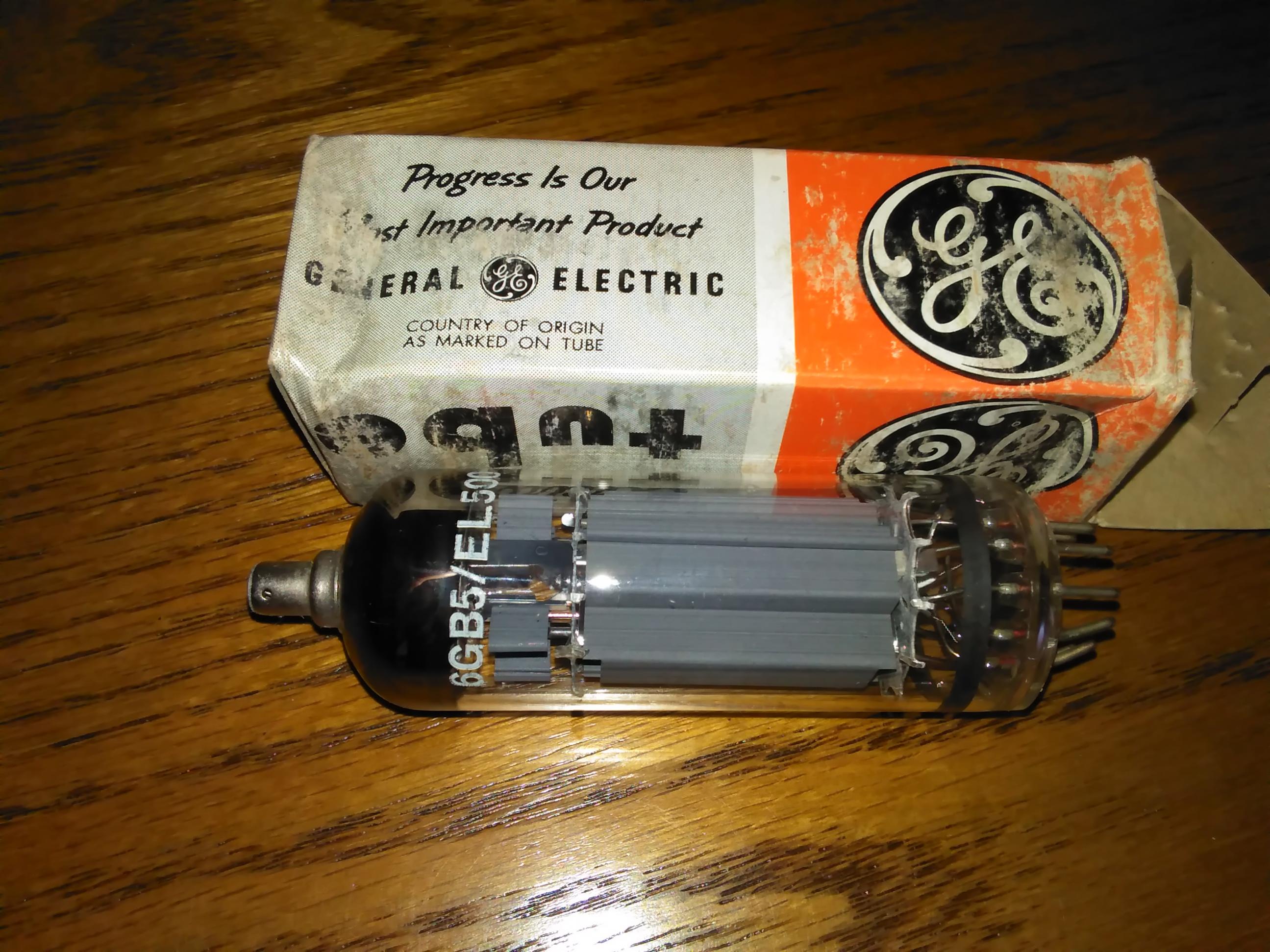

Foreign manufacture consumer grade tubes marketed by GE had slightly different boxes: "country of origin as marked on tube", or something like that.
Like this 6GB5:

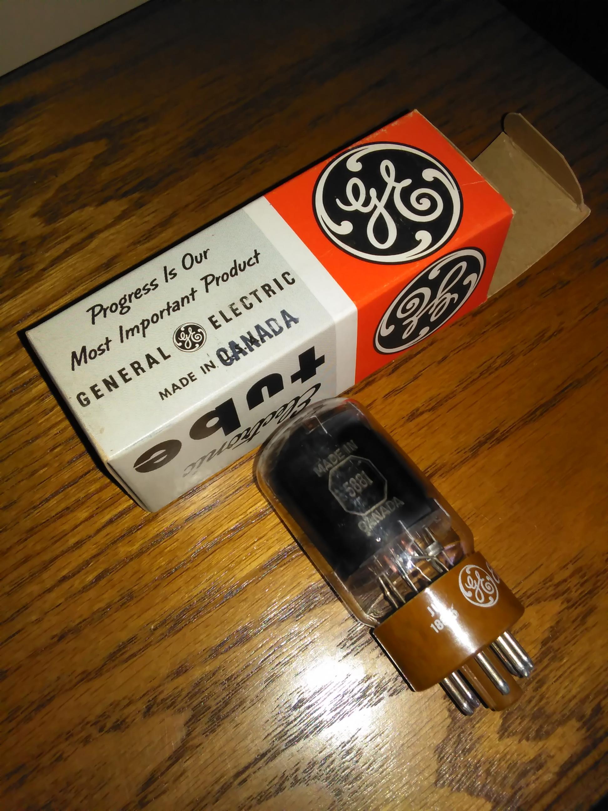

edit: or the actual country of origin, as with this 5881. Note the absence of the laser etched dots.
