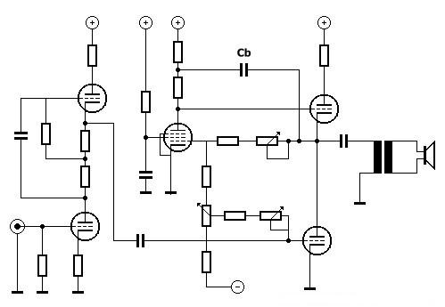

I'm in the process of building a tube amplifier for 35W per CH based on a little known distortion cancelling technique. I've managed to get 0.04% distortion at almost full power with no global feedback using a SEPP circuit with C-core output transformer. Hope to have it good enougth to post a pic very soon and it sounds real nice to me...but I'm no audiophile-just a crackpot engineer.

The amp uses a sort of a differential circuit around the output stage which cancells out distortion components produced in the output stage. I use two EL509's in each channel (trying to find EL509-2's) and a 12AX7 SEPP input stage. The only downside of this type of circuit is the elevated heaters for the top tubes, and adjustments for bias current, output voltage bias, and distortion cancellation.
Using the distortion cancellation it's possible to dial up the distortion you want from about 0.04 - 0.5% or higher but I haven't done any listening tests with this yet.
It's a very clean sounding amp with low distortion and OK damping factor of about 6 or so. If I use about 6dB of overall feedback the specs improve further but I dont like the sound as much. (except for piano which for some reason i like better with the global feedback)
I'm using some Legend speakers from canberra which seem to match the amp very nicely.
As I said I'm no audiophile and probably wouldn't hear many of the things others can. But to me it's a sweet amp with just a hint of that valve character.

I've attached a basic cct of the amp which I hope will come out here OK. It dates from 1960 so is about the time totem pole transistor outouts were around. You can see the likeness.

Gidday Phil. The attachment must have fallen off... give it another go.
