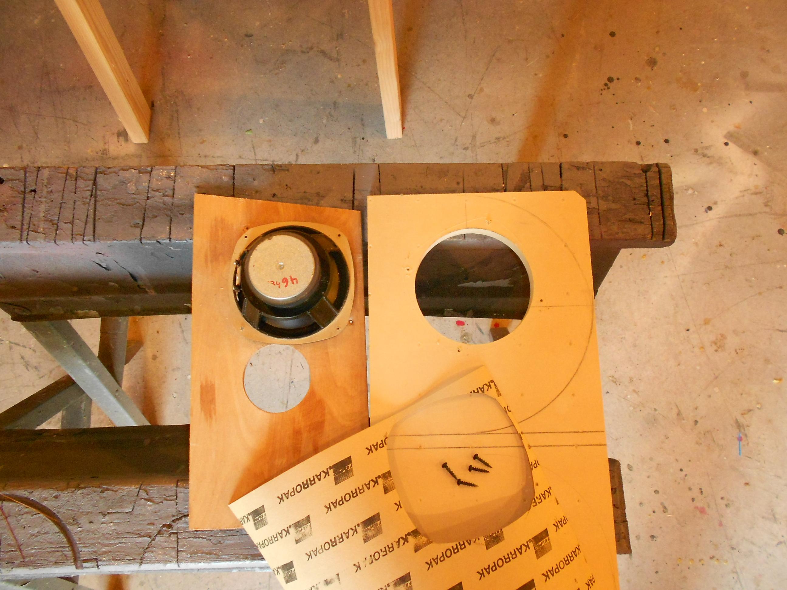

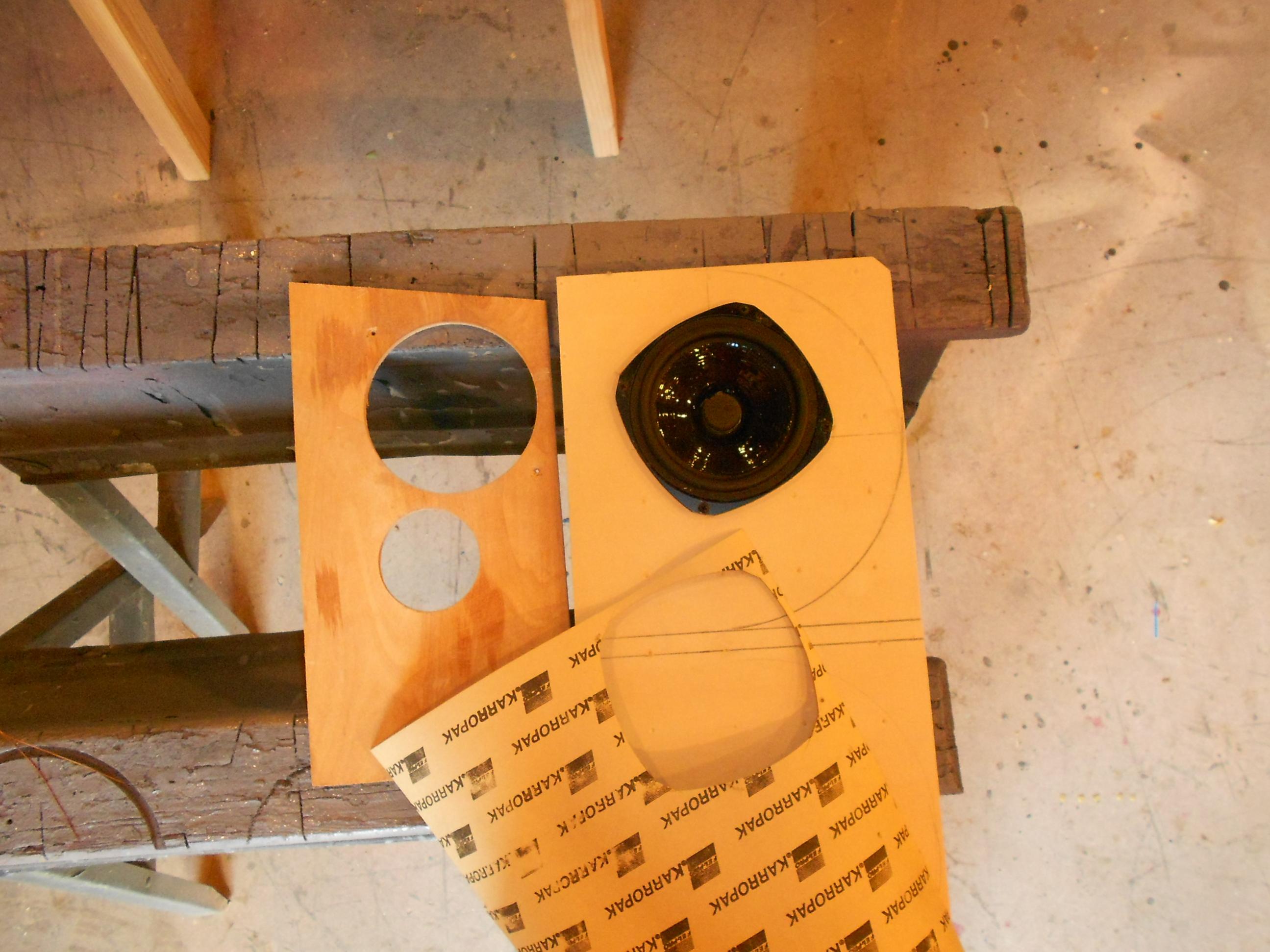

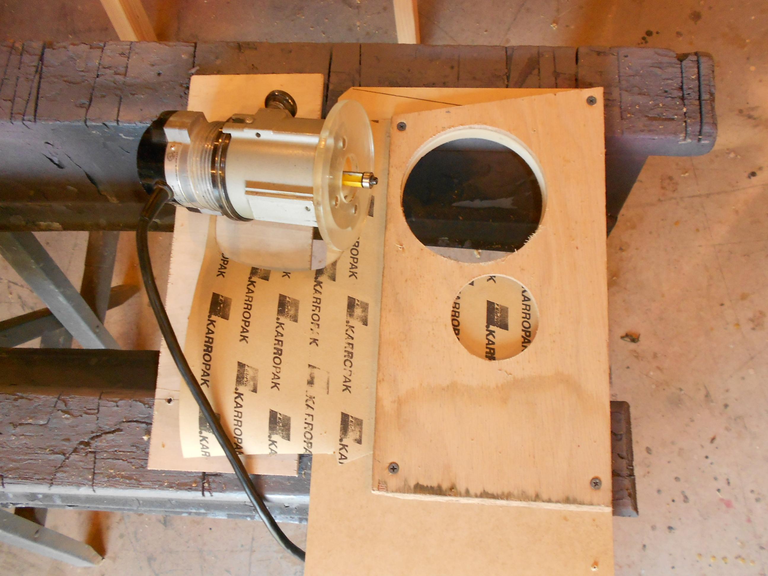

Not that this is mind boggling but wish I had done this years ago. I have have been using rope-caulk to set drivers for a long time; works great until its time to take the drivers back out (pulls the wood out).
First cut the exact hole in scrap wood; then sandwiched gasket material in two other scrap pieces and re-cut. Next step flip woofer over and screw down, cut around driver with care.
Gasket material is easy to fine at auto parts and ebay.

I agree, however this worked nicely because the woofer is cast. The perfect fit is nice also.
The idea here was to sandwich the material in two pieces of scrap so you can use typ wood cutting tools.
