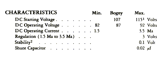

kevinkr said:
I have not been able to find any discussions pertaining to their ac small signal behavior. (Analog to dynamic impedance in a zener for example.)
I have - first page of the datasheet.
Regulation is specified as 3V for an anode current variation of 1.5mA to 3.5mA.
That gives 3/2mA = 1500 ohms.
Edit: oops, scrap that. Im just read your OP again.
Re: Re: Gas Reference Tube (5651/85A1/etc) Internal Impedance
Pretty much the only way to know the answer to my original question is to do an actual measurement which I was not equipped to do. (Since the manufacturer did not think to provide this information in the data sheet.) Gary graciously did the experiment and confirmed my empirical observations with hard data. Extremely useful for those of us who use the 5651 as a reference in the cathode of a cascode error amplifier where it degenerates the gain of the amplifier as a function of its internal impedance. (This unfortunately isn't a benefit, but something one needs to design around.)
Comparable voltage zeners incidentally can be an order of magnitude better in this regard, but generally have much stronger temperature coefficients and no pretty glow except when they burn up.. :devilr:
